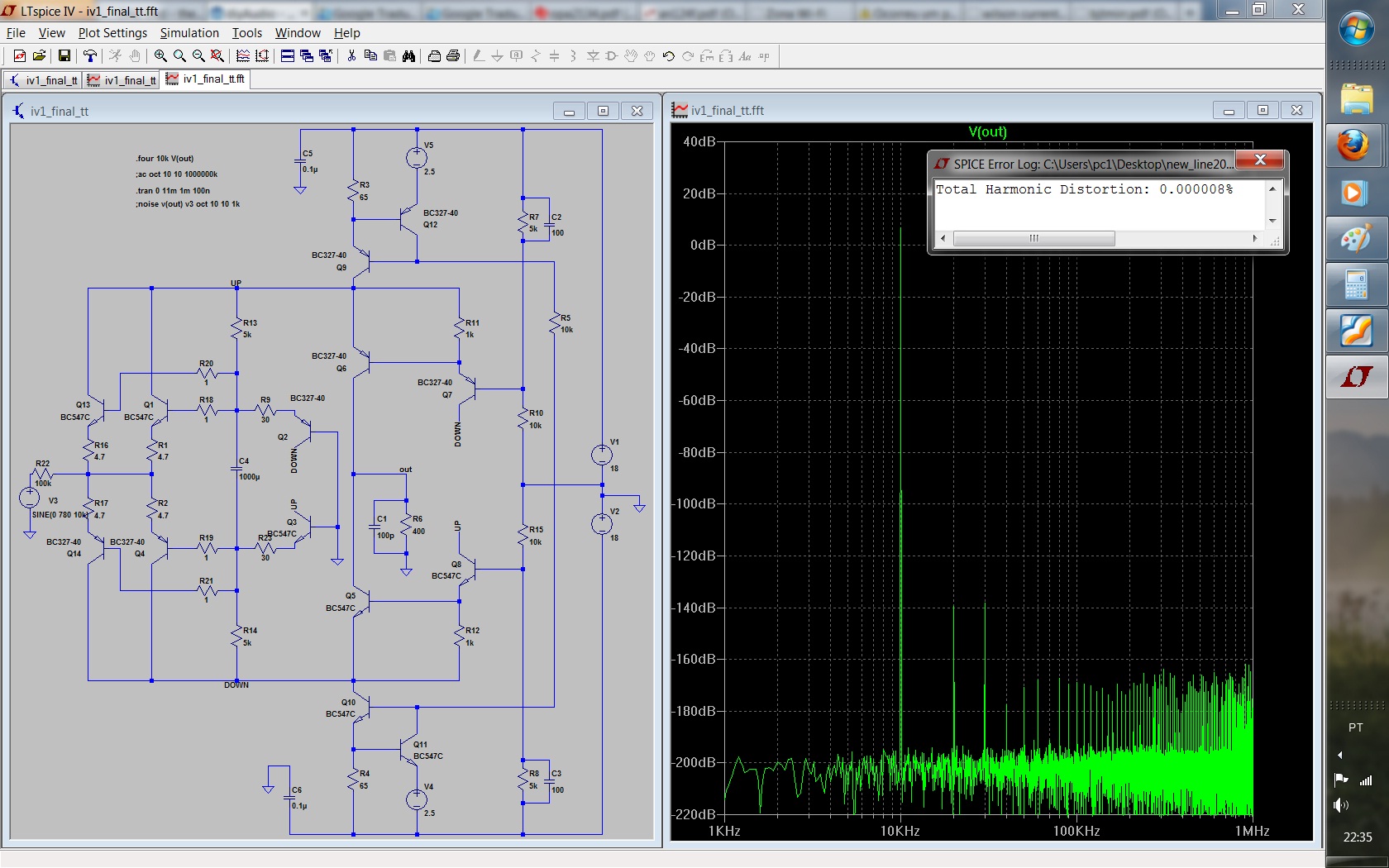

As the doubt about the need of matched transistors appears very often, i post here the same circuit with bc327 for pnp and bc547c for all npn, they are very different and the thd is 0.000008% (7,8ma/100k), its no need for matched transistors. hope this end the subject, and we can move on.
Sorry about the doubt, soured by years of unimppressive results with open-loop BJT I/V's. It really looks like you have conquered the BJT I/V compromises many of us have been dealing with for years. Thanyou for sharing, please keep us updated as you build it and don't lose patience with our paranoria ;). Do you plan on a breadboard first or starting with PCB's ?

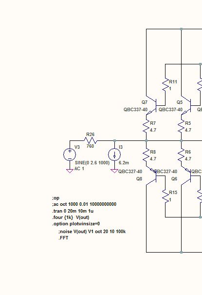

Hi Zinsula,
i was told that the output impedance of the pcm1794 is 2M with 22pf, try to find in internet for the real value, but no luck :(.
this circuit was design with that in mind, with a source of 1k the distortion is a lot worse (0.008%). but i have made some changes in the input and got 0.000064% thd with 1k input impedance see circuit below
how do you come to 1k :confused:, i think is very low for a current source, if someone knows the real value please post.
Dug thru my notes and the PCM1794 has an output impedance of 670. which is in line with other high current output S-D DAC's.
The 2M number is way way off any current DAC ever made.
So the best way to spice the PCM1794 would be a current source with app 700 ohm to GND..?? If this is the case, then input impedance really starts to matter.. The voltage source with serial impedance seem just too ideal to match real-world conditions
Textbook current source output impedance is with the output impedance in parallel (to ground on the simulator) but a DAC chip current source doesn't "originate from ground").
Best I've found that models reality is voltage source with series reg. In this case the voltage source would be 3.4pk *780 = 2.625V + 780 series resistance giving a 3.4maPk current sine wave.
Its impossible to model what really comes out of a current output DAC as they aren't square wave but dang close.
So you see that current output DAC chips really aren't current sources unless considered in relation to a opamp I/V' input impedance (virtual ground). Its all relative when defining a current source vs a voltage source, and further shows that modern DAC's are designed specifically for opamp I/V. Most current out DAC's you buy these days are just v-out designs with the internal opamp moved external to allow better specs.

Would the offset then be modeled at a separate current source in parallel or simply as a voltage offset on the generator..??
Add a current source to model after the resistor for the offset. Be careful not all DAC's define thier offset the same. Some the offset current is + others - direction, I think the TI's are an oddball, I know the TDA1541 swinggs from 0 to -4mA (-2mA offset) but I think the TI PCM17xx are a positive offset , with S-D dac's it usually works out that they like to see 1/2 their single supply voltage on their output. So a DAC that runs off a +5V rail wants 2.5V DC at the i-out, and a 3.3V rail DAC wants 1.65V. Since PCM17xx run off +5V, you will know you have the right offset current when simulation shows 2.5V at the input to the I/V.

Regal,
What is the source of that 670R figure? I'm not disputing it, it's just that the output impedance of the PCM179X series has been shrouded in mystery because T.I. hasn't seen fit to document it in their datasheets. By the way, the number I've seen reported (unofficially and indirectly) is 100k, supposedly from T.I. engineers in Germany.
I tried modeling just the front end (common base portion) of your circuit and I'm getting way too much gain. It's something like 100dB. Of course, I removed the emitter degeneration resistors, and the base stopper resistors as well. Hum ho.
Ideally, voltage gain would be much higher, increasing as the virtual ground impedance of the grounded-base stage input is reduced. But what matters here is current flow. The circuit conveys DAC output current to the 400R I/V resistor, while isolating the DAC output from the voltage swing developed across the I/V resistor.
