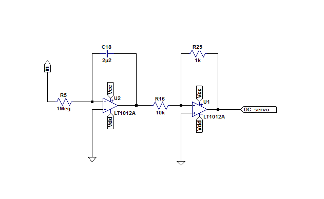

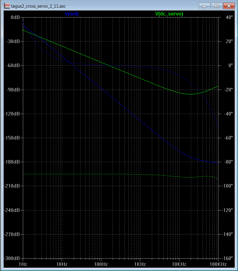

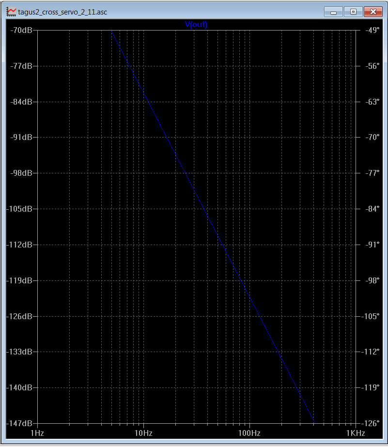

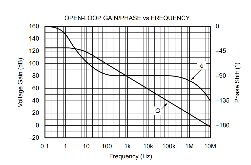

Regal, If I understand what you are telling , you say that if a opamp has 110 DB of open loop gain for example , the filter should have at least 110db of attenuation at audio frequencies ? I will investigate this. I will see if I have time to simulate the frequency response of the servo.
I have made some simulations to see the frequency response of the servo, and some alterations to prevent the servo from having feedback at audio frequencies.
The first image is the open loop of opa2134 , the second is the FR before the modifications, third is FR with modifications, the last is the modifications in R25 and C18.
with the modification the servo does not have excess gain to have feedback above 40hz , if we decrease R25 to 200ohms this value decrease to 20hz.
in second image in green there is th FR of the servo with only one pole, in this way the servo has excess gain to have feedback until 1000 Hz , with two pole servo this value is much lower (blue).

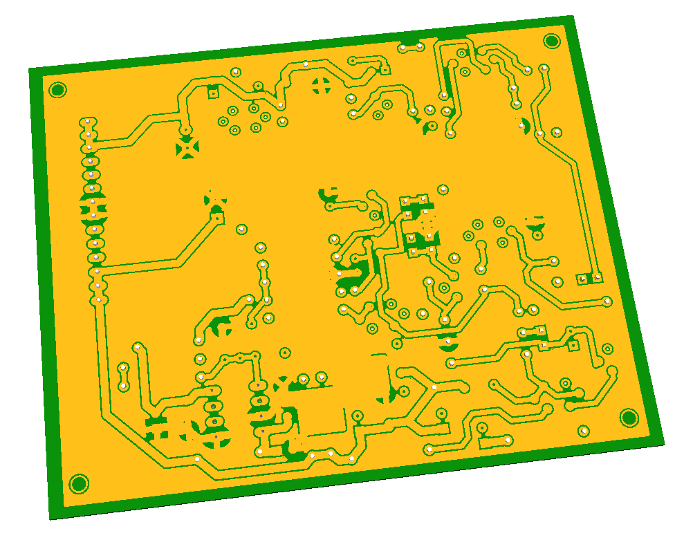

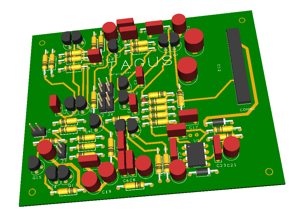

3D images of the board , but i have to do some modifications , change some traces from bottom to top to have a wider ground superficie in bottom, and add some connectors to input output and power, hope i have time this night to finish it.

smms,
It seems you can route more wires on components side, not to devide ground plane.
the circuit conveys input current to output, and the current flows to ground through the IV resistor and paralleled capacitor, so it may be some benefit to separate ground return pass and ground plane.
Yes Shinja, I have already changed some traces to the top side as i said in post #692.
I have take attention to the ground currents paths and the inductance of ground , important is to get the currents of the rail capacitors away from the path of the signal, there is no need to separate the ground.
Im not that good to express myself, especially in English :)
I will separate the ground return of the rail capacitors from the rest of the ground .
This weekend will be the audioshow in Lisbon so I will not have much time left , but I hope next week to have 2 prototype board made.l am very curious to listening the final results of all of this.
