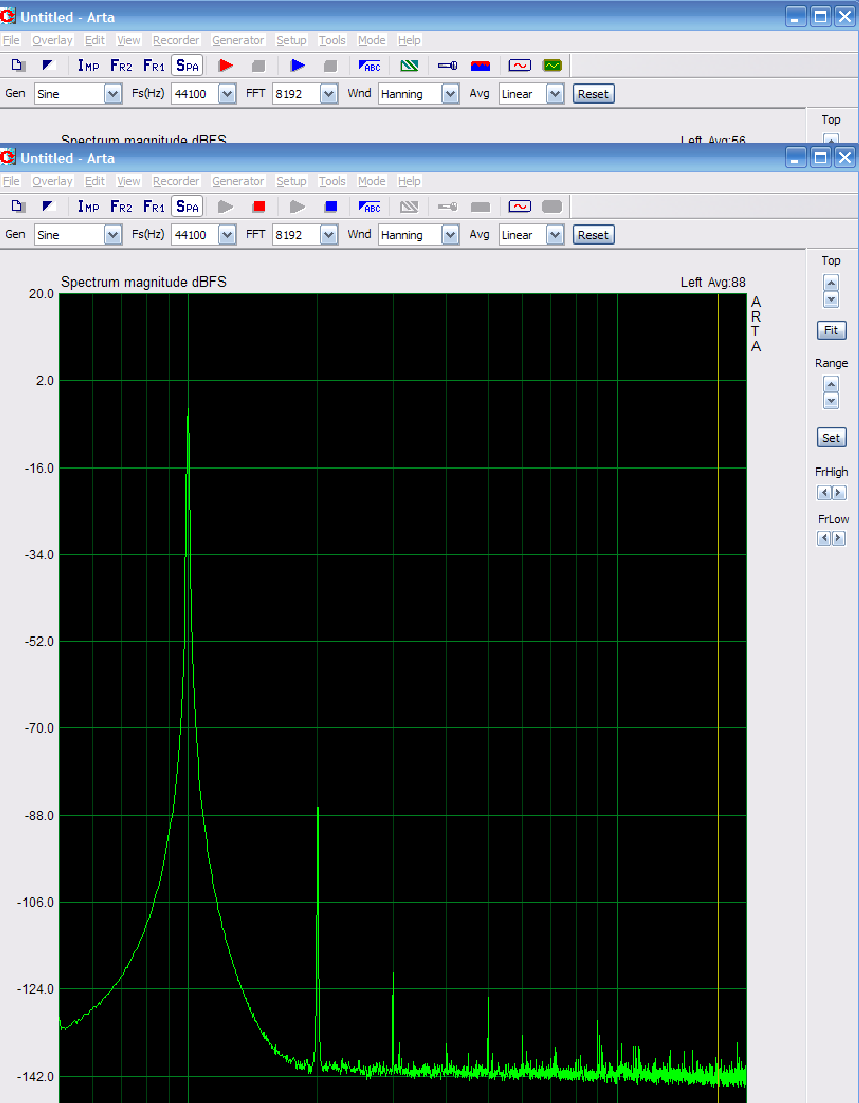

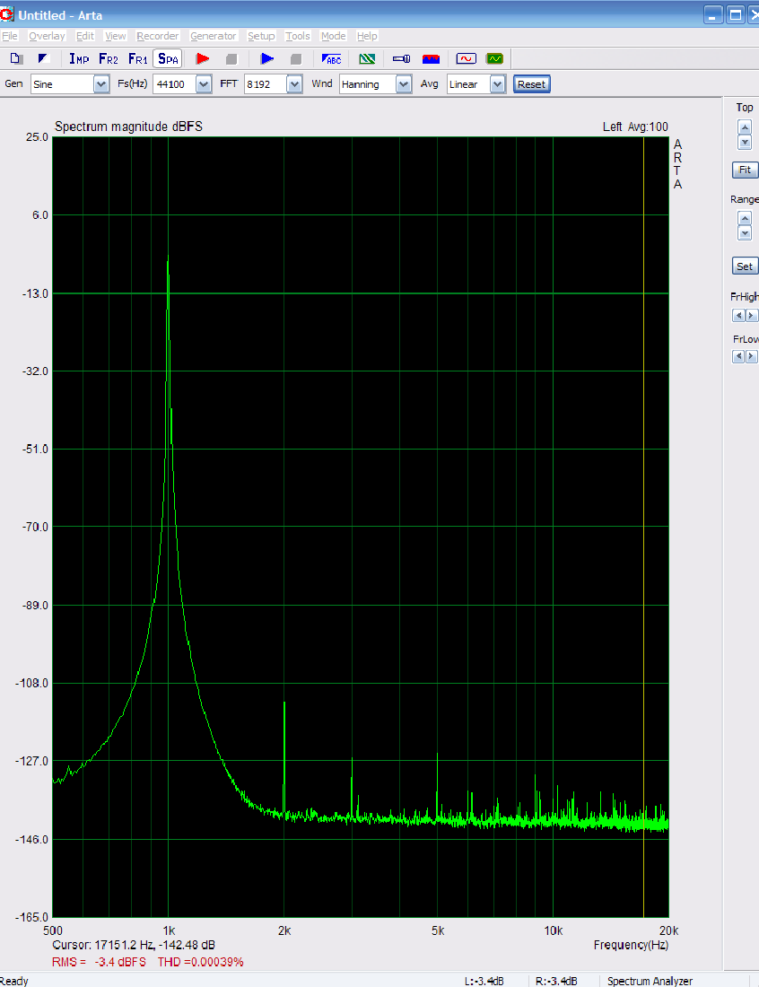

Just for curiosity this is images of distortion of a buffer that i going to use in other project that i am working, it uses a mosfet BS170 and the objective is create 2º harmonic distortion, first is with 10k load and second is with 1k , the output voltage is 1,25v rms. As you see only 2º harmonic is created.
This is real measurements not simulations.

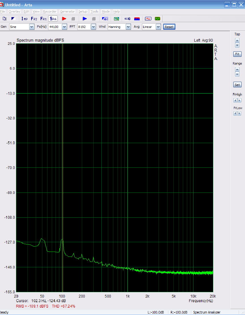

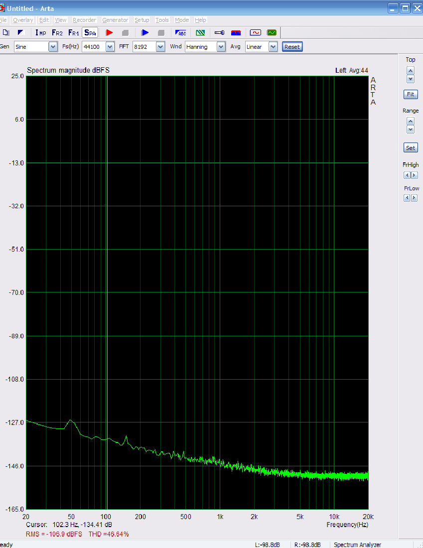

Yesterday I have been working in the power supply for this circuit.
First is the power supply based on 7915/7815, second is the modifications at the power supply, as you can see the noise and ripple is extremly low, and almost the noise floor of the EMU1212m.
One tip: Use ferrite beads in your power supply, there are some high frequency spikes that only ferrite beads can supress.
first 7915 , second positive w/mod, last negative w/mod.
measurements made in the power rails , with 40ma load.

Very interesting measurement you did about THD vs load! Might be that yuur bufferis leaving class A, and that is why THD increases so much at 600 Ohms load?

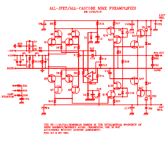

If you would connect the caps across the Zener diodes in the buffer with teh Zeners to the output, the Zener noise would go to the music, right?
Better to send the noise to the rails.
Like Erno Borbely for ex is doing in the mic amp design below.
staccatiss, in the buffers that you present in post#649 the capacitors should be parallel with the zeners not with the ccs, .

If you put large caps like that , the noise from the power supply go directly to your output . And the worst is that it will short the output at A.C.
The capacitors in the schematic of E.g. Borbely are for shore small caps for stability and not for noise steering.

Just by looking to the fft graph you can see that the buffer is in class a , class b produce lots of high order harmonics.

In post #662 I only post the noise of a power supply based on 7915/7815 for comparation i will not use that power supply .
The noise measurements from the power supply that I am going to use are the second and third images , the noise is really very low (I was surprised by such a low noise)
basically is the same as the emu1212m .
Or as you say a super low noise PS.
Edit: I use this type of power supply for a long time but this was the first time I test them. I will post a schematic of it , when I have finish all the alterations that I want to do.

BTW, the caps are correct across the constant current diodes and the caps are not for stability.

The 0 dbfs of emu1212m is 2 Vrms so looking at the graphic we see the hight noise is at 20Hz is -127 db and that is 950nV rms, at 1Khz is 120nV rms.
