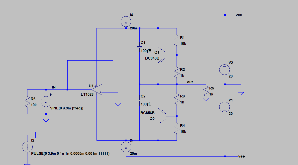

dac I/V convertion with very low distortion
the opamp in the opamp cen? circuit is working in floating supply ,but the noninverting input is tied to GND.
so it is almost equivalent to working in grounded supply ,and inputted IV converted signal voltage.
therefore, the opamp is requied same property of ordinary IV opamp , high slewrate and short settling time.
additionally, small base current at input stage.(base bias current and current through Cob)
it may be fun to replace input stage of smms73's circuit with opamp.

Hence JFET input opamp, such as OPA1641
yes I think it is good choice too.
OPA627 may be good why its input stage is bootstrapped.
I think this affects more the IV input (opamp output) voltage variations than the current conveyed.
As long as +Vin is not leaking current to Gnd, Kirchoff's law takes care of the rest at the output (R_iv).
but the output node of DAC should be stably regulated at 0V.
the voltage will be V/I converted with the Zout of DAC and conveyed to output.
this may affect especially pcm1704(Rout is 1kΩ) and so on.
this is why I planned to include the base common amp in the feedback loop, at first.

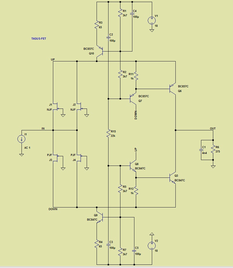

TAGUS-FET
This is special for Patrick. all JFET input.

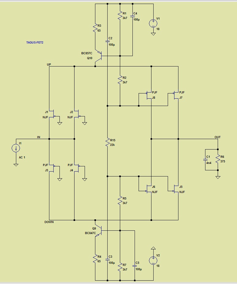

with jfet we can simplify the circuit. But i dont have sk170/sj74 spice models. Can someone post them ?
This may perform better that the cen circuit as there is no voltage variation at the JFET´s, and don´t need a battery.
I dont have much experience with jfet and i have one question, if the gate voltage get's positive the gate current increase or in this type of jfet this is not a problem?

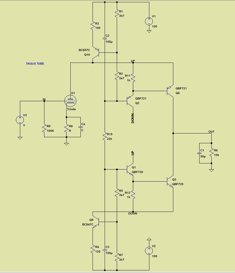

And this was the original circuit (or close )... very long time ago.
I was using tubes and no feedback at that time.
This was the input and voltage amplifier of a hibrid power amplifier the output was a triple with Transistors, this was not constructed.
Is a very good driver for a triode single end with that low gain valves like 2A3, 300b, 6c33c etc...
edit: the triode was the ecc88 (6dj8)

A (self-biasing, a la Borbely) cascoded SEN (2SK170 cascoded with J111) or a cascoded CEN (2SK170/2SJ74 cascoded with J111 / J174) will protect the signal FET from Vds variations and has very very low distortion in itself. Simulated at -130dB, not measureable with an AP1.
The circuit is post=286 is cleverly "cheating" :), as you basically create a floating supply with current sourced shunt reg. You might equally well use 2x TL431s. The current sources in the model are of course perfect, which will not be the case in rea life. And I do not like the idea that you create any extra path for the signal to flow back to ground (and not through the R_iv). How much that would be depends on the dynamic impedance of your current sources compared to the R_iv. And I bet it is not much more than 1000x (if e.g. you are using 2.4k R_iv, as I do).
