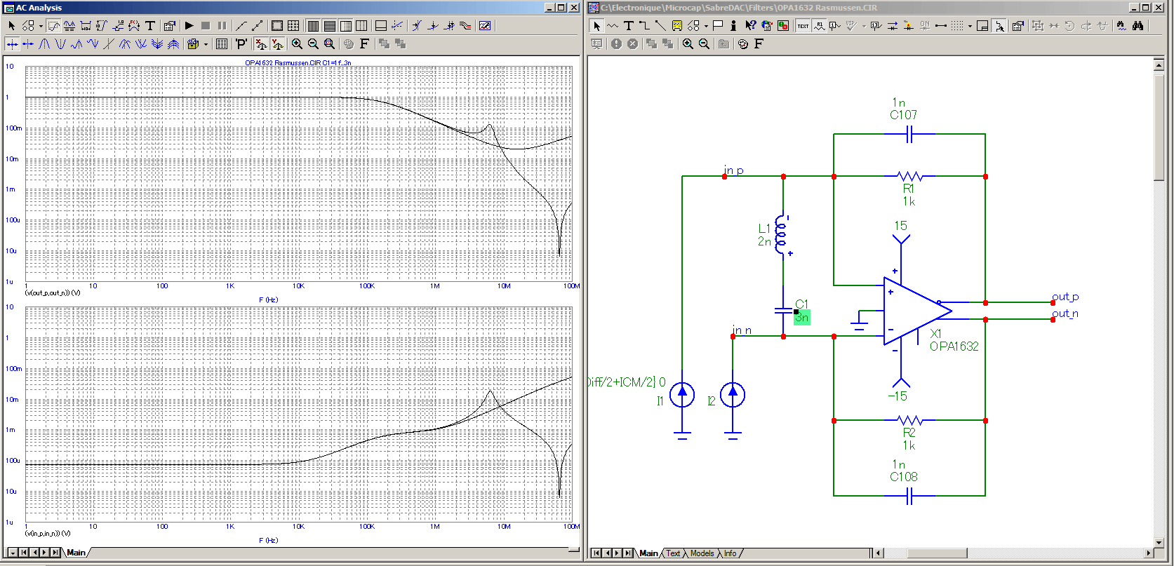

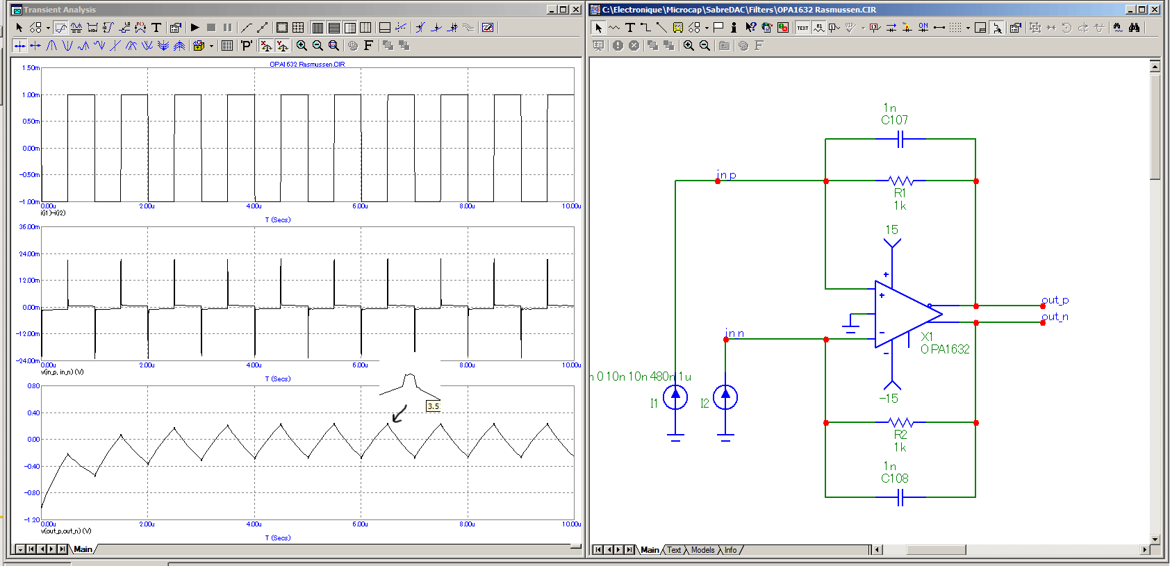

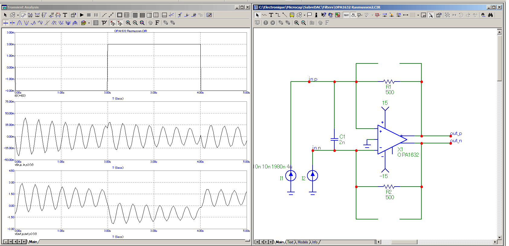

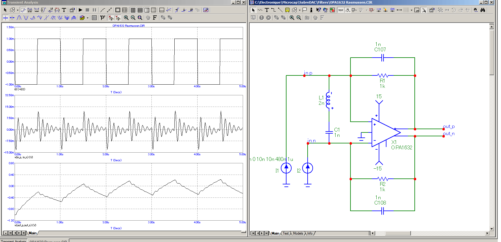

Now, about the HF noise. This noise is not a osculation from the opamp. Its shapes shows well that is the residual noise coming from the DAC, which is processed/amplified further by the opamps. It is this noise I refer and you may see it in the pictures. This noise is around 300Khz. Without these caps across the phases, this noise (the same shapes/characteristics) still exist in a non filtered DAC system, and is to be found on RCA outputs. In my case, this noise is few hundred mVpp (which I can reduced its amplitude without filters to few teens mVpp). With the caps soldered across the phases this same HF noise increase in level, as the caps increase in values, until a critical level. Then, the noise level increasing it happen abruptly degrading the useful audio signal. This HF moderate level (with the right cap in place) is for a 16Vpp useful signal in the same measured point. I can hardly see that this HF noise have an impact over the audio spectre signal so to alter the heard sound quality. BTW, as I said before, and Ken confirmed too when about his system, the quality of the sound outputted is much better without any "classical" filtering between I/V and final.
So, implementing this Rasmussen filtering, the very good quality of the sound outputted in my system, it become even better. There is not here about high and low frequencies in audio spectre which are to be heard better. There is a obvious improvement in the sound stage, the weight of the sound, dynamics, and so on. There is about details of a already high fidelity sound. There is like this in my perception, but how I could see, there are the similar improvements reported from others, using another types of DACs or systems set up. So it have to be something in this....

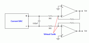

There is very simple to try this trick. Just solder a cap over the differential output of your DAC before I/V. You may start first with quite low capacity values. If you can hear some changes in the quality of the outputted signal, then you can experiment further increasing the caps value. Is not easier than this! And not any damage/danger for your system.
I'll certainly try to explore this. Looking at the DAC board, the component side is quite stuffed so this experiment will find a place at the bottom side.
Ugh... Considering the illustration given, the effect would be zero with a perfect I/V converter. Since nothing is perfect, it forms a differential single-pole filter with the parasitic resistance of the I/V converter. There's nothing magical about about it. Standard textbook stuff...

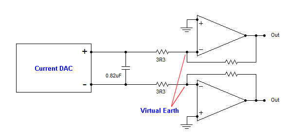

This filter is more 'dominant' in the sense that it does something that is not normally considered kosher, it will be measurably down at 20KHz, and that is new.
Filtering below 20KHz? Can you see why that has been resisted so far ???
In the case of a "voltage" out DAC, indeed what you call the parasitic output Z of a "voltage" DAC is low and it needs the R of the RC to be boosted. I would recommend something like 47R in series with each phase. Then the actual Z will be equal to the sum of the two values, one known and the other will be fairly low too. You could of course measure it.
Then adjust the 'differential' cap value to give you -1.3dB or slightly more @ 20KHz, and then take a listen. This may well be the sweet spot across a broad number of delta-sigma DACs (remains to be seen), adjust cap or even resistors within reason.
The cap value can be quite large, and in some case as high as 1uF. Not a common filter cap value I would think.
Again, this kind of 'dominant' filtering does not make the DAC sound rolled off. It does not make the DAC sound slower, unless you have over-cooked the cap value and need to back off.
Let me give you an example, with a value of .039uF and passive I/V set to 3R3 x 2, it was about 0.4dB down @ 20KHz and did little (and in fact may have been worse), but adding another 0.39uF in parallel (now 0.78uF in total) made the filtering really bite and brought it to -1.3dB - and it made quite a difference.
There will be further skepticism I know... but gradually, the more who do it, then the number of armchair critics will diminish.

I don't doubt that there is filtering. I just doubt that there is anything other than a simple first order low-pass here.
As for the comparison to a a voltage output DAC, it's not limited to a voltage output DAC. An I/V stage must have a low impedance not to violate the voltage compliance of the current source output DACs. It is that low impedance that is forming the R for the low-pass filter with your added C, not the impedance of the DAC.
Good quote from John Curl, but it doesn't apply here. One can examine without actually adding a capacitor. Examination can include mathematics and knowledge of electronics. That's the foundation of engineering. Not throwing caps around. I do not have to perform the experiment to reliably say that all you have is a single pole low-pass filter.
Furthermore, disagreeing about the claim that this is some sort of magic that transcends all that is known about electronic circuitry does not constitute the role of "arm chair critic." You're not likely to have anyone pay much attention to your argument when you dismiss all that disagree with such quips.
You should be aware that I'm not claiming there is not difference. I'm only claiming that it is nothing more than a low-pass filter. There is nothing magical about your capacitor placement. It works as a filter and you hear the results of that. As others have pointed out, it's not the best place for a capacitor as it increases the noise gain and worsens stability if the I/V converter is an op-amp. But, it does function as a filter.
Your example backs that up. You've illustrated a great example of the single pole filter I speak of. Draw the output of your DAC as a current source, draw the input resistance of the I/V, a little Norton and Thevenin, and you have a single pole low-pass. Now do you see how I can say this without modifying anything?
By the way... Thanks for the book link. While it doesn't support the claims you made about my dismissive attitude towards your magic, I'm sure it'll be a good read.

There are a few issues with this thread (and the original) that, because of a
lack of some kind of technical guidance if you will, we have an endless
procession of forum bandwidth waste and a good dose of confusion as well.
I'd like to try and clear things up for new comers:
- We have 2 distinct filter topologies here and they are quite different.
a) Joes application is of a differential RC low pass filter as he is running
his DAC in 'voltage' mode, into a very low resistance value. There are
some secondary effects such as noise increase at HF and higher distortion of
open loop I-V, but that may also be perceived subjectively as an
improvement - it depends.
b)Coris' application is not really a low pass filter per se but actually a
compensation adjustment. In this 'filter' the DAC runs into a differential
opamps virtual ground and it is in true current mode, IOW -no- voltage swing
at DAC OP.

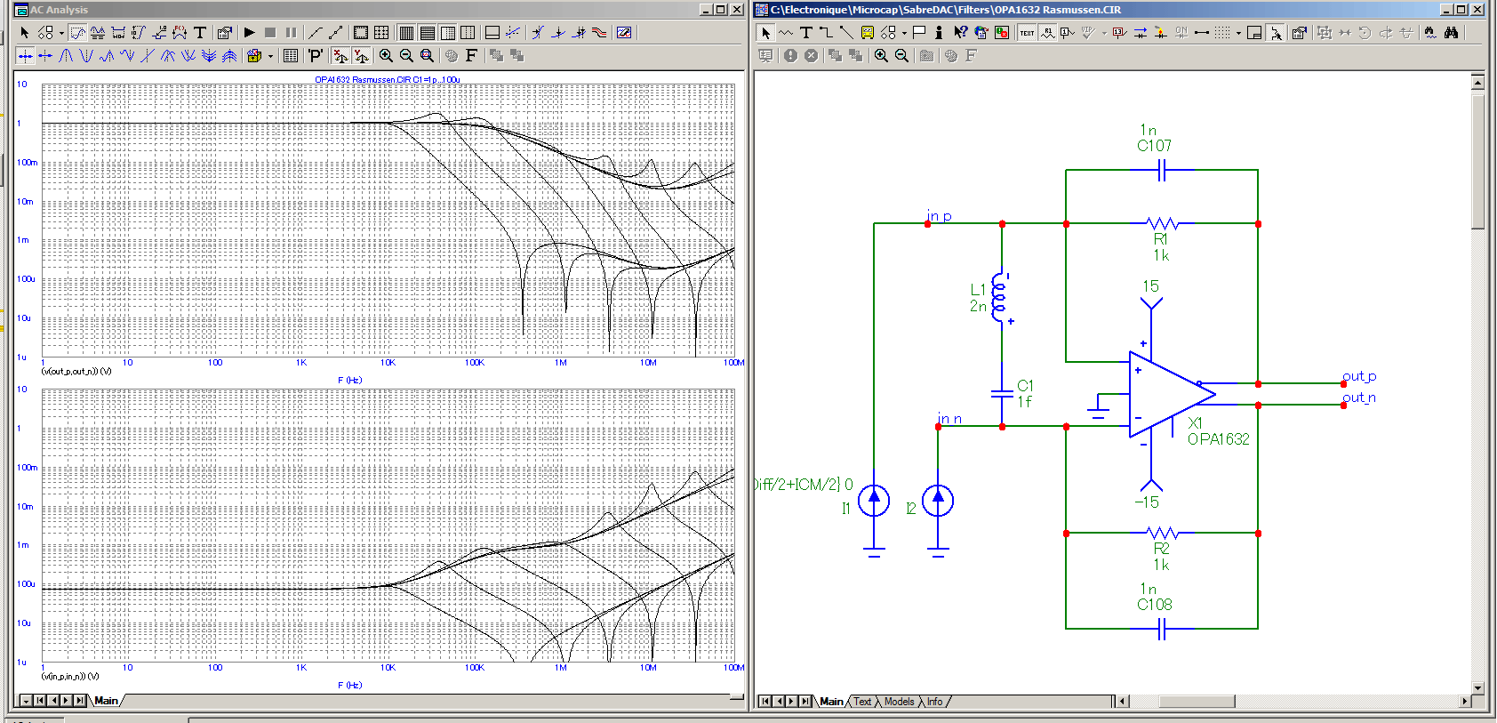

However the cap that Cooris has put across the DAC OP (opamp IP) will cause
a few things to happen: - It will change the compensation of opamp. The
1632 is no ordinary opamp and it appears to be very tolerant of this 'filter'
cap , probably because of the very low open loop gain, listed as 78dB at DC
in data sheet. How successful this cap-a-x-dac scheme would be with normal
opamps is questionable but I would proceed with caution and a good cro
- The second effect is the noise gain of the 1632 will be dramatically raised at
HF. Again, Coris you lucked out as the 1632 has very low noise so as they
say 'half your luck!
WRT Joes voltage mode LPF - this is not really new and many people,
including myself have used it over the years in many forms. It's pretty much
the first place to put a LPF if you have a voltage OP DAC - before any
active electronics.
I can show you a box of these 'pre I-V' LPF's I have used over the years. Air
cored LC, LRC, RC, transformer integrated, etc etc.
There was a comment WRT some magical interaction with sinc dig LPF, I
don't think so. I think it is just attenuating HF energy before any active
electronics have to - which is always a good thing.

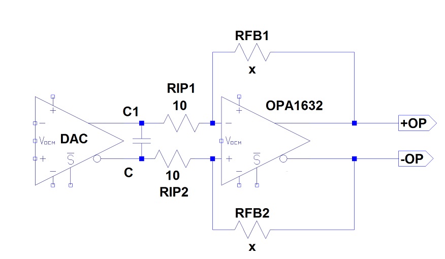

Coris if you wish to try Joe's true 'voltage mode' low pass filter with your
existing differential opamp ref to schematic below. R IP 1/2 can be chosen
together with appropriate cap size to get required HF rolloff. This scheme will
increase the noise gain at HF but you should have no stability issues.
Values of IP R could be any where from 20 ohm -> 3ohm. The lower the R
value the larger the cap must be for given HF roll off. The larger the value of
IP R the more the DAC will work in 'voltage mode' with it's sonic impact.
There are more options such as small C's on each RFB to reduce HF gain.
As you can see there are a myriad of options when applying to an active
opamp based I-V and yes - a lot of us have tried most of them too.

Let's spice it : a textbook OPA1632 I/V with 1mA differential current at the input, 1k IV resistors and 1nF feedback cap. -3dB point at about 160kHz.
Attachment 1 :
Sim with and without "C1" (3nF cap at the opamp input).
As expected the lowpass rolloff point does not change. All the cap does is add some nice peaking around 10 MHz.
Attachment 2 :
Same, with more "violent" values for C1, up to 100µF, stepped in decade. To get some change of frequency response in the audio band, at least 10µF is needed.
Coris, if you have a different circuit (making this sim irrelevant), please tell us about it.

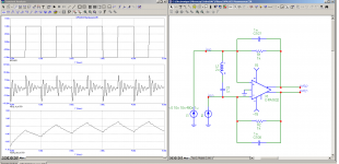

Attachment 3 :
Transient simulation. No added capacitor.
Top curve, input current. Middle curve, voltage at opamp input. Bottom curve, output.
Opamp and its feedback caps behave as first order lowpass.
No problem here, everything behaves as expected. Which means it doesn't work : opamp goes in slew limit, input voltage is large, upsetting the opamp input stage, peaks of output voltage have ugly warts (see zoom insert), etc. That's the usual opamp IV, I guess that's why some don't like it...
Attachment 4 :
Transient simulation. Added capacitor at input.
Reduced phase margin makes opamp less stable. The input waveform is a mess. Output shows signs of ringing too.
Attachment 5 :
Removed feedback caps. Tweaked circuit values to get ringing similar to this trace.

The only difference between this "single pole" Rasmunssen filter (cap across the DAC differential output), and a classical single pole filtering technique (caps over the I/V feedback resistors, or even more sophisticated filters between I/V and final opamp), it is that while the Rasmunnsen filtering produce the effect we discuss about, the another classical filtering does not...
One will never get the same obvious sound scene/space definition and accuracy when using classical ways of filtering. I have been struggling with this a lot, I may say, and suddenly this simple "single pole" cap across the DAC differential output it gave me what I was looking for.
At last is very little important how one may call this kind of filtering. More important is to be found out why placing of this cap in that place it produce this effect.
Suggestion for Current DACs:
This will be the most common config using ICs and Virtual Earth. Also my least favourite.
The cap value shown is only a rough suggestion - aim to adjust value to be -1.3dB to -1.5dB @ 20KHz.
Note in this case, the cap is before the resistors and since the resistors are between the cap and the Virtual Earth, those resistors define the R of the RC filter.
