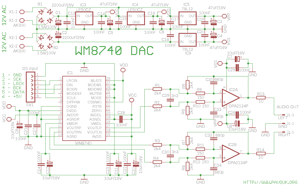

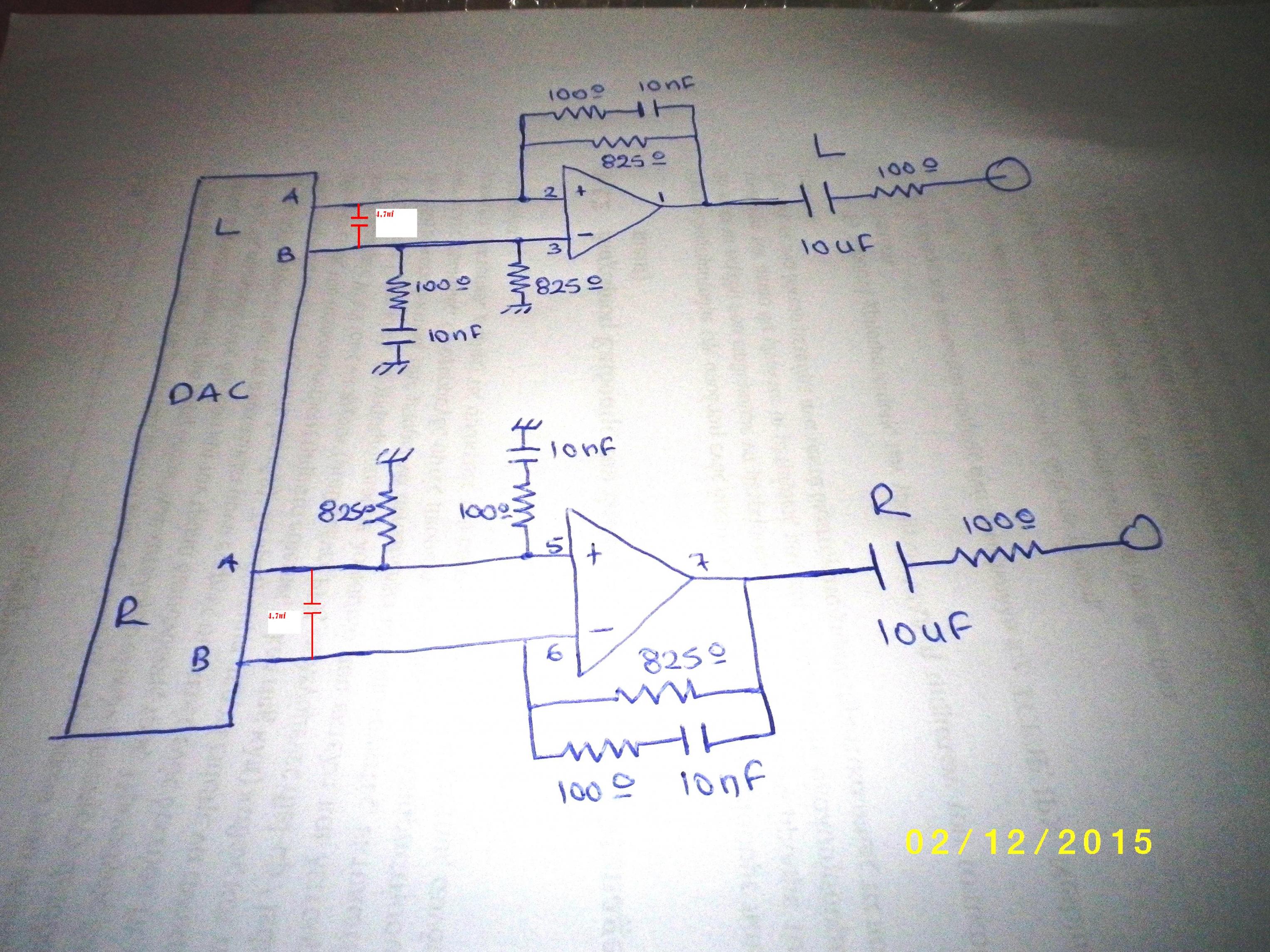

Hi Joe
Here is exactly the data sheet with double opamp OPA2134
maybe the capacitors 10nf in all section must be wrong value .I measure it on board the meter gives me 0,01 uf.
Look at the picture ,I put 4,7 nf is this correct?
What kind capacitor must use COG ,MKT.MKP?

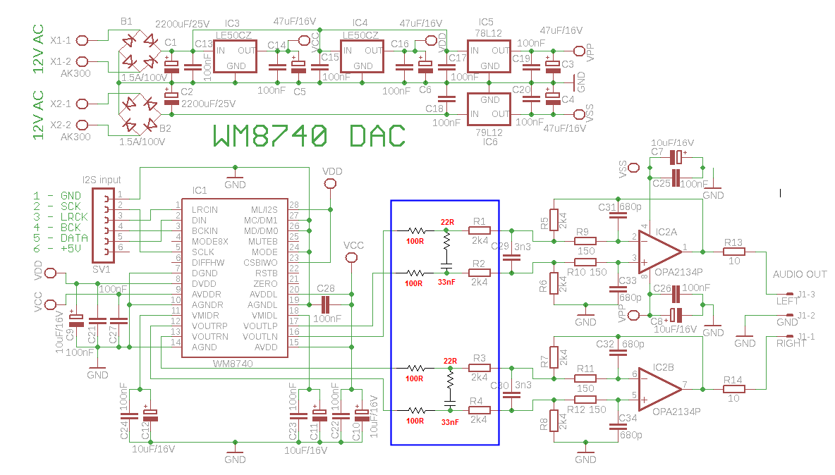

Hi Joe
Can't answer all your questions, but that actual schematic, I have modified it and uploaded it and should be visible below.
You can add correction caps across R1, R2, R3 and R4, but I would suggest you don't bother unless you know what you are doing, wrong value and you could end up with an excessive rising response. So add the components shown and take a listen.
Cheers, Joe
