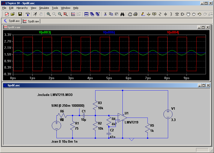

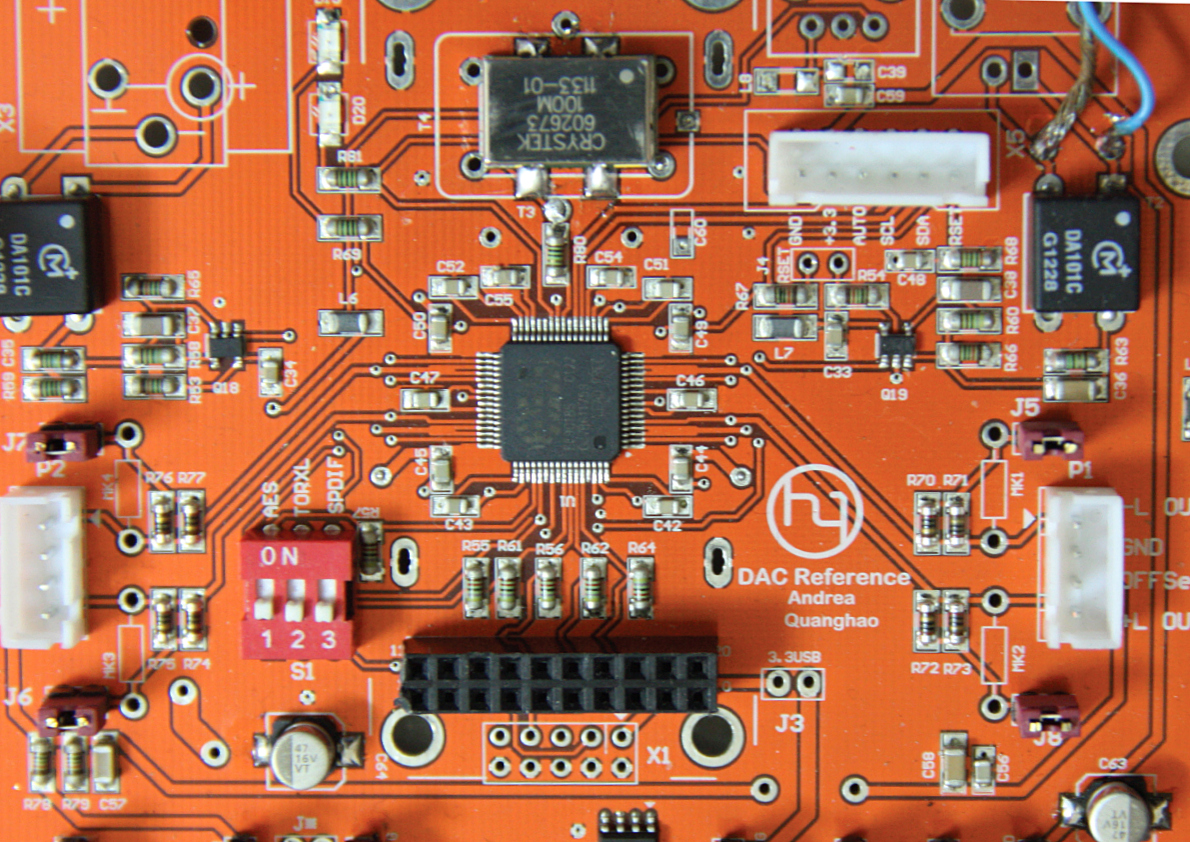

The smc marked "C14A" is a LMV7219 from TI

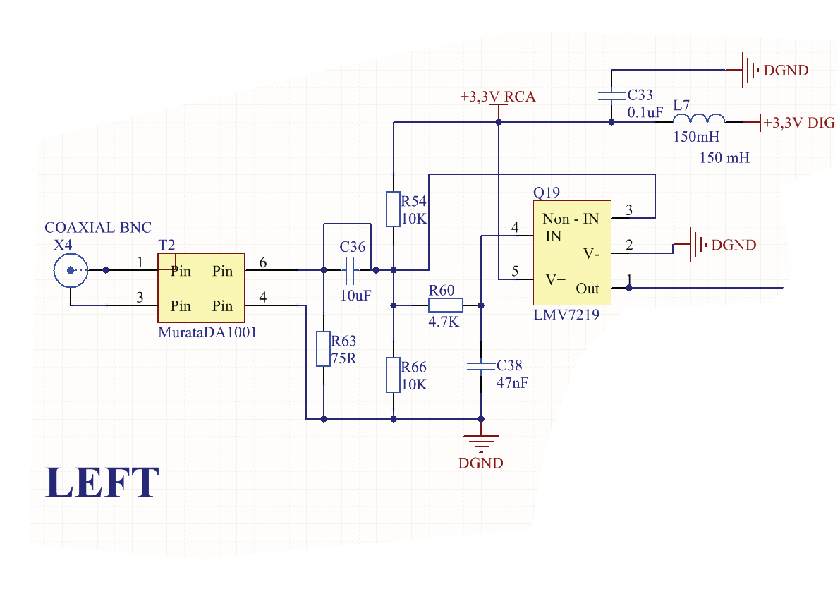

Comparing circuit to schematic, this is what I think
C36 is C7
R13 is R63
R15 is R66
BTW, since C36 is removed, now R63 and R66 are in parallel
R14 is R60
What happened to R68? Looks like someone reworked it.
R16 is R54
Not sure why it is not working though.
Also funny you can't get toslink working above 44k.
Optical shouldn't care about the length too much. I am using a cheap monoprice optical cable. I haven't listened too much to this input, but it worked no problem, and as soon as I put in a 96k song, it locked on, and indicated 95k on the display.
Randy
So I am not using SPDIF, mostly I use USB, and I can use to toslink but I don't plan to use it much.

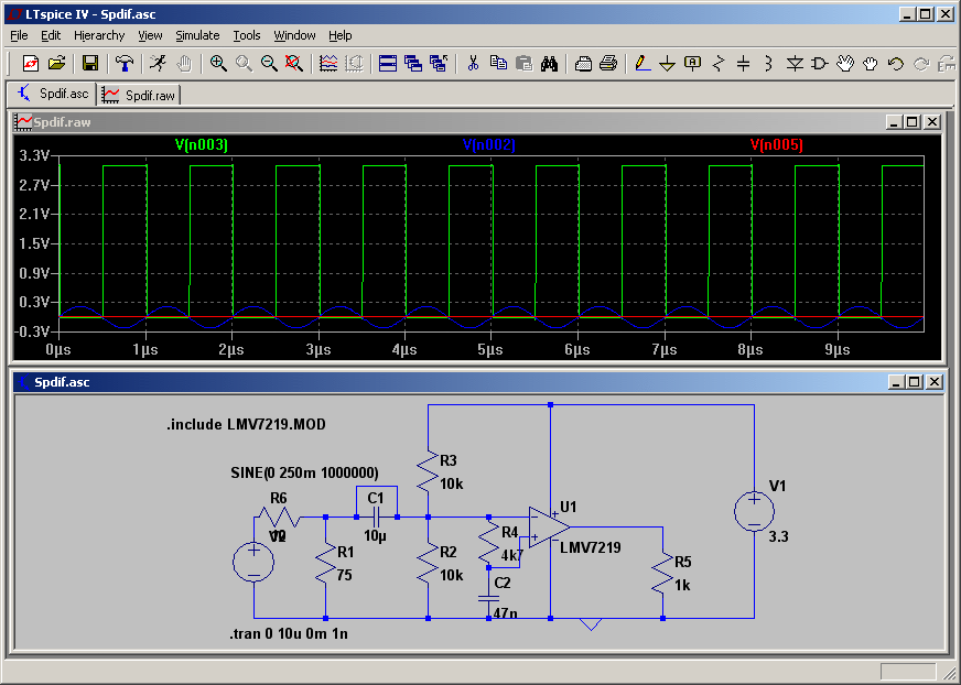

But, if I wanted to use SPDIF, I would cut the trace across C36, and install a small cap there. I think a 10nf would work.
Reason is that with C36 shorted, R63 and R66 are in parallel, and this creates a resistor very close to 75 ohms.
R66 is part of a resistor divider network designed to generate the correct voltages for the 7219 voltage comparator to operate. I don't expect that it is working properly with an R66 that is effectively close to 75 ohms, R66 should be 10k.
Somebody want to try my theory?
Randy

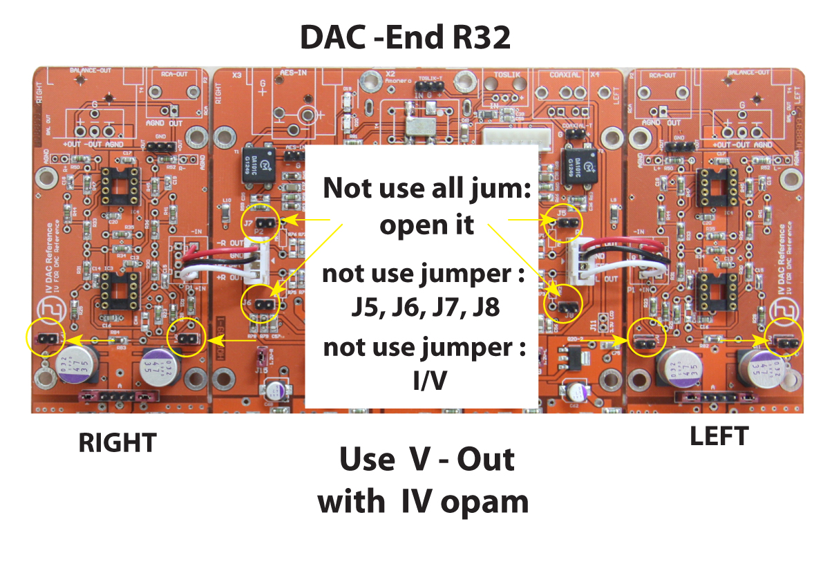

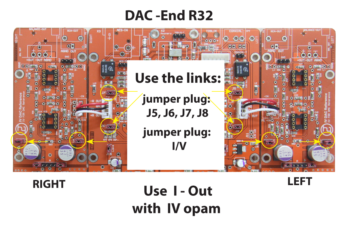

Invite you to see this picture. Please try 2 sound modes:
1. DAC with: I - Out
2. DAC with: V - Out
Thank you, and tell me the sound of the 2: I-out and V-out
I have had many tests showed, remove capacitors in this position, it will sound better.
Take a look at the circuit diagram
Hi Quanghao,
The problem is some of us certainly require spdif/coaxial to accept 96kHz or higher :h_ache:
Maybe it does sound better, I haven't (and most likely won't) compare, so I cant comment.
But, looking at removing the cap, it is messing up the comparator circuit. I'm sure the circuit wasn't designed to have the 75ohm in parallel with the 10k resistor.
This could well be why you can't get over 96k, I thought the es9018 would do it, and was surprised when you said that 96k was the limit. I would also guess it is marginal at 96k and depends greatly on the source. Seems like most sources are not working at 96k with this circuit.

If your source is not able to drive the standard spdif load (75 ohm) remove the R63 resistor and test it.
The lmv7219 amplify and square the spdif input to convert it to a TTL 3.3V signal so C36 is necessary for the correct functionality of the circuit.
In some cases abnormal ciruit modifications can create a better sound. :)
I will definitely try it both ways. Thanks for the diagram! That is very helpful!
However I would also like to try the DAC with a tube output stage, as well as a transformer output (among other things). But I need to find some more of those 4-pin connectors to be able to do this without soldering to the main-board.
