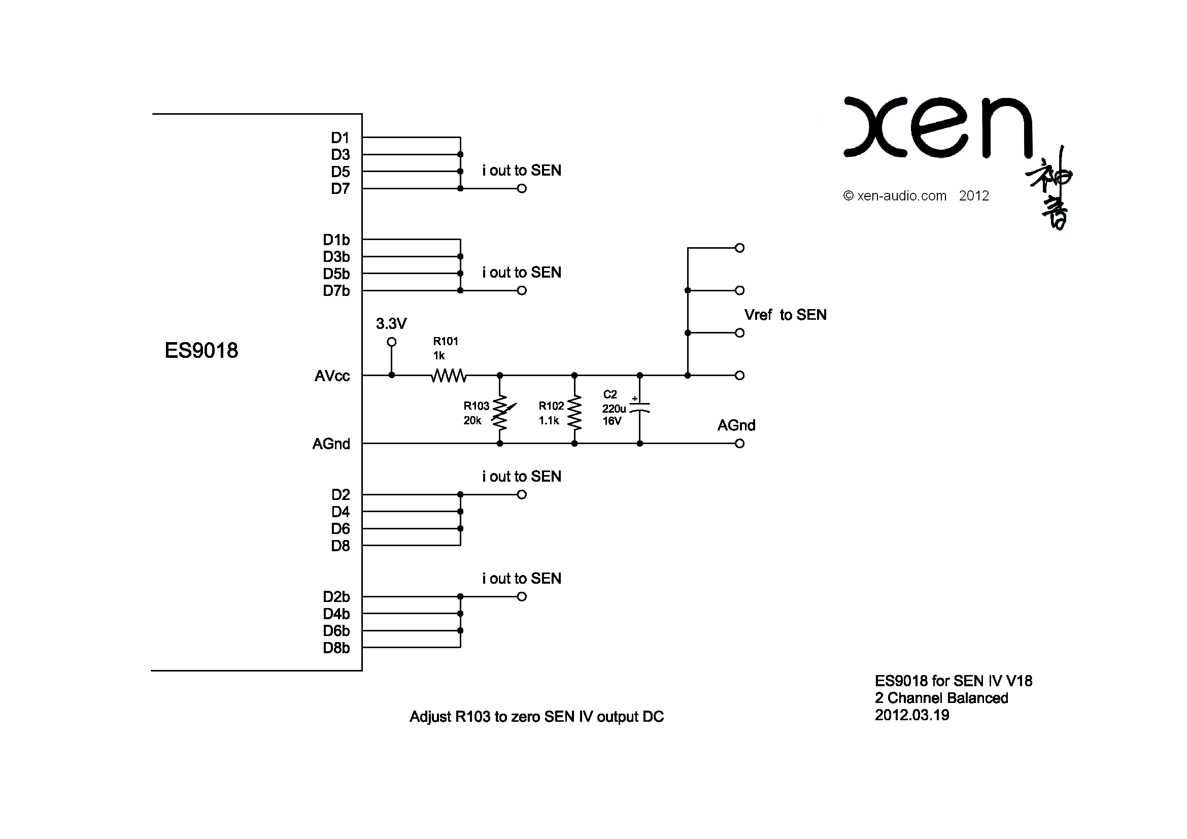

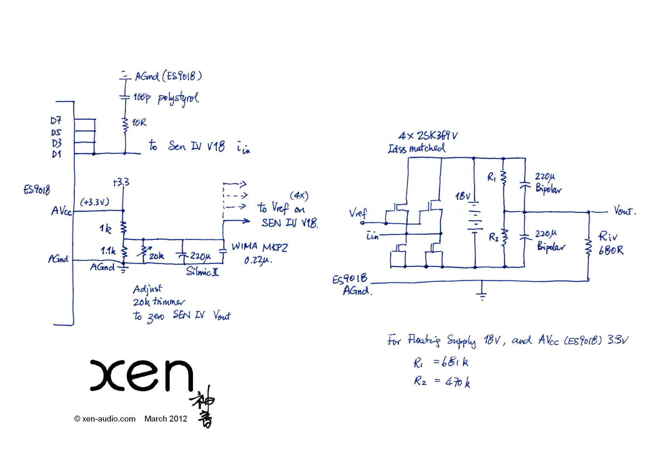

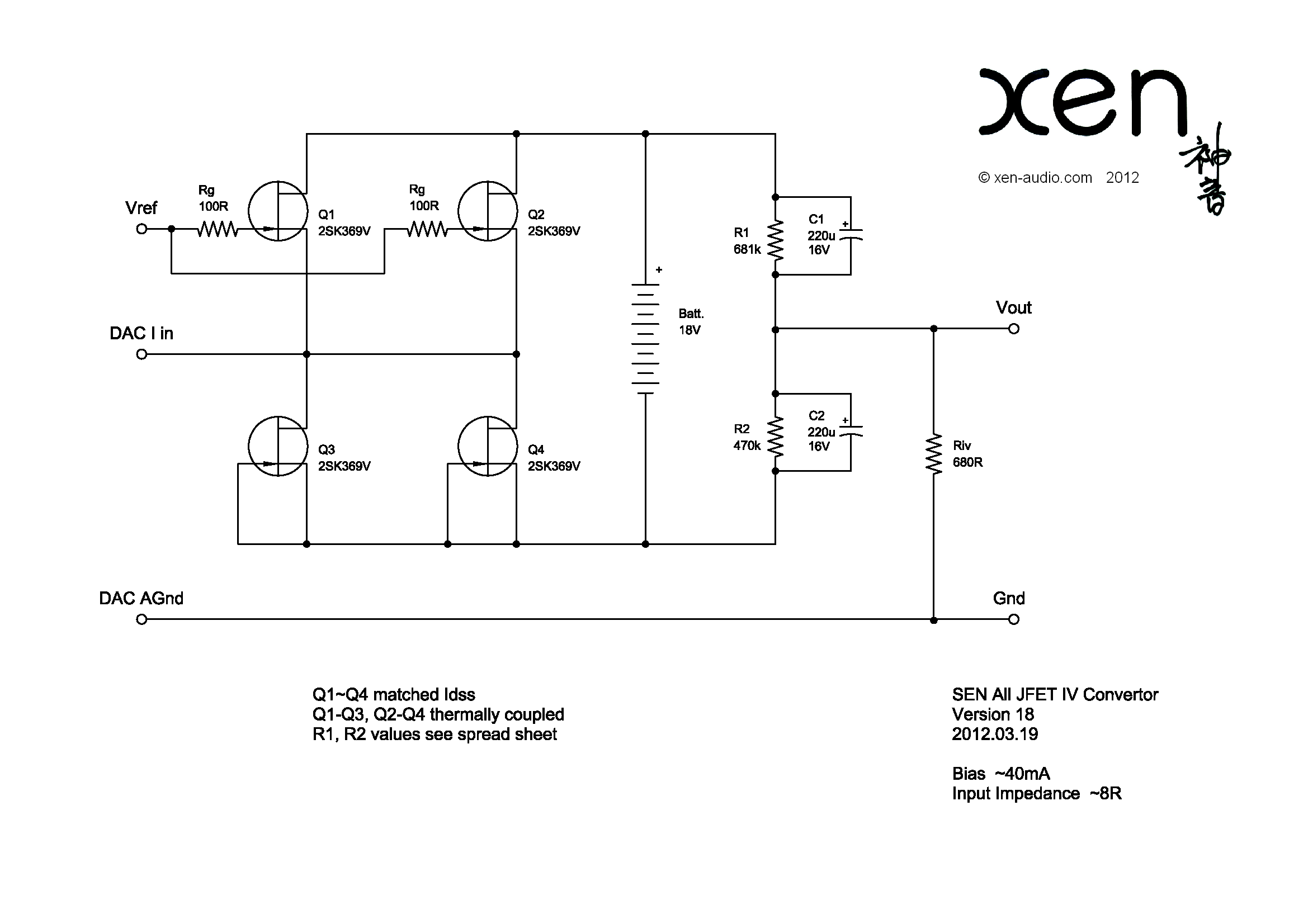

I plan to build the Sen V18 as I/V stage. The FETs are on their way.

The above mentioned thread is the place to look. V18 refers to the version of the SEN designed for the ES9018.
The original article from Linear Audio http://www.linearaudio.net/images/onlinearticlesPDF/didden-la -vol2euvl.pdf
Attached the schematics of the V18 version that I have found.
