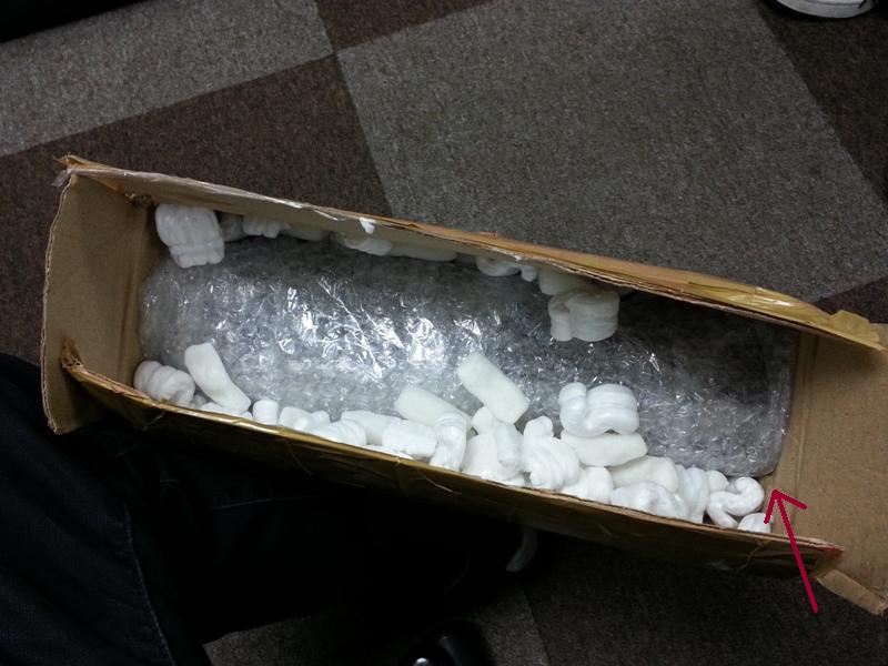

I'm concerned about the reports of edge damage.
Even with a layer of bubblewrap, the corners of the chassis are too close to the outer edge of the cardboard box to be considered properly protected.
There needs to be additional space around the chassis, just 1 cm would be OK ... the cardboard box needs to be larger.

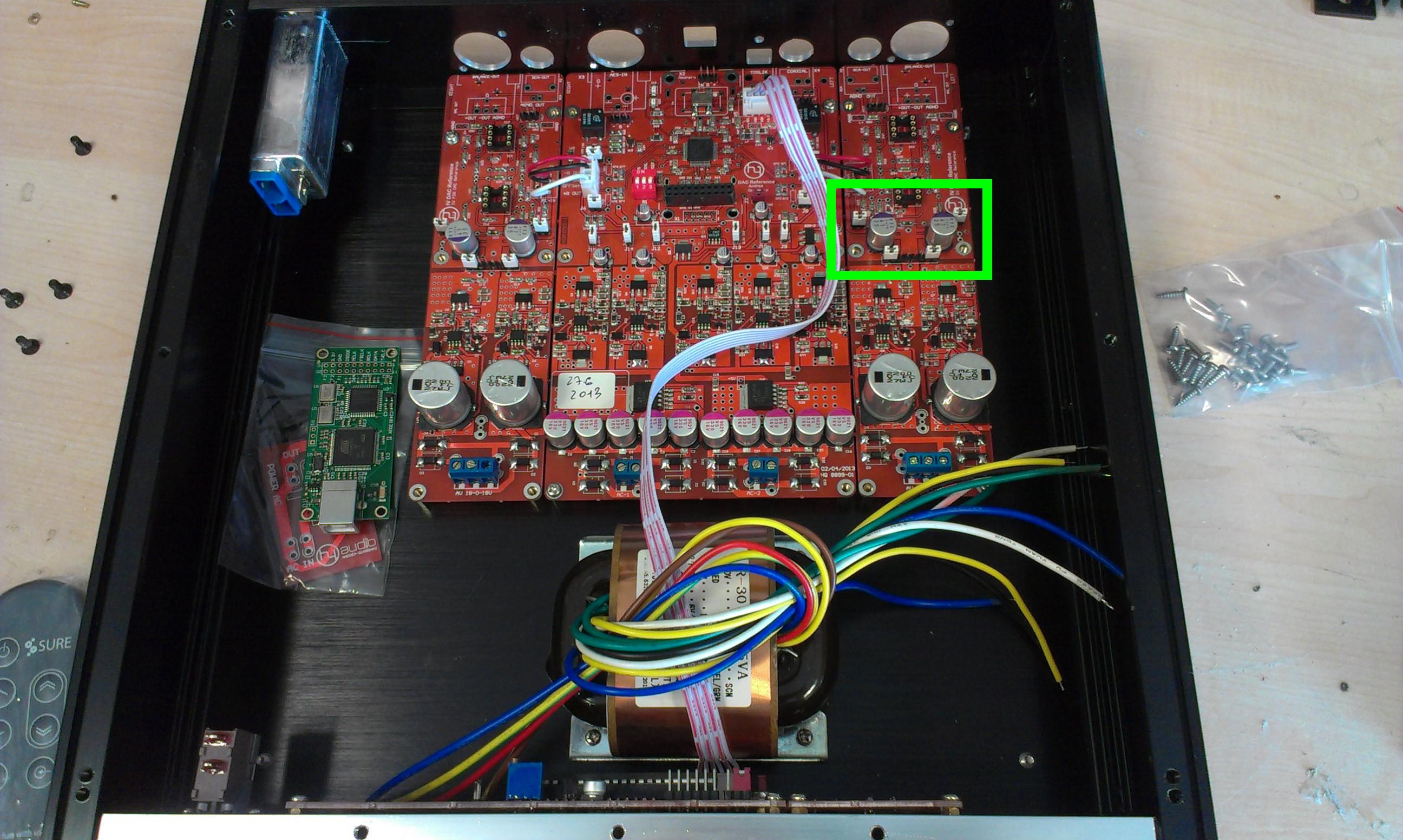

Hi quanghao,
I received DAC thank you.There isn't any cosmetic problem .
But i couldn't see opamps and any Input and output connectors ??
Amanero unassembled.
I paid extra 180$ for them am i wrong?
Thank you
Hi quanghao,
Did i paid extra 180$ for them am i wrong?
Thank you
And other cableing is not ready.So you mustn't test it.
Hi Quanghao,
You provide miscellaneous for AC outlet (IEC socket, power switch, PCB, ...) within the kit but no fuse neither fuse holder.
- The fully assembled DAC will not have fuse too?
yes, not have it! ( fuse)
thanks
You allso have wrong polarity of 47uF / 35V
Oh thank you MihajloTM.I'm waiting for answers from quanghao.

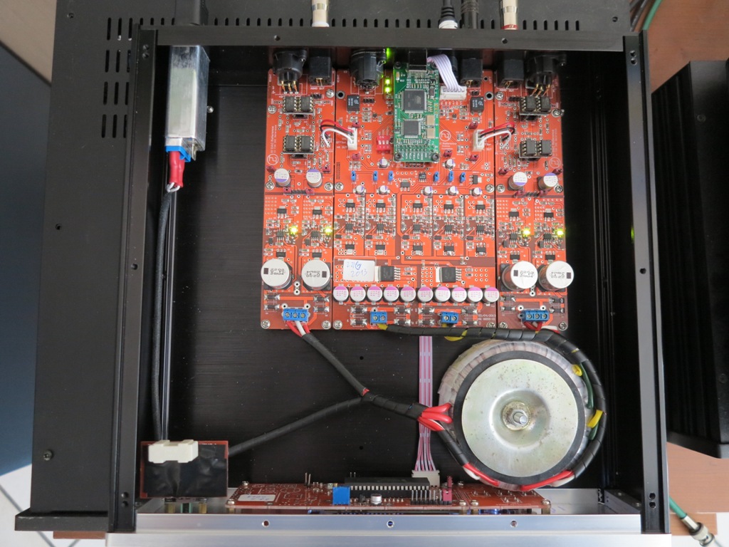

My "build" - unbalanced direct out. I am planninng on replacing the toroid with an r-core transformer. The DAC seems to be very sensitive to power line influences. When I switch the bathroom lights the DAC looses the lock for a second. USB only so far.
The sound is an improvement compared to the Musical Fidelity V-DAC II which I was listening with for a year now. A very noticeable improvement in bass.
