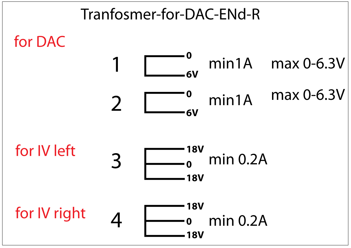

Hello,6Vac 0.5A
6Vac 0.5A
18VAC 0.2A
18VAC 0.2A

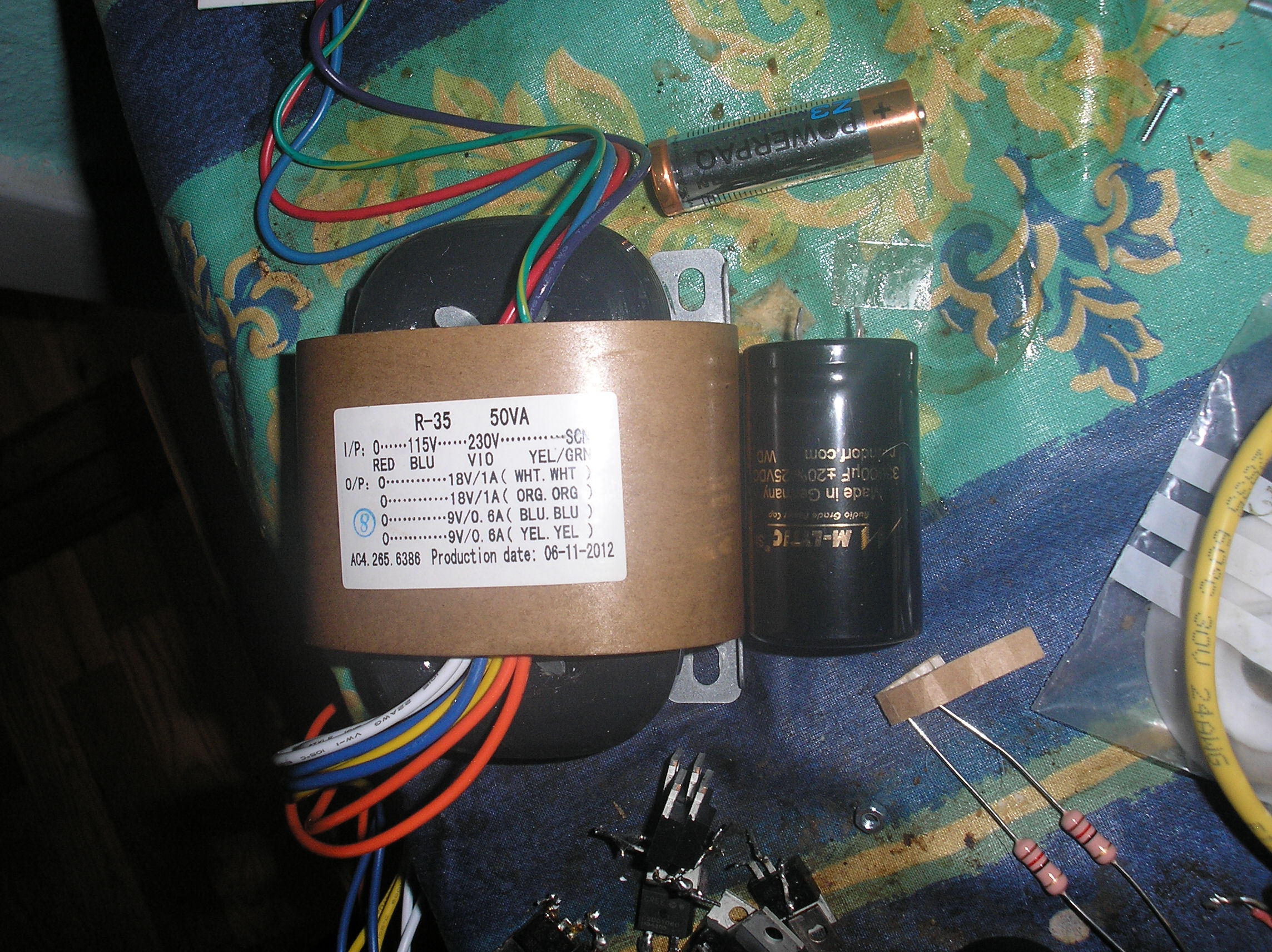

Thanks for these informations, but as showed in post #676, TX has only 0,15A for 18VAC ?
Furthermore , DC voltages will be in an other chassis ( i will not use rectifiers on the main board) , so it's the reason of my question.
Br
Jacky
9VAC not good !
A resistor before the diodes . But ok I will use 2 transformers.
The current rating looks a little low too. I had a couple 6.3V, 2A trannies around, so I just used them and they appear to work fine.
In different posts, I have seen different transformer requirements, so it is a little confusing.
Randy
If you still need to order it
2 x 15-0-15 Vac/>200mA
2 x 0-6 Vac/>1.5A
According to this post I have ordered a 15V-0-15V transformer.
What's the impact of 15V-0-15V versus 18V-0-18V?

Yes I am aware off the 0,6 A is to low so I will use the one I have for the I/V and the one from the group buy for the rest.
But a resistor before diode functions very well.
yes, 0.6A ( 0-6 V for DAC ) it is to low,
because when you run DSD, DAC need about 1A when play with uSB!
