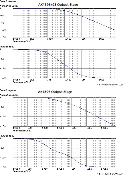

What changes is the frequency at which the filter starts to attenuate.Therefore using the filter suggested in the 4393 datasheet with the 4396 will result in identical frequency response as if it were used with the 4393.

From this graphs you can see there is a difference, not big but it's present.

Sure if different LPF filters were used then the frequency differences will be directly attributable to that.If you used the same filter on both DAC's the frequency response (as in hi frequency roll off characteristics) would be the same.
Sure if different LPF filters were used then the frequency differences will be attribuatable to that.If you used the same filter on both DAC's the frequency response as in hi frequency roll off characteristics would be the same.
Your sentence is contradictory...
Those graphs represent the frequency response of the two LPFs alone.
So, if you apply to the same dac the two filters you obtain different overall frequency response.
So if frequency reponse of DAC + LPF is, as specified, +-0.2db you can conclude that the two DACs have different frequency response.
Not contradictory at all.My point is that if you used for example the 4393 filter in the first graph with the 4396 it would result in the same response as if it were used with the 4393.In other words it is the LPF that is determining the response not the DAC chip.
