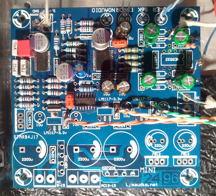

just wonder if my sketch is correct?
I think so
An even easier access point are the decoupling caps' pads at the right marked 104.

i searched the tread on this issue. only some advise on checking the input which i did with another board. the spdif input works perfect. and still this rrrrrrrrrrr-noise with or without music.
any suggestion? please .....
What is the spdif source ?
What are the power supply ?
Please make some pictures of the board .
Serge
I think is a grounding problem.
Last week I've tried to put the 7X12s on bread-board so it would be easier to compare them with the shunt regulator I'm preparing... result:
rrrrrrr-noise
Guess what?
I've soldered them again on the PCB, no noise...
