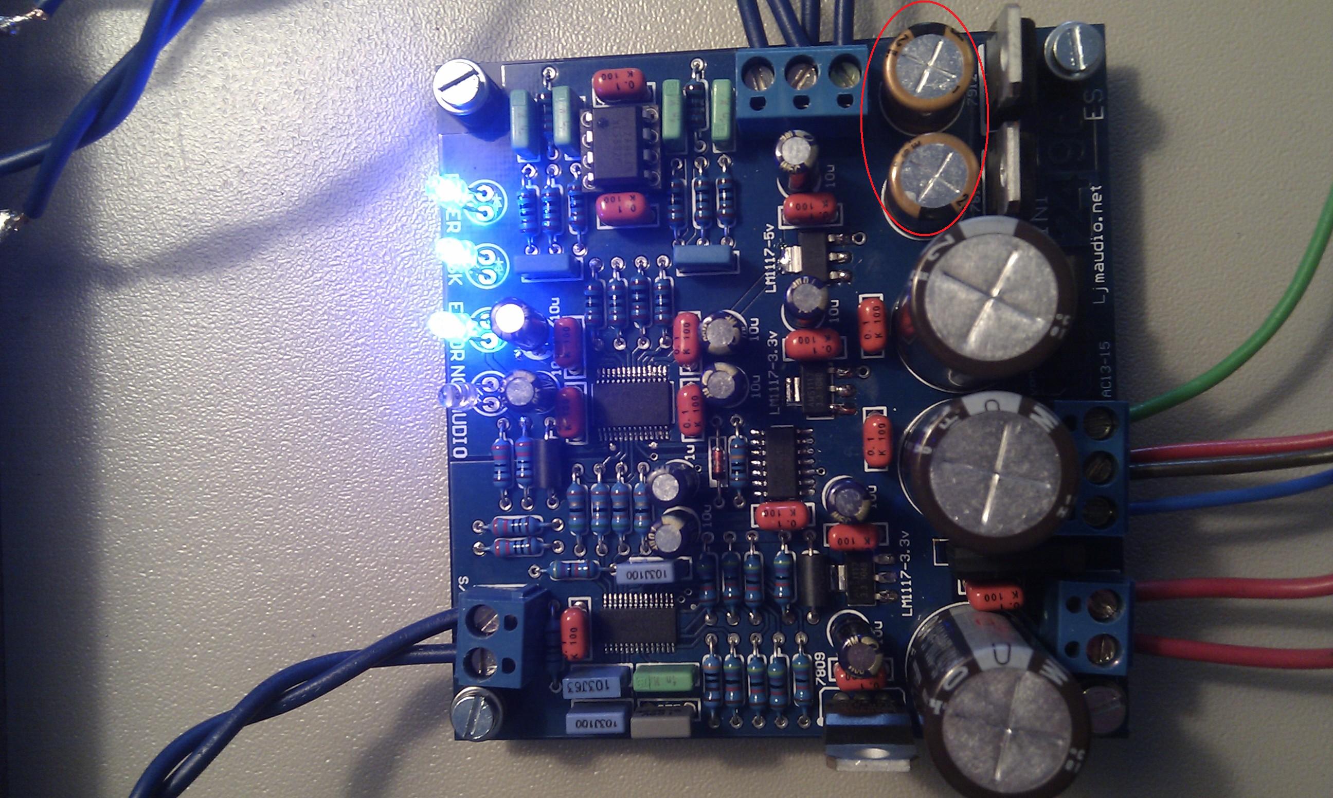

I think i wil try to replace the 3 2200uF nichicon caps, whith some Silmic ( I or II ?? ) and try finding highest voltage. But space is a problem
What about the 2 caps in the pics attacht (red mark) ? Anything better i could change to ?

I've yet to confirm it but pobably the digital one could be left as is, I would focus on the two analog ones (consider also Nichicon FW, cheaper and very good 2200uF/63V fits).
Yes, as I've said in last post, Silmics or Cerafines (100-220uF) ;)

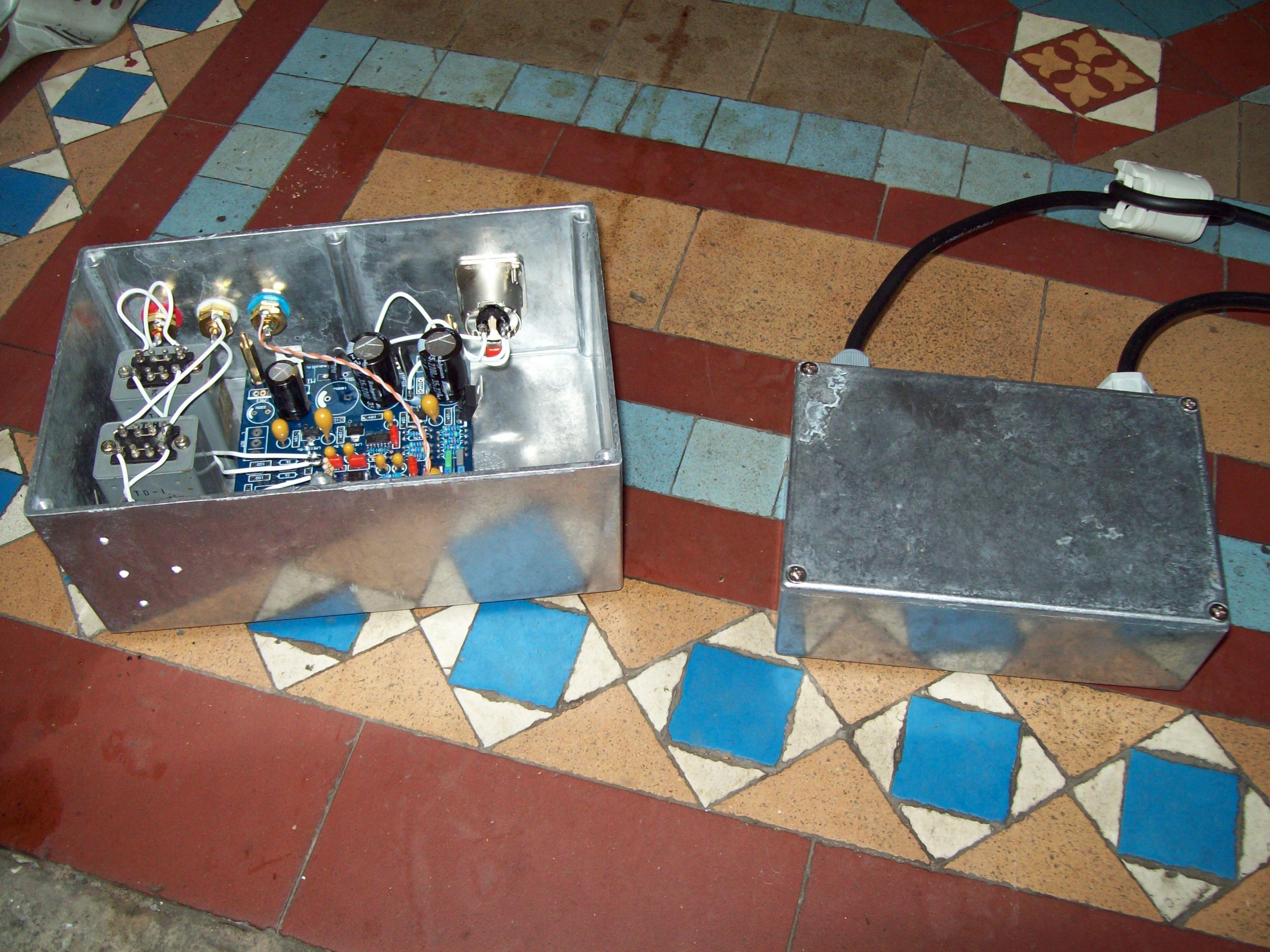

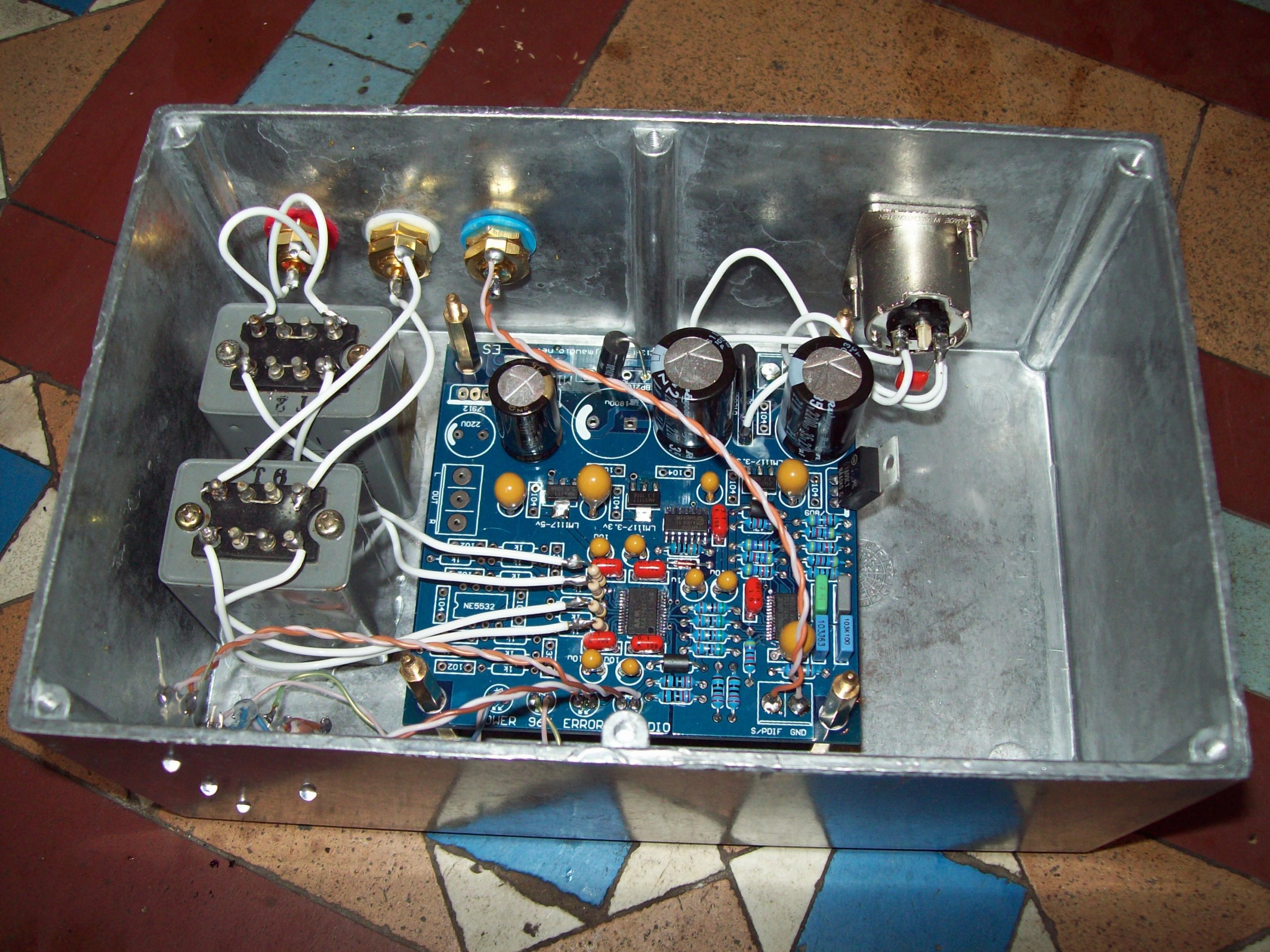

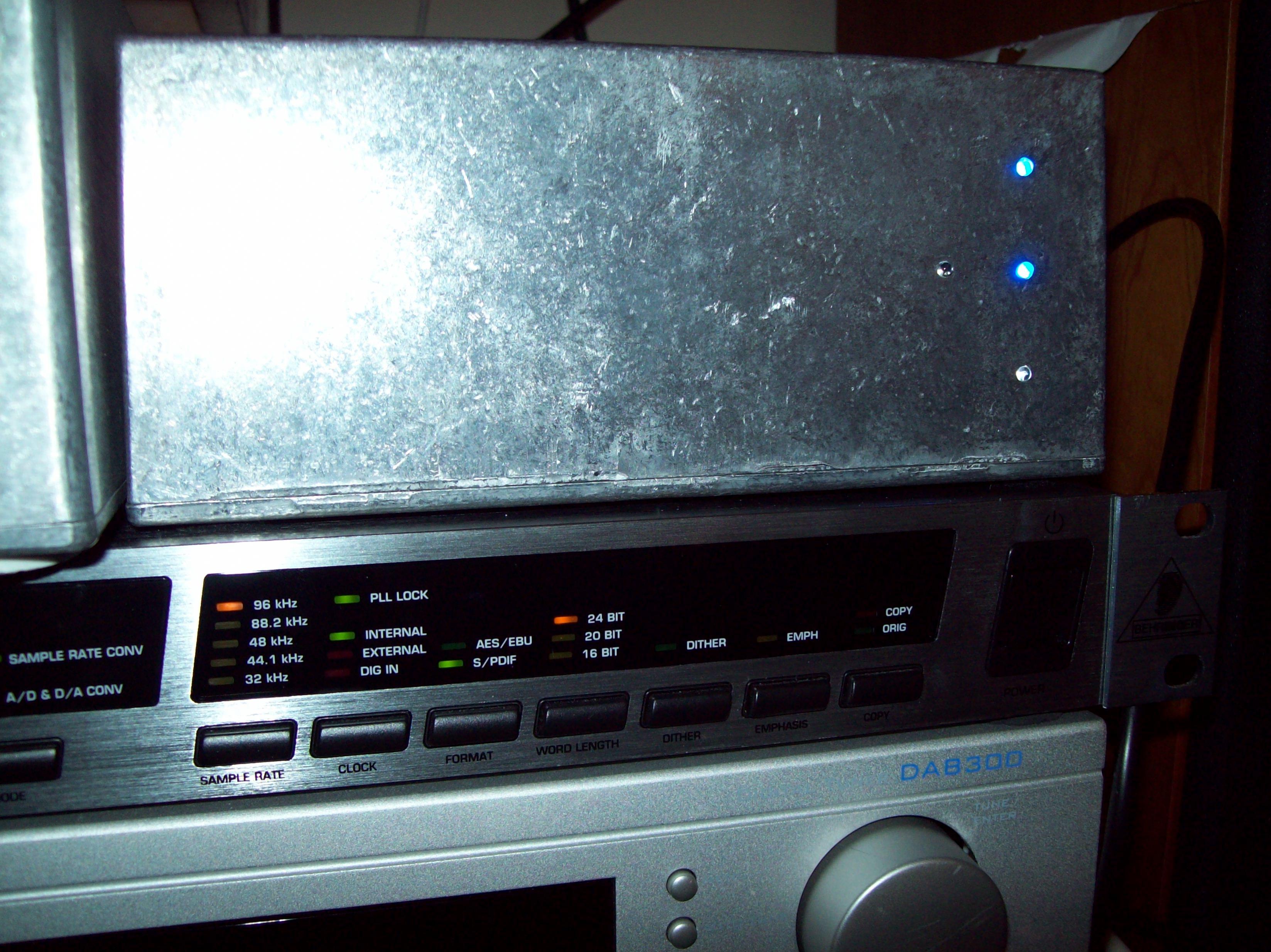

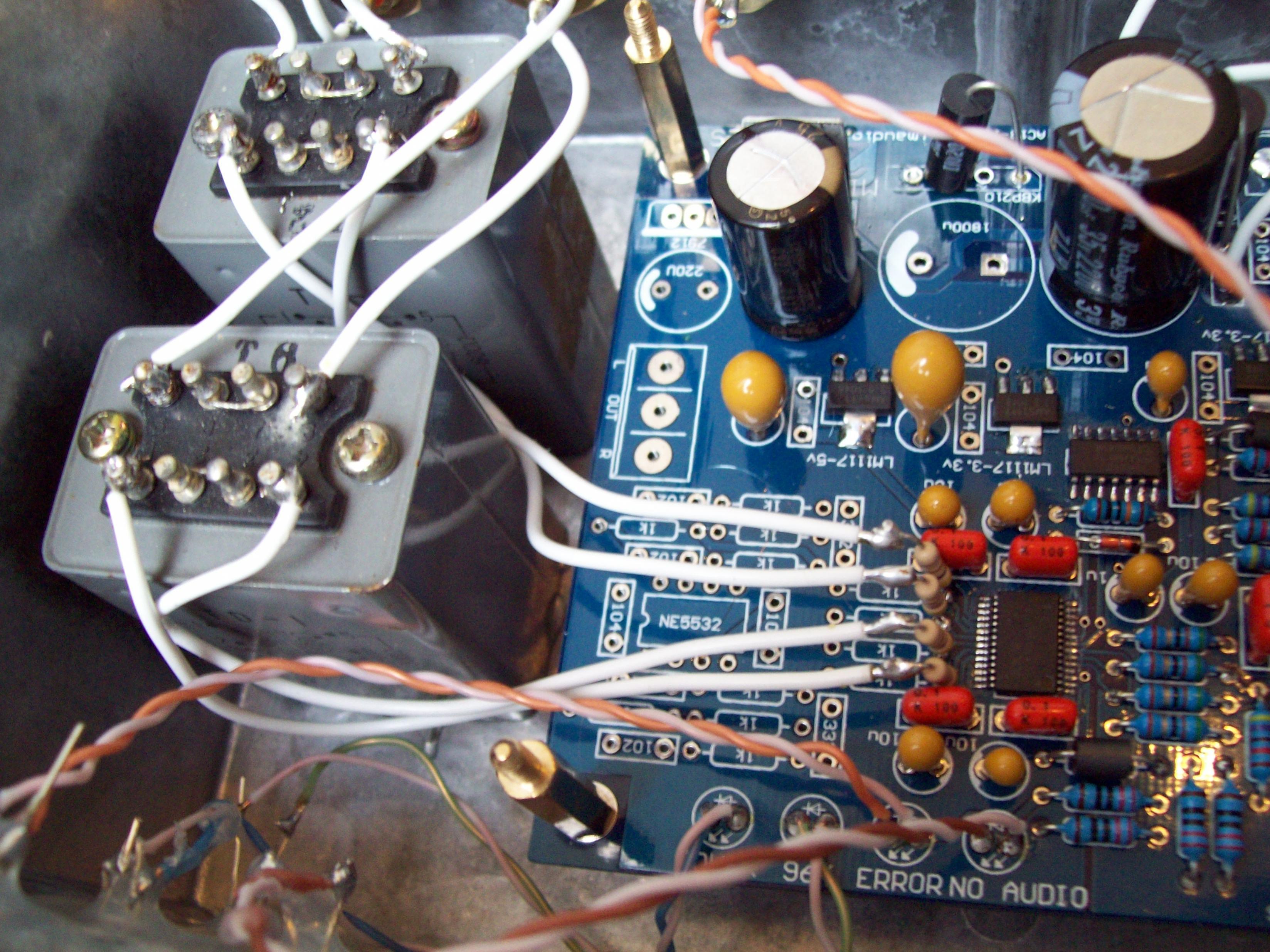

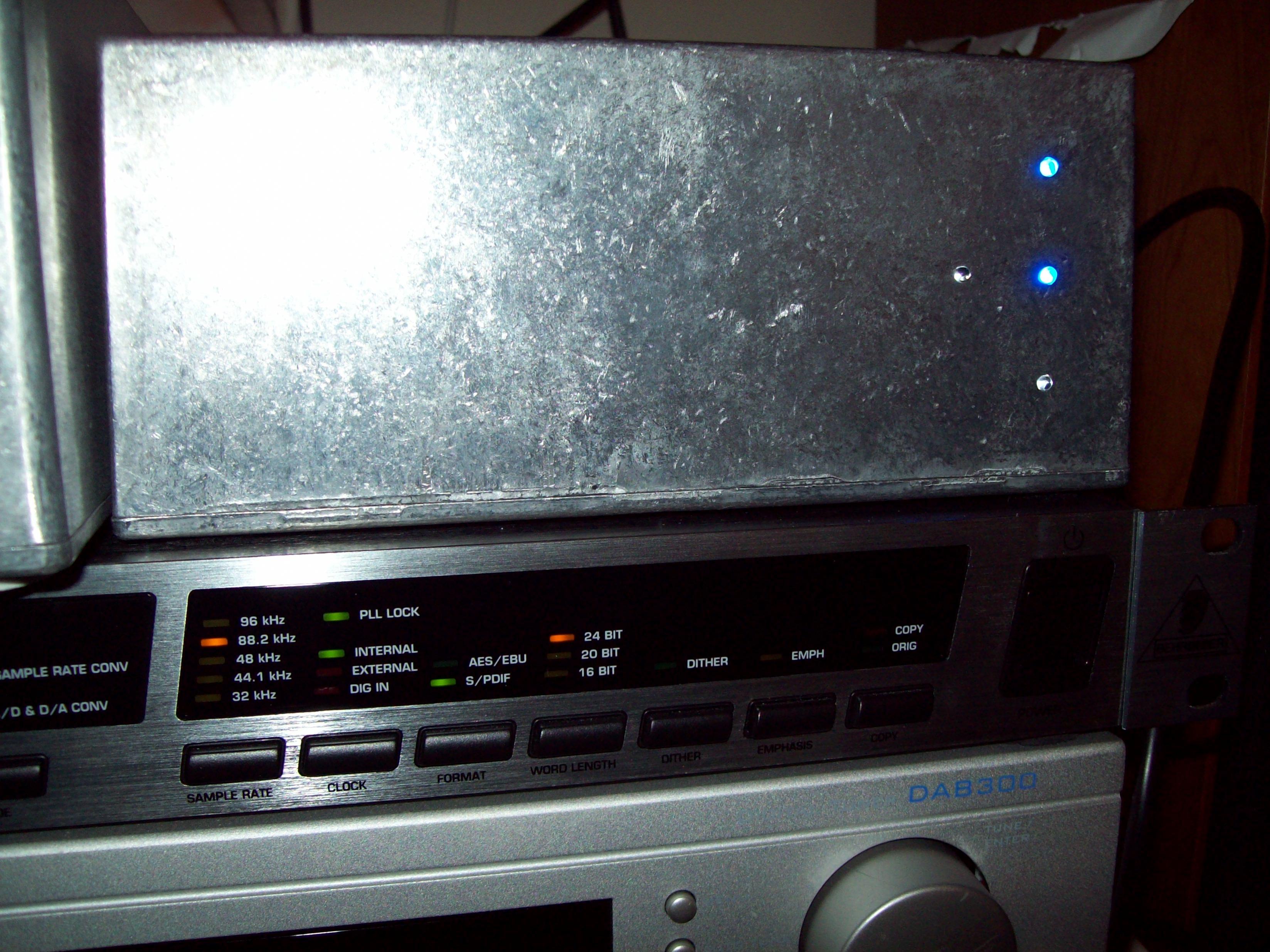

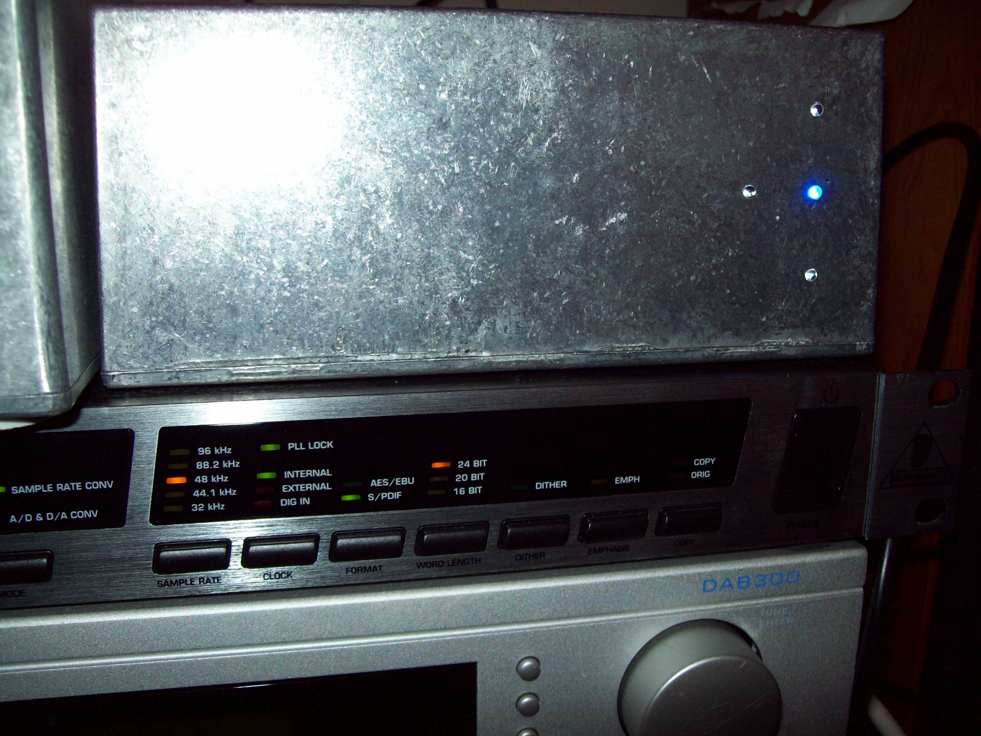

Just finished my AK4396 kit build. Didn't bother wiring up the -V side of the board as I'm not using the stock opamp output stage. Using Tamura TD-1 output transformers so tapping the balanced signal straight off the AK4396. As I'm using an off-board 12VDC PSU (currently SMPS but SLA battery to follow) I replaced the 7812 with another MC7809CT.
Sounds great so far.
