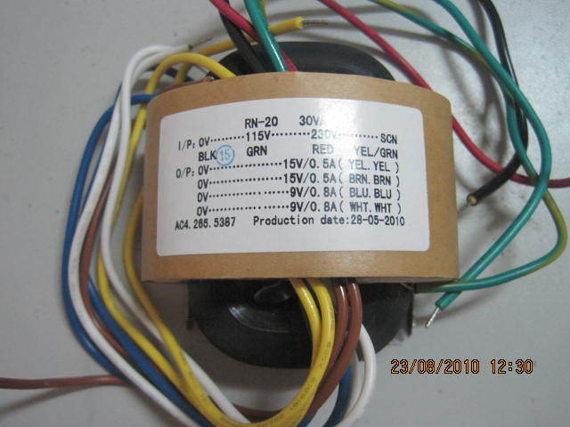

transformer wiring
Hey, I was wondering what wires to use for U.S. 115v on a CS8416+CS4398 DAC. I have a 30w transformer (pictured). The DAC has a three wire input on the left side and a two wire input on the right. what colors do I insert in each one? also what wires on the transformer go the power source? Thanks in advance.

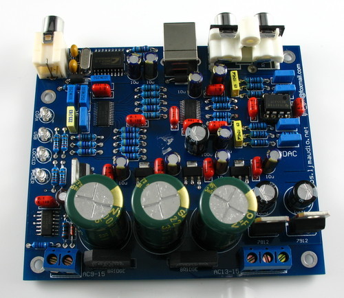

I've decided to bite on this DAC and here's what I'm proposing to do in the light of what I've read on this thread.
To buy a completed AK4396 but ask that the seller just solders the 2 ics and leave the rest to me - has anyone asked the same and if so what was the response?
My reason for buying the finished deal is that the cost of buying both a chassis and mains Tx as seperates just does'nt make economic sense.
I'd also like to buy a second blank PCB so I can easily compare an op-amp to resistor/cap o/put by changing the PCBs.
I fully appreciate that most PCBs don't like to messed with, hence the second PCB.
Somewhere on this thread I saw a YoutTube video on soldering ics but damned if I can find it now. I'm intrigued as to what looked like liquid flux that was being used and the large bit that was being used which surprised me - it's the same kind of bit I always use.
Secondly could someone kindly provide the link to Dario's final BOM.
