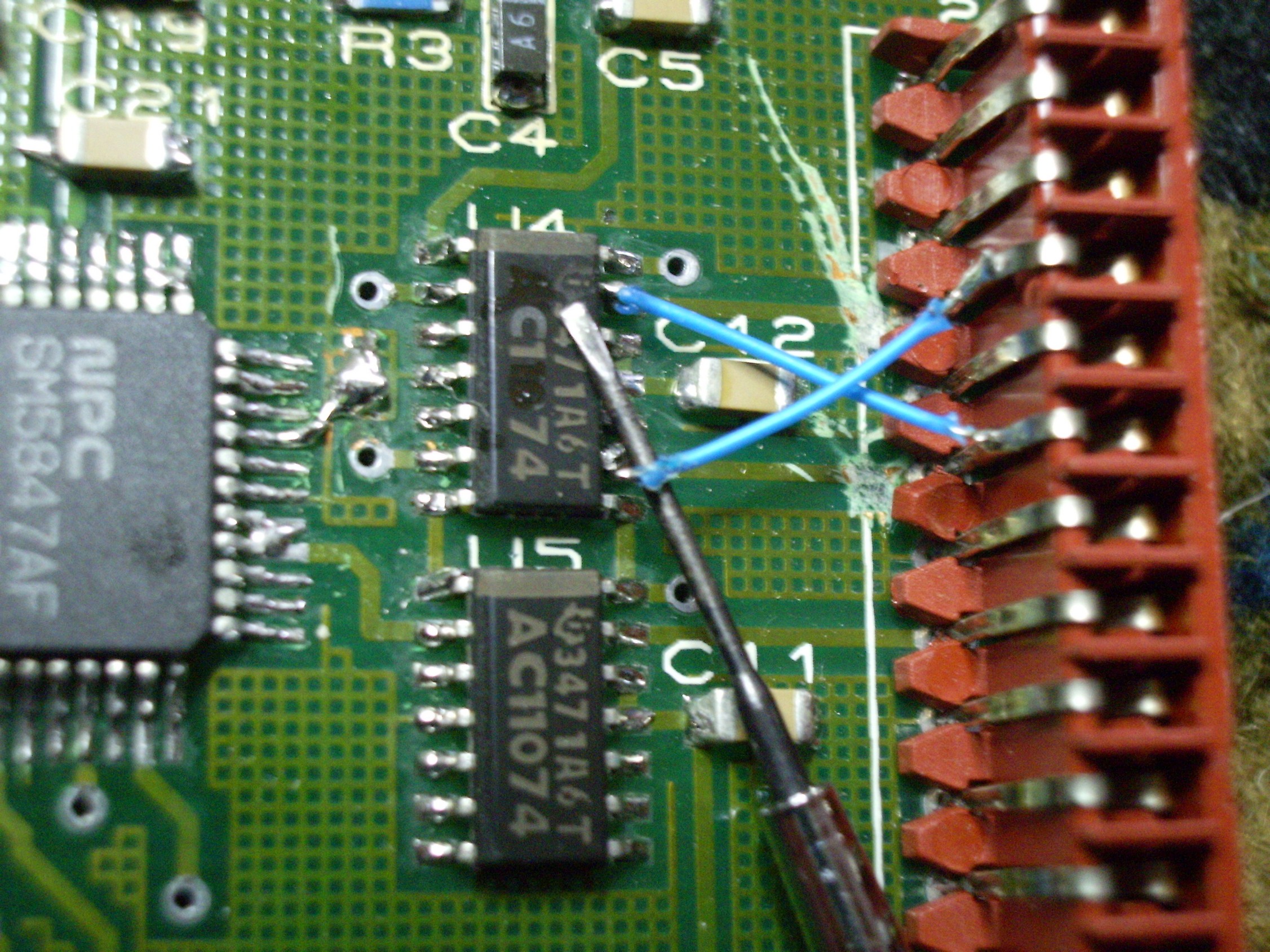

Those of you who are having problems with the digital filter, have you checked to see if the blue wire solder joints are broken?
I just repaired a 24 bit filter with one wire that had detached from the chip pin.
I guess it must have been weakened during manufacture when stripping the wire sheath and over the years the small movement imparted by fitting the filter a few times onto the pins was enough to flex the wire and eventually break it.
With this case the filter had simply been removed and then refitted.
The broken wire in this case carried the SCLK. The symptom was that the Dacapo went from playing normally to not doing; no white noise or other sound.
