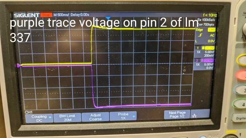

Check voltage ramp-up at LM337 input (pin 2) to be sure it is not input side problem.

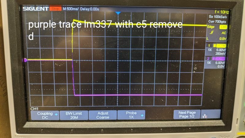

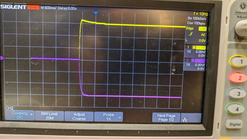

Scope shots attached, but if I am correct, the slow ramp is due to the denoiser. Voltage at pin 2 with denoiser in circuit shows no ramp, and output shows no ramp when c5 is removed.

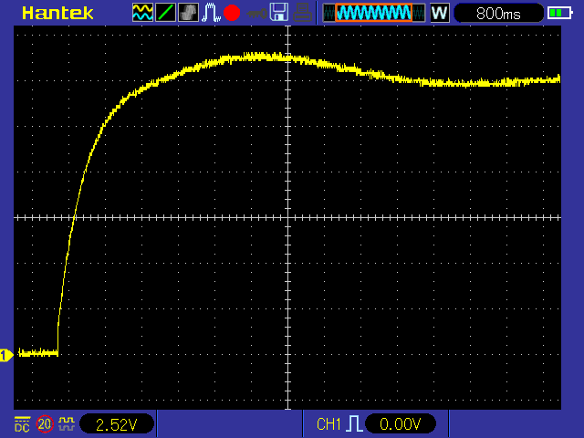

Yes, you are correct. I’ve assembled one regulator with LM337 and checked behavior. Without C5, output voltage is at nominal value almost immediately. Increasing C5, also increases voltage rise time. Unfortunately, with 100 uF C5 value, regulator is not stable. Here is output with 220 uF C5. Nominal output is 15.3 V and there is some overshot.Scope shots attached, but if I am correct, the slow ramp is due to the denoiser.

It takes about 2.5s or so to reach the target voltage. The positive reg overshoots a little but is at target voltage after ~0.5-0.7s.
So, although it wasn't stable for @tombo56 above, I swapped in a 22uF instead of the 220uF for the coupling cap. Bingo, I see fast startup. Apart from the slight overshoot on the positive reg, both hit target voltage simultaneously, about 100ms or so I reckon.

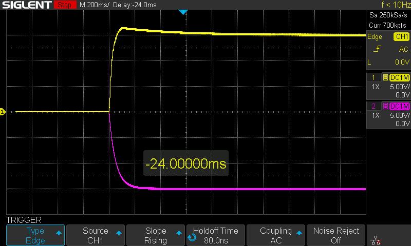

LM337 denoiser setup: I tried 100uF and 47uF coupling caps, both gave very similar startup times to 220uF - about 2.5s to hit target voltage. In the end, I replaced the 22uF cap for coupling and I get a time to voltage of ~170-200ms.
LM317 denoiser setup: I tried 22uF and 100uF coupling caps, and both still showed the slight overshoot, i.e. no difference to 220uF coupling, so I refitted the 220uF.

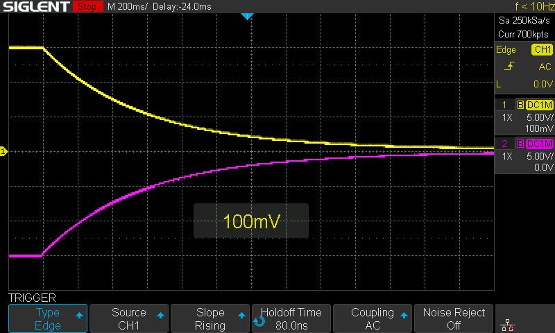

So in short, both rails have settled pretty much all the way by 200ms. If its of interest to other builders, I can post exactly what I used for all components. Huge thanks to all who gave me guidance here, @tombo56, @Trileru @Elvee - unless you think there is something else I should try, I am content to leave this as is for now. I attach a final scope shot here, vertical divisions 5V, 200ms on time base. I also include a shot of the shutdown, but bear in mind there is equal load (150mA) on both rails.
