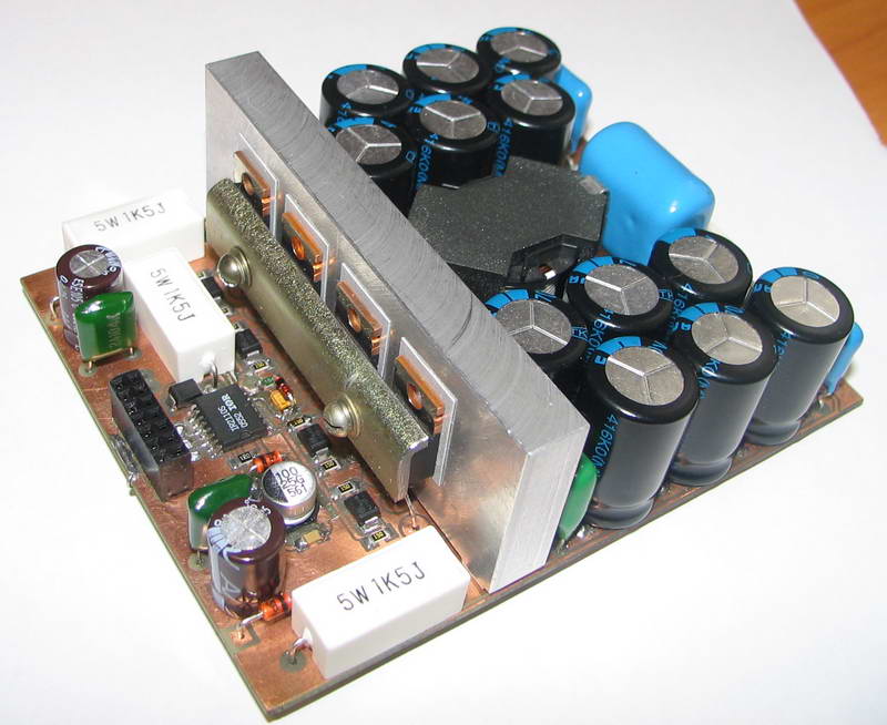

Hi, Luka.
I built this amp for subw, but it applicable for full range. It's only light (small power) version, now i assemble next version of this amp. Effeciency = 93..94%, you can easily calculate heating power.
My PS is classic 250W (~220V 50Hz) torroid with 20000uF capacitor per rail (48V*2 at idle), planned replace it with SMPS.

Hi alexclaire
If with no load doesn't count, I will have to out it on bigger supply, because eveytime there was bass, supply shut down. I think I have burned LM319 while testing current limit.
Why is that?Dangerous to push an amp to clipping without any load !
Because i need 90V per rail minimum, to get such power at 8Ohm load, in that case each of ballast resistors must dissipate ~2.4w..
With couple and 60V per rail, i can easily get 500w of continuous power, and ~900W of peak power at 8Ohm driver.
ps: one module provide ~500w at 4Ohm load, i think enough for home or car subwamp.
