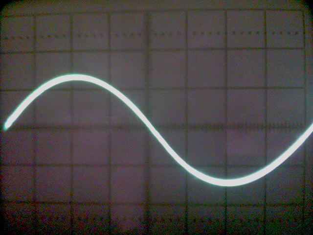

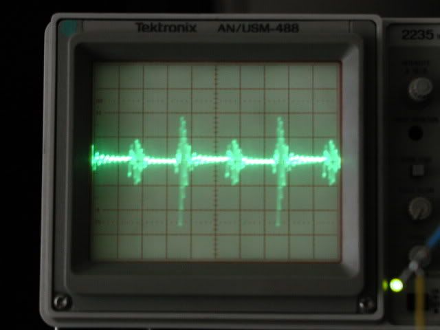

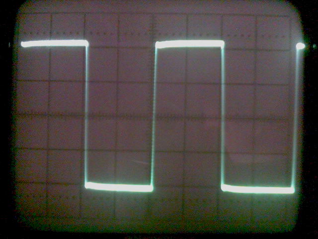

Here are some pic
This one is from output sine wave 250kHz, 0.5v/div, spikes because of poor decopling cap cross +/-Vcc, maybe aslo because of too big inductor, don't know the value of it.
And this one is from output also near clipping. 10v/div, with input on 1v/div (upper one). Amps supply is from car smps at +/-30v
Have no problems going into max clipping, so that output is squere wave
What do you think?
Hi luka !
Nice results...
The spikes you see on 250khz sine wave are due to dead time i think...
try to make it longer and you'll see these spikes disappear...
50Vpp at clipping that's it ?
so 78Wrms under 4 ohms load...
I got no problem till 60Vp so 450WRMS under 4 ohms...
at 60Vp got some ringing at the top of the sine wave.
i pushed it to 144Vpp so 650WRMS

Hi
Not jet. Tomorrow. When I said near clipping I did mean that one side of signal was near, not both (problem in generator), so there cant be normal clipping on top and bottom of signal. I should say that at this point I didn't had load connected. Reason for that is that I don't have right equipment (supply for amp). So for now I am limited to +/-30v one, but still with some mod in feedback I will raise it to +/-50v.
Dead time? I will look at this. But I don't think there in any throughshoots, because there is low consumption.
I have looked at this just now and I see 3A spikes on series resistors. This is indicating that there are throughshoots. How much should I increase resistors? They are 100 now.
