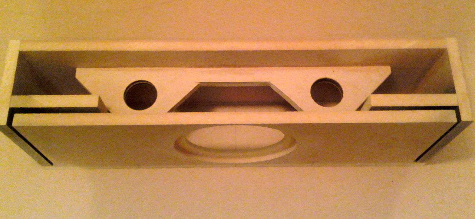

What if you didn't cut the chamfers at all? If you're using the speaker as a center on its side with a shelf below and a tv above there's gonna be reflections anyway. I guess the port lengths would be slightly longer but what other problems would this cause?
Well our thinking on this particular design was to keep the baffle width as narrow as possible - for both aesthetic and acoustic reasons - and that bevels are a lot easier to machine than very large radius round-overs.
Yes they could be eliminated, and in fact my own HT system's center channel ( Alpair 7) is wide / short with a slot port at each end - the tuning logic is similar to the "Prime" series, but the enclosure construction is much simpler - somewhat similar to .
No chempher or a roundover require some adjustment of the inside end of the vent to compensate for the otherwise increased vent length.

Hi there jb: Check out "Loudspeaker Design Cookbook" 7th ed, by Vance Dickason, page 106 &b107, and table 2.2 (FR), where baffle edge difraction is discussed. If you used a sphere, the variation is presented as 1.08db, 4-inch bevel 1.13, for rectangle corners 3.03.
....regards, Michael
