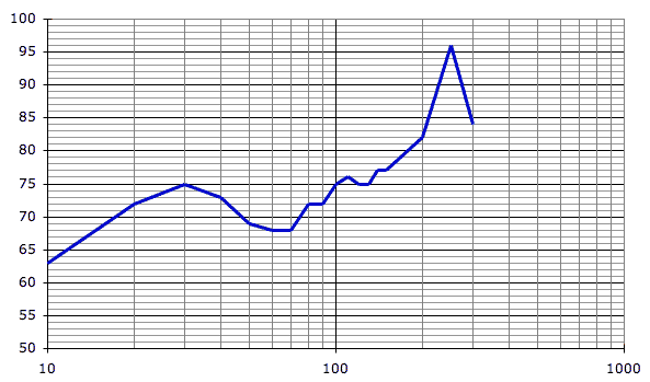

A quick check with my RS (non calibrated) digital db meter says;
Hz Db
10 63
20 72
30 75
40 73
50 69
60 68
70 68
80 72
90 72
100 75
110 76
120 75
130 75
140 77
150 77
200 82
250 96
300 94
The volume was set at dB with white noise playing ~1 meter away on a stand. Volume was not adjusted during testing.
As you can tell the Xover design sucks at lower freq. response.
But...the speaker cabinet design ROCKS! Capable of 75 dbs at 30 Hz! That says a lot about SM and P10s design and their experience in speaker design. Even that I can hear/measure 10hz is a miracle.
Does that answer your question?
Ron
Edit: These are premium component Xovers as designed by SEAS
I will be rebuilding the Xovers when I get a few bucks to play with
frugal-phile™
Joined 2001
Renron said:
Doesn't look so good on a graph......:xeye:
I may have to break into my piggy bank so I can buy the components to A/B the different Xovers.
Ron
Still, graph doesn't look good to me.?
Doing in room measurements are really hard below 200-300 Hz...and only valid for that room... and the RS meter is far from accurate, particularily the digital one (sure there are calibration cirves, but i'm pretty sure each meter needs a slightly different correction... )
besides, FR is only 1 dimension of a multi-dimensional space of speaker performance metrics (many of which we are as yet unable to measure -- or don't even know they exist)
It is the case that FR is one of the most accessible tools available to speaker designers so we often have the case of everything being treated like a nail.
dave
