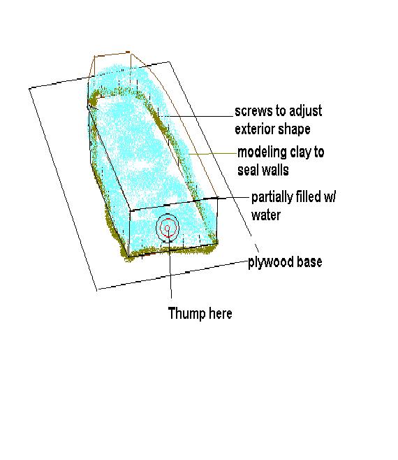

If the question was for me......
As I understand it, the curvature helps eliminate reflective back waves from exiting through the drivers.
I paterned several shapes, filled them with water, and observed how water ripples reacted when the waves encountered the curved walls. Think of milk jug cut in half and filled with water.
The shape that nulled the waves best was used. Sorry, no photos of the test were taken. (I forgot)
A plywood base with modeling clay was used to support the design templates, flexible plastic was used to simulate the curved walls.
Hope this helps,
Ron

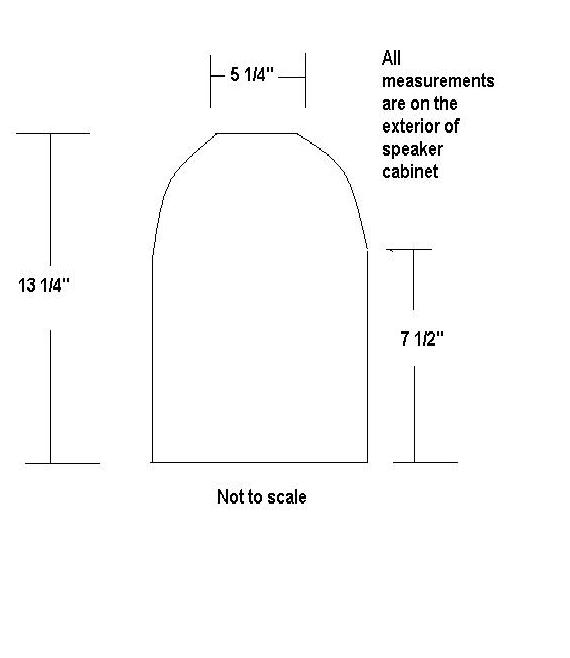

Peter,
My wife tells me I'm a man. :D
I have measured the speakers and have the dimensions below.
Doing it over again I would make them ~1" deeper. Making them closer to the Fat thor design. Baffle MUST stay the same!
Note: even though I used 2 layers of 3/8" plywood the acutal thickness of the walls is just over 1". all other measurments are taken directly from the small Thor plans by Scottmoose and Planet10.

So the baffle width is 9 inches right?
In making them deeper, would you extend the part that is not curved? I mean by that the first 7.5" from the front, extended to 8.5" ?
Not to sound ungrateful or very demanding, could yo trace the footprint of the speaker? Not sure the drawing can be accurate of the curvature used.... :)
Peter

Answers to above:
Yes,
Yes,
No,
I have a base that is larger than the exterior. I also plan on making a new base from granite. I have hardwood floors. It was not all that critical anyway. Just scetch a lay out on paper (folding the paper in 1/2 makes it symetrical and easy), trace to wood, cut template with jigsaw and see if you like the shape. It will be Very Very close. Try adjusting the rear (back) size to your liking.
That's quite ingenious - I never thought of that one.
I figured any curved shape would be better than a box, so I just made a lot of sketches, and chose the form that best fullfilled three criteria:
- pleasing to the eye,
- supported the required volume and height,
- supported the proper tapering of the TL.
