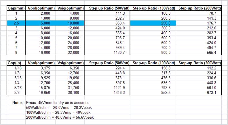

1) They choose to use cheap or readily available step-up transformers. Not everybody has the ability to design or $$$ to purchase an optimum transformer.
2) They are unable to achieve the bandwidth they want with a higher step-up ratio. Either limiting the HF due to parastics of leakage inductance and winding capacitance, or limiting the LF due to core saturation.

The Daytons needed high-U-trannies because of the large d/s spacing which led to a low capacitance, hence highish impedance level of the panels. The Quads 57 needed a lot of U to drive the resistors that should lead to a current drive of the panels. Because of their d/s being reasonably small the Quads needed much less U when voltage driven.
The same basically applies to the Quad 63 and its heirs. Its smallish d/s needed much lower values of U if it were voltage driven and if they omitted with the crude delay line and used resistor segmentation instead (the difference would be that the impedance value and as such the need for high U-trannies would decrease considerably).

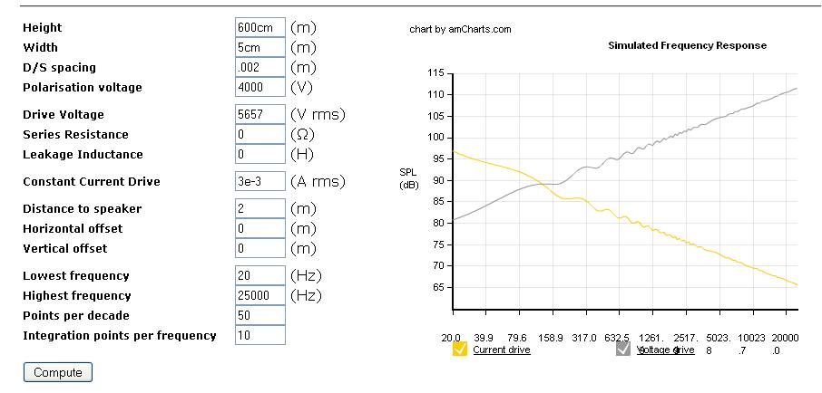

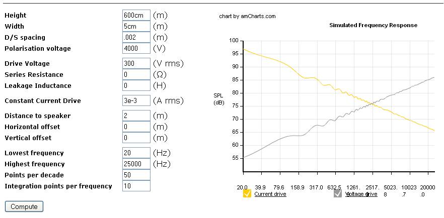

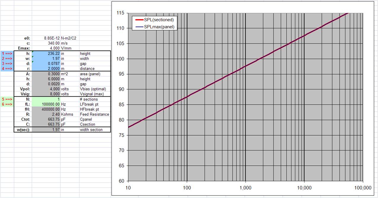

I will try to give a brief summary of what is involved as I understand it from reading the book Acoustics by Beranek.
The standard method used to calculate SPL from known driving Forces is to create an electrical circuit that is analogous to the mechanical and acoustic properties of the transducer you want to analyze. Force is replaced by voltage, mass by inductance, compliance by capacitance, damping by resistance. The actual values of the components can be calculated based on physical properties. Acoustic output is then proportional to current thru the real part of the radiation impedance.
For dynamic drivers some simplifications can be made because the moving mass of the driver dominates the other components in the circuit. For ESLs this is not the case. The dominate circuit components are those representing the radiation impedance which, as Calvin has pointed out, is a complex function of diaphragm size and shape which has no closed form solution. Also, this type of modeling does not take into account directivity as you go up in frequency and the wavelength gets smaller than the size of the ESL diaphragm.
For reference, I had posted some plots of radiation impedance for some diaphragm shapes in another thread you had started.
http://www.diyaudio.com/forums/planars-exotics/175067-no0b-esl-size-question.html#post2327517
“The easy way”

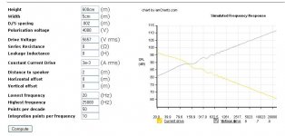

In post#8 of this thread kavermei already posted a link to an SPL calculator for ESLs. Some people questioned its validity, but I have found that when used with proper inputs and understanding it’s limitations it gives accurate results. It is based on “The Walker Equation” that Peter Walker developed using something called the reciprocity principle which completely side-steps all the complications mentioned above. If interested, the complete derivation can be found in Section 3.3.2 of the Baxandall paper.
As a sanity check of the online calculator, I compared the results for a 5cm wide line source with those calculated using the line source spreadsheet I had posted here:
http://www.diyaudio.com/forums/planars-exotics/48120-experiences-esl-directivity-9.html#post2218526
See Attachment 1) & 2) for comparison. The agreement is quite good, both in SPL magnitude and in the expected 3dB/octave slope for an ESL line source. I know several posters mentioned never having seen measurements like this before. I have seen measurements like this many times. I am away from home on business right now, but happen to have a print out of a measurement I took last year of a 2" wide ESL line source. I have scanned it in as Attachment 3). The 3dB/octave slope is evident. The SPL magnitude is not shown in the measurement, but it did agreed within 2dB of the calculated values. I consider this pretty good agreement considering that the voltage loss in the stator insulation is not accounted for in the Walker Equation.
If you are interested in what the standard sensitivity would be for 2.83Vrms(1Watt/8ohm) change the Drive Voltage to 2.83 x (step-up ratio). See Attachment 4) for the SPL of the ESL line source from Attachment 1) driven with 300Vrms. Obviously the response still has the 3dB/octave slope which you will need to equalize out. So, the SPL “rating” for 2.83Vrms input will depend on how low you want to crossover your ESL. For example, if you wanted to cross over ~600Hz, your dB/2.83V = 70dB. This low value gives you an idea why it is generally advisable to make your ESL as large as possible. Each time you double the width of the line source, you increase this value by 6dB. Of course making your ESL wide reduces the dispersion of high frequencies which is generally not a desirable thing, although some people like it.
I hope this quick summary helped rather than adding confusion.

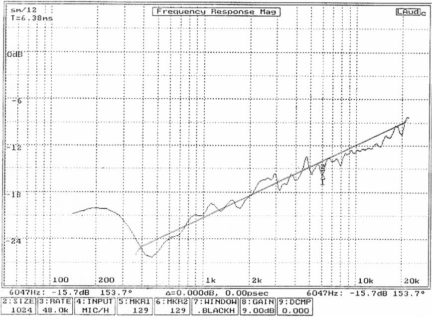

The measurement I posted was taken using a HV reference probe to remove any influence of amplifier and/or transformer response.
The far-field native response of all unbaffled dipole ESLs is a rising response with increasing frequency. (+6dB/octave for point source, +3dB/octave for line source)
Anytime you see a flat ESL response, there is some equalization involved(intentional or not):
- curved ESLs spread out the highs rather than focus them flattening the high frequency response
- mass of diaphragm can flatten the HF response
- mass of air in stator holes can flatten the HF response
- any series resistance in primary or secondary circuit changes constant voltage drive to constant current and flattens the response
- any segmentation and ladder resistor network adds area with decreasing frequency to flatten the response
- leakage inductance of transformer flattens HF response
- boosting of LF response with underdamped HP filters can flatten the mid and LF response
- baffling around the edges of the ESL can flatten the mid and LF response
Also, many times measurements are not taken far enough away to be in the far-field.
As was mentioned earlier in this thread, near field response of ESL is flat.
It may help to think of the SPL response from the simulation as the maximum possible output .vs. frequency.
The desired response will be the loudest flat line you can fit underneath this maximum curve dependent on your crossover frequency.
Bolserst, those are very interesting measurements, and remarkably close to the Walker equation. Thanks!
Markus, a crucial thing here is that these measurements were made without accounting for the influence of the transformer -- this might explain why you've not seen these frequency responses before.
Thankfully, an ESL panel has a rising frequency response! Many of the practicalities bolserst lists in the previous post tend to have some HF loss and therefore (at least partially) equalize it out. Imagine if ESL panels had a 3dB/oct *drop* in response, we would have been in a lot more trouble.

I have not had the chance to inspect or measure a Quad 63. But, from the circuit diaphragm and details mentioned in Baxandall’s ESL paper I am confused by your comment about the step-up ratio(U) of the transformers being unnecessarily high because of the delay lines. The D/S spacing is 2.5mm. The step-up ratio(U) is 245 and Vpol = 5.25kV. This seems to fit in pretty well with the optimum values calculated by Baxandall assuming a breakdown voltage for dry air of Emax = 4kV/mm. See attached table which summarizes required optimum Vpol & Vsig for different D/S spacing. I also added columns to show the required transformer step-up ratio(U) required to obtain Vsig for amplifier outputs of 50W/8ohm, 100W/8ohm, & 200W/8ohm.
I highlight the Quad 63 values in blue. Note that it was designed for a maximum recommended input voltage of 40Vpeak = 28.3Vrms = 100W/8ohm.
Looking at this table you can also get a feel for how quickly Vsig and setup-up ratio(U) quickly gets out of hand if D/S spacing larger than a few mm is used.
I understand that if you removed the delay lines and ladder resistors the panel would be louder in the midrange, but those components are used to EQ the response flat. So, I guess you could use a smaller step-up ratio(U) transformer to get the same midrange SPL level if the delay lines and ladder resistors were removed. But, the high step-up ratio(U) is needed to provide the maximum possible SPL at low frequencies(<100Hz) where the delay lines and resistors aren’t really influencing the response. At least that is the way I understand it.
the breakdown voltage of air is at best 2kV/mm, a safe value beeing ~1.5kV/mm, which roughly corresponds to 1kVrms/mm of signal voltage.
