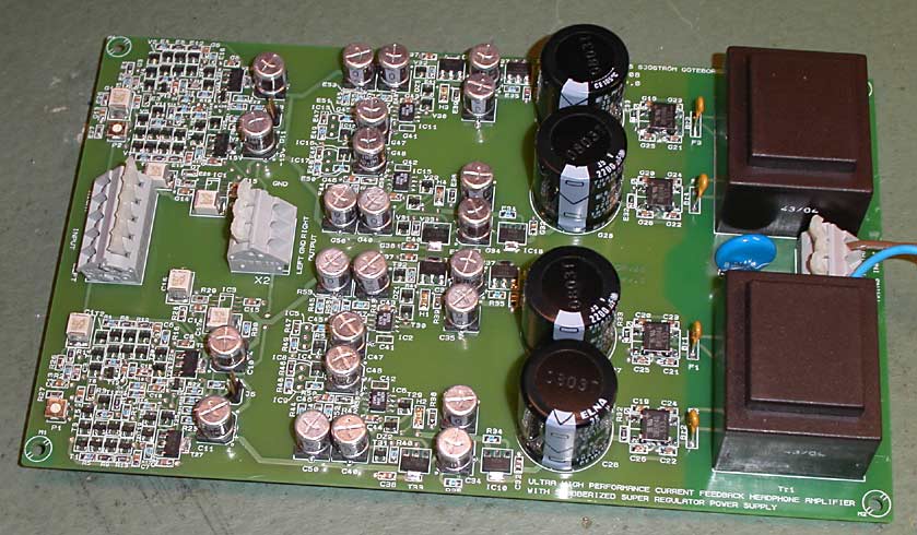

I can't wait to test the amp. It's cleaned, looks nice, not smoking, the LED's are emitting red light.... I wonder if janneman's theory in his sig will be comfirmed? I have made a TPA6120 current feedback amp which I really like but this discrete amp will I probably like more despite less good performance. It's hard to beat 1300 V/us with discrete parts for a couple of cents. The unique thing is that noone has made this combination before and certainly not with super regulators.
Is it possible to build? Yes, only if you are extremely thourough. Put all parts in the right places only. I succeeded with this but it's easier for me since I "know" the pcb. The amp is really tight and the designators are really small so you must be very carefull when you mount parts.
Anyway, you should see it built.
I'll hope I can test it next week.

It's alive now and it worked right away, nothing added, removed or trimmed.
Pure discrete current feedback fed from a dual mono supply with quadruple super regulators. This is the first discrete SMD current feedback headphone amp in the world! and also the first headphone amp with integrated super regulators.
I'm very pleased and also happy and it's a good way of ending this day.
How does it sound? I'm quite happy with the results.

A better picture
I have taken a better picture.
peranders said:A picture.... what do you think?

It looks very nice, Peranders
