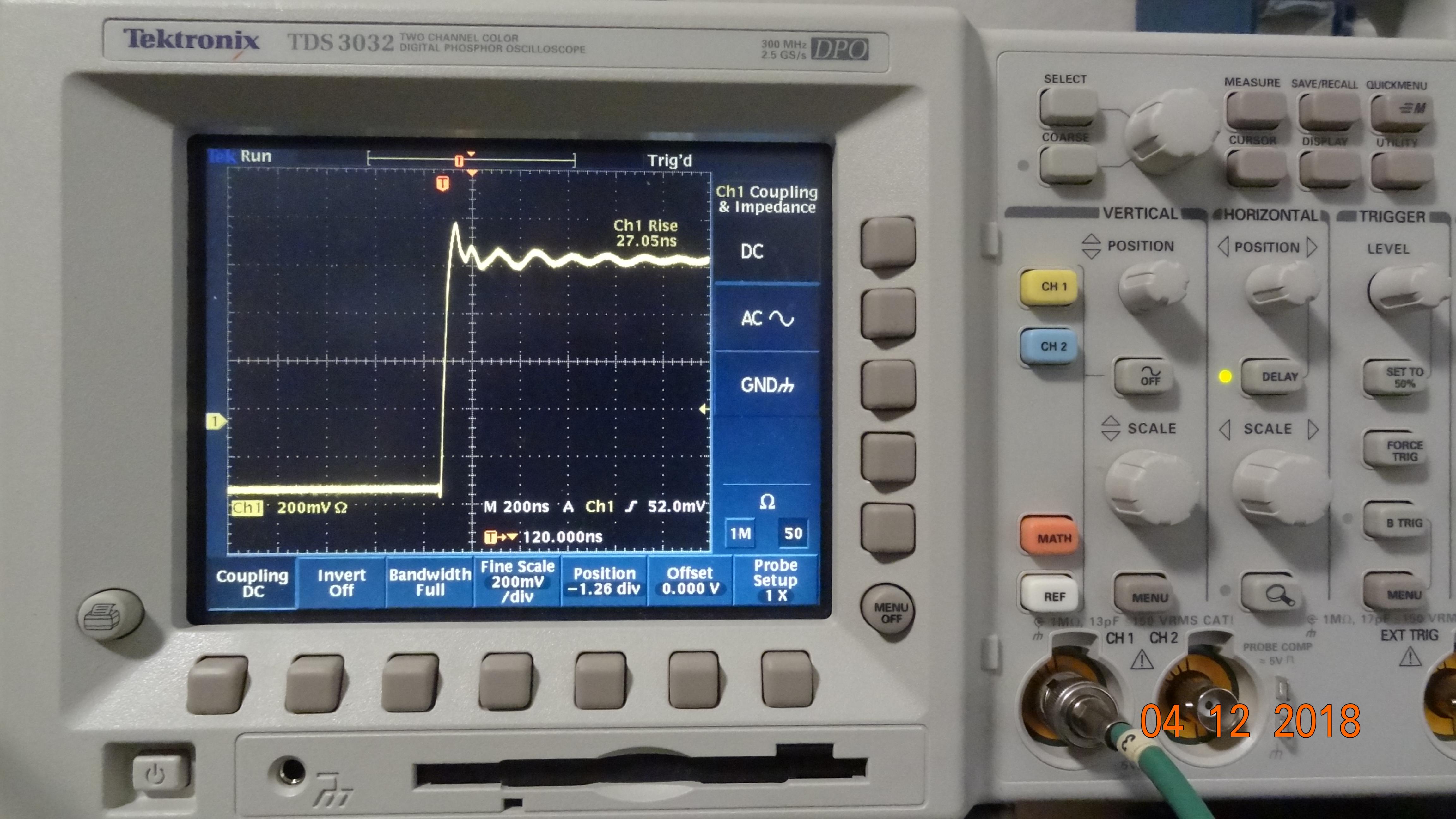

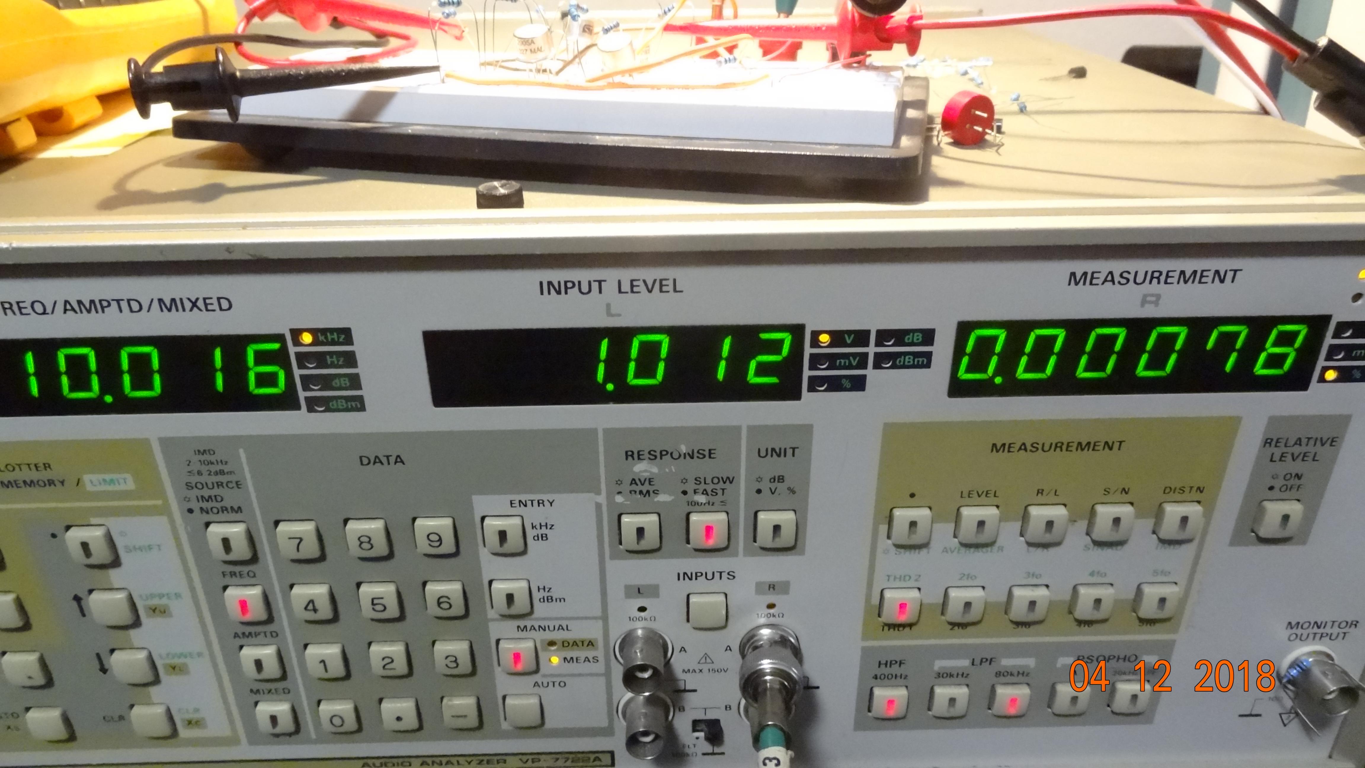

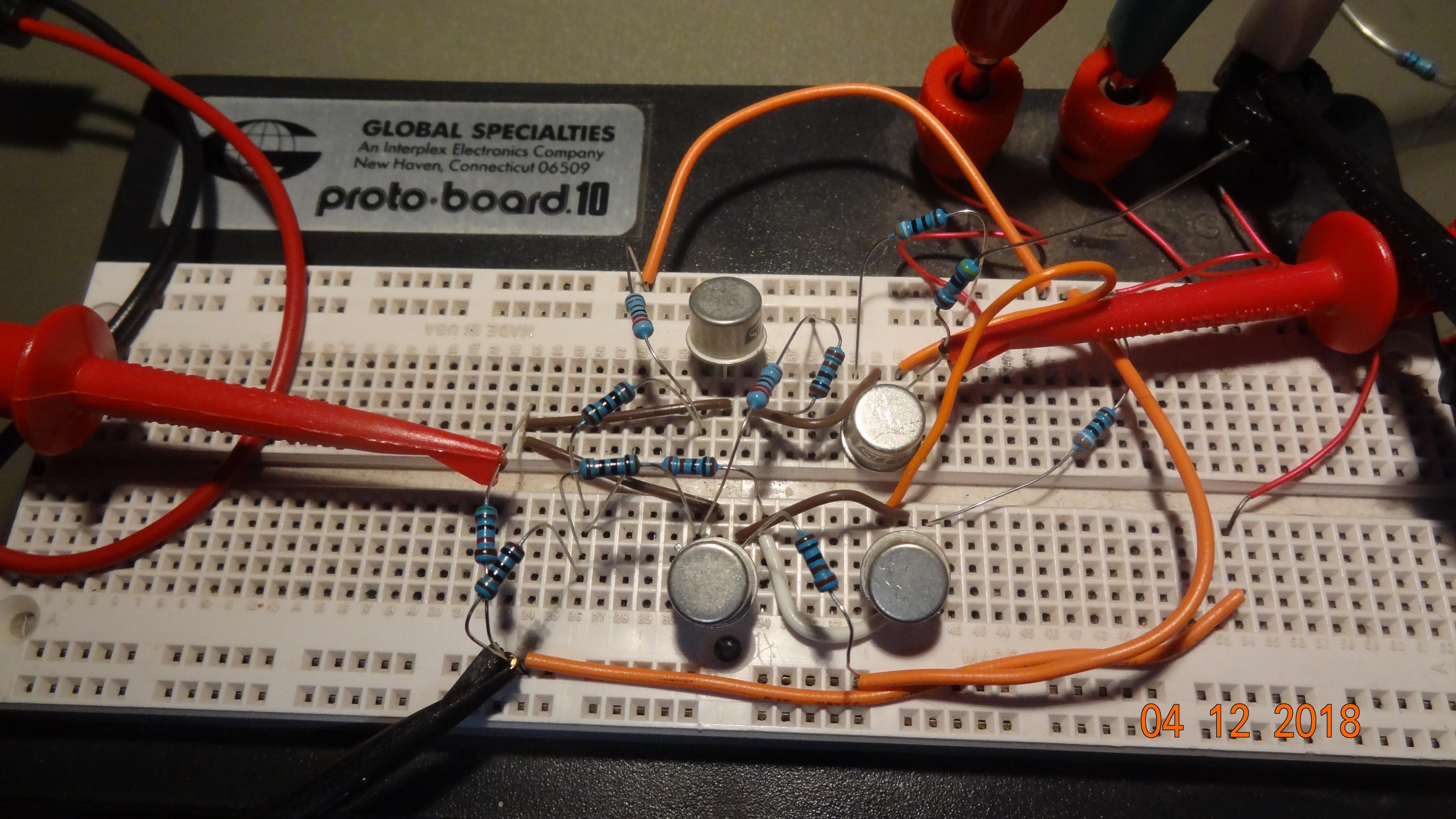

Today, I bread-boarded the original circuit using only the 4 transistors. (note the OLG is not high). I did not select the transistors at all. They are general purpose 2N2219A and 2N2905A.
Do a transistor match and you can add another zero to the THD at 10KHz.
Note- Tr driving 50 Ohm load and this is with lots of stray L and C from wiring. if we used a nice ground plane and smd we would be right at the max freq of the transistors.
When you change the Rf/Rg, it exhibits all the characteristic of a CMA..... Note that there was no name for this circuit characteristic when I developed it. I called it a symmetrical push-pull compound complimentary amplifier.

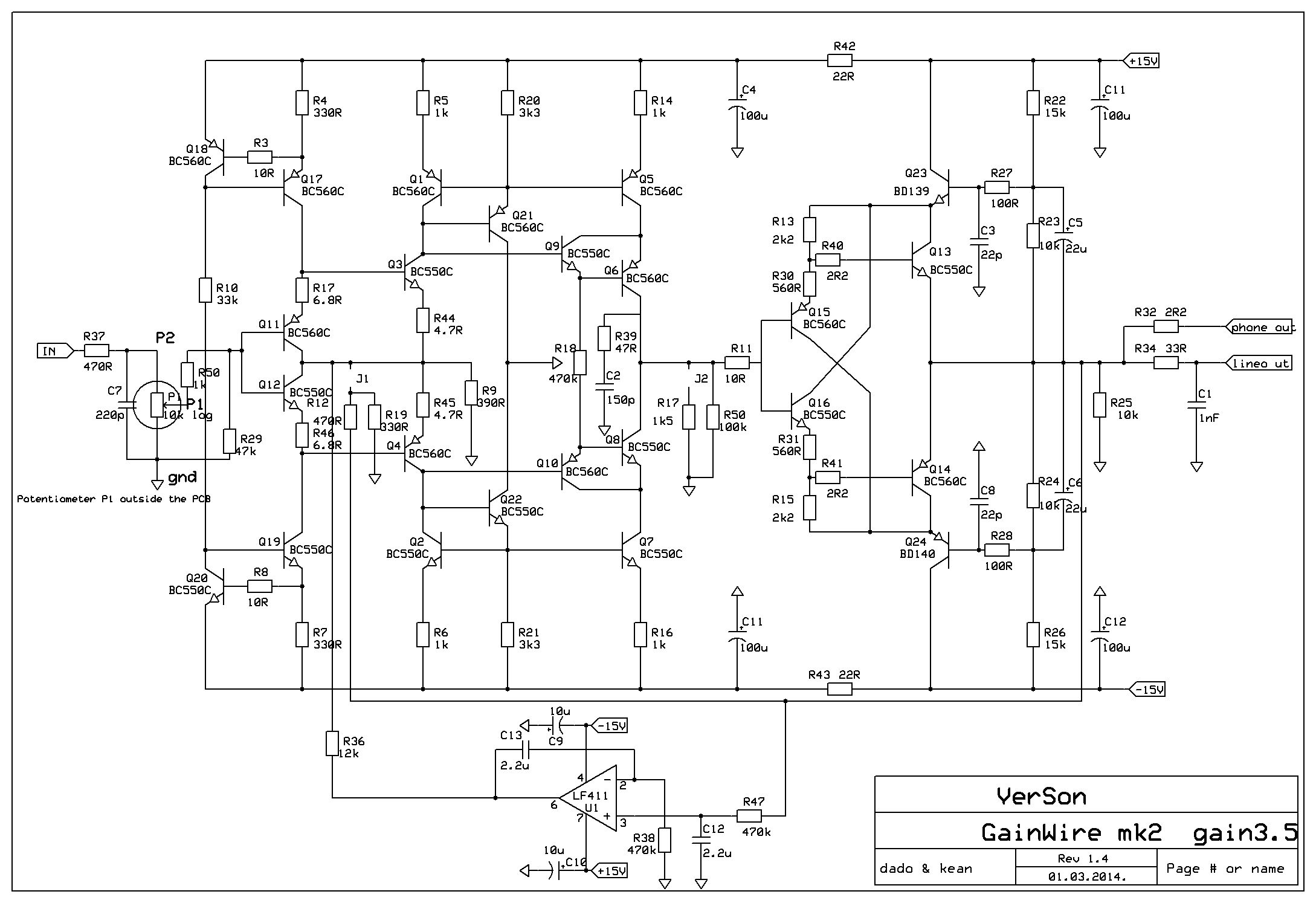

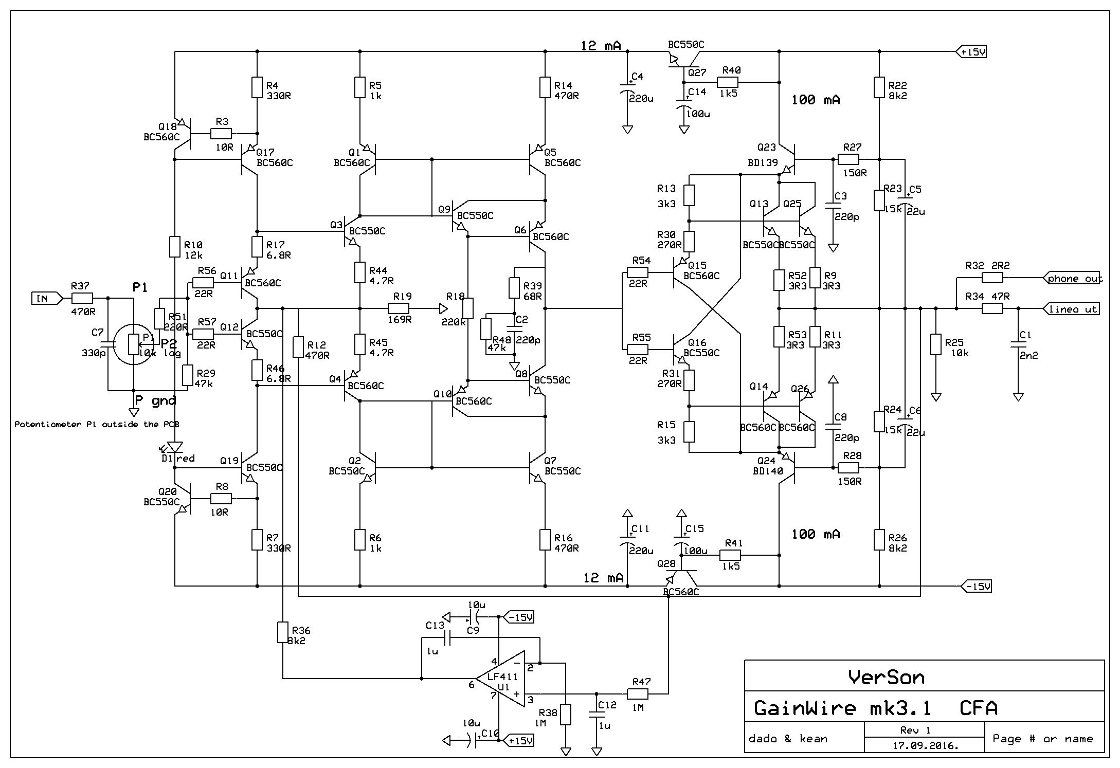

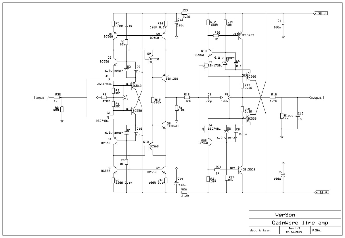

I designed and built three CFA line/phone preamps, GainWire (2013), Gainwire mk2 (2014 switchable CFA or non GNFB) and GainWire mk3 (2016 CFA, built balanced version).
Damir
