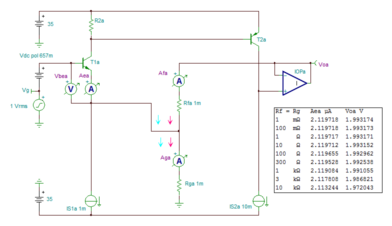

The question I asked to myself today :
can we still speak of a CFA when the impedance the feedback network is hugely smaller than the impedance of the inverting output ?
Amperes being free in simulation, it's easy to see what happens when resistors Rf and Rg, made equal here, vary from 1 mΩ ot 10 kΩ. Result : the current of the at the inverting input changes of 0.3% only.
The output impedance of T1 at 1 mA is about 25 Ohm.
The arrows indicate the phase of the currents.

Chris,
Thanks for having taken the trouble to come with this calculation.
Hans

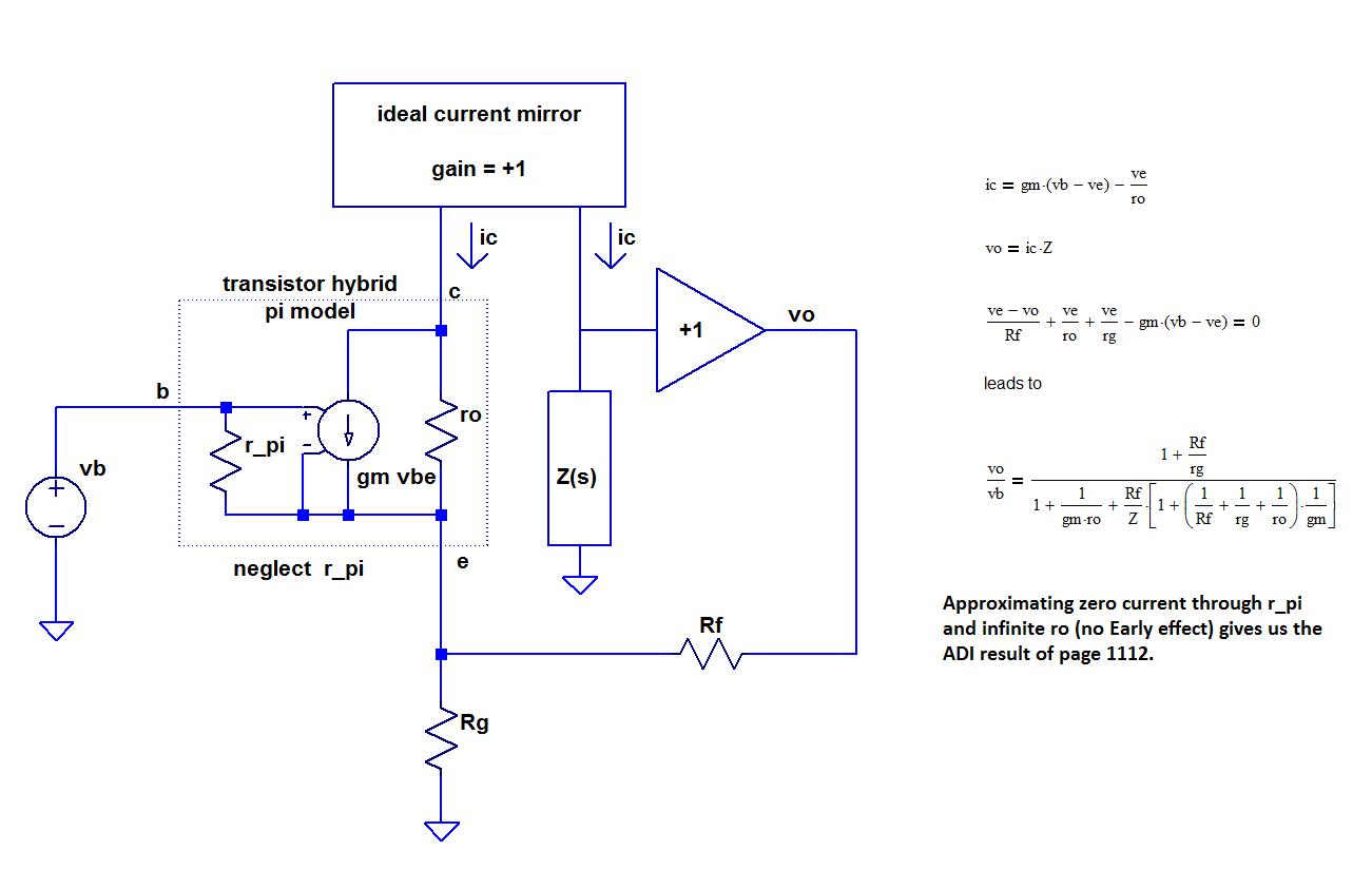

Here is an extension of the derivation of the importance of ro in the CFA input transistors. Referencing the schematic in Post 1160, I developed the ratio of the current due to transconductance to that of the Early Effect. If we assume that the transistors implementing Z(s) are similar to the input transistors responsible for ro, we find that at frequencies below those at which Z is noticeably capacitive, the ratio is approximately 2 + Rf/Rg. That's almost exactly the simulation result.

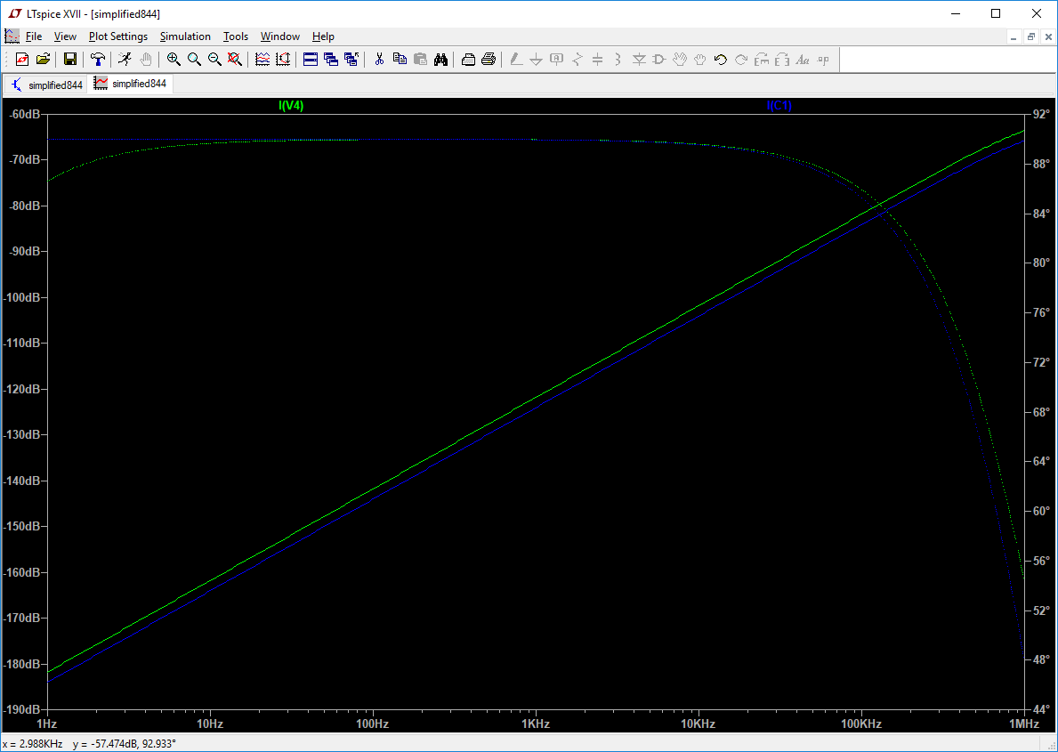

I spent (hopefully not wasted) my time this morning making a little sim. This is the simplified CFA circuit very similar to the one on the AD844 datasheet, made with BC550 and BC560 transistors (because I just moved stuff around on something else I was working on). This does not really matter.
Scott, thank you for the simulation file. From my point of view, you certainly haven't wasted your time. The Wilson current sources make the resistive portion of T(s) truly enormous!
I know that you are not fond of looking at things this way, but here goes.
I modified your file for time domain operation at 1kHz (attached, adding the Bob Cordell file it requires. Its .txt extension must be modified to .inc). The approximate transconductance of Q6 is 1mA / 26mV, whose reciprocal is 38 ohms. But the measured ratio of 1kHz AC signals vbe6 / ic6 is 432 ohms!
The reason for this is explained in the attached derivation where it is seen that the ratio of the transconductance to Early currents is 1 + ( 1 + Rf / Rg ) · ro / (Rf + Z). Here, Z is the ground-referenced impedance at the junction of Q14 and Q16, and ro is the small signal Hybrid model Early resistor between Q6’s emitter and collector. For this simulation, Rf is R1 and Rg is infinity.
At 1kHz in your sim, Z >> ro and so the current ratio is only a little greater than unity. Because the currents subtract, we have the rather large 432 ohm vbe6 / ic6.
The point of all of this is solely to point out that describing the CFA as having only voltage-driven tranconductance feedback is clearly flawed. Nothing more is intended from this demonstration.

At audio frequencies, ic is a function of both vbe and vce, as even Ebers-Moll makes clear. The single transistor simulation of Post 1028 also demonstrates this. I have little doubt that a simulation of the transistor you used in your sim would show the same.
The sim model you sent me shows that ic/vbe is quite different from the transconductance IC q / (k T). Application of the small signal Hybrid Pi model explains why. I do not understand your objection to this demonstration.
Cascode the input devices and the current mirror outputs with JFET's now there is no change in Vce and the plot extends to virtually DC.
