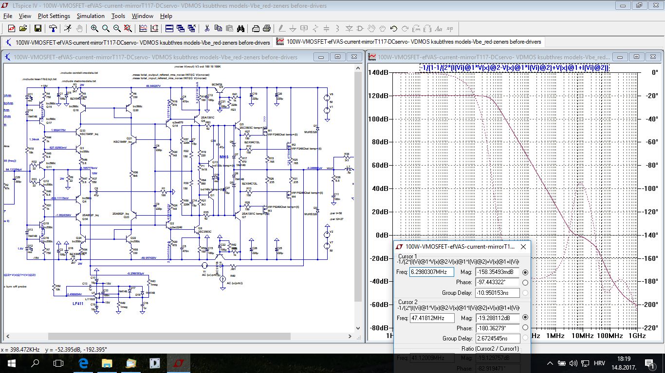

way you don't comment simulation I attached in post #23 instead?
That chart doesn't prove a thing. The slope is 40dB/decade and there's a hodgepodge of poles and zeroes around the ULGF that are (hopefully) bringing the phase back to where it should be for stability. That's not something that any same engineer would do, for anything but a simulation exercise.
You also did not indicate what you represented in the chart (is this the loop gain? if so, an LF open loop gain (as loop gain plus closed loop gain) of ~150dB is yet another insane thing to consider in practice).
You also did not indicate how you modified the closed loop gain, was this by changing the feedback resistor? If so, something is definitely wrong with your simulation, since a 28dB closed loop gain means a feedback resistor x25 the inverting input to the ground resistor. Since the inverting input is loaded by the two resistors in parallel, there's no way the OLG and it's intercept could be modulated by the amount shown, the variation is only about 4%. Anything else could be due to some second order effects, that you don't manage and I don't care about, as long as they are not included in an analytic model.
You pushed me before with this amp, and your claim of stability doesn't tell me diddly squat. As long as you can't explain how your creation is working other than by some global feedback loop simulation, it is in my book nothing but yet another design by simulation, in the absence of any certified device models.
Even so, if it comes to a pure simulation war, I've shown you a pure Lin topology VFA with the same HF double pole and phase correction, with about the same loop gain and ULGF, and about half the number of components. I would not touch a PCB with such an amp with a ten foot pole, though.
Damir, a PA is designed (usually) for a desired gain depending on your system choices, so it is not fair in this case to simply vary feedback network but re-compensation at each gain must be on the table.
General purpose IC's don't (except in rare cases) have all the necessary handles. What would you have us do, call them all op-amps and tell the customer you figure it out? I almost guarantee taking a basic CFA and converting it to the so-called H-bridge VFA can (if you are allowed to change everything) be configured to be essentially indistinguishable from each other (save input current/noise).
I did this for a customer who wanted for some reason to use very large resistors in the feedback network in an ADSL driver, all distortion/BW specs were easily made.
I presented that simulation to show how, I will repeat again, this your statement is not correct:
"- Mr. Jung talks about the "relative constant closed loop bandwidth, regardless of the closed loop gain" which is again correct, but is once again the property of a particular circuit topology (which could be also called "diamond buffer input stage topology" instead of "CFA", but which would be of course way to complex for the marketing departments). It would be also correct and relevant to add "for a certain range of closed loop bandwidths". The property holds indeed for closed loop gains of, say, 0...12dB but no longer holds significantly for closed loop gains of, say, 30...40dB."
I attached full schematic now I used in previous simulation, IPS uses active load (current mirrors) instead resistive load to show how relative constant closed loop bandwidth, regardless of the closed loop gain holds even for closed loop gains of 30..40dB. That was simulated in my previous post. It was Loop Gain of course.
I did not build this amp, just version with resistive load, where the LP is around 80dB, not insane high as you said, and that amp was built in some quantity by different people here from this forum with no stability problem and as some of them said with excellent sound.
In my opinion even that amp with insane open loop gain will be stable in real life, but I decided I don't need to complicate to much to get good CFA power amp.
By the way I don't care any more if you don't care!
Sorry I did not read Scott post before I sent mine. This amp was designed foe 28dB of CLG.
It is correct, as you can easily verify on an elementary example (like a CFA opamp). Mr. Wurcer just explained where you are fudging the stuff (me never thought about).
