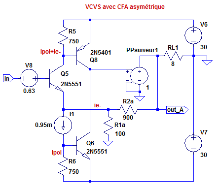

The attachment shows a circuit that JM Plantefève proposed. It is a single polarity version of the topology currently called CFA and is extremly explicit.
If you see Q5 as common-base in this design, it can also be seen as playing the roles of an emitter-follower and of a common-emitter with emitter-degeneration.
However, I am always a bit reticent to firmly name the configuration of transistors as it often happens to be a combination of two or three configurations.
Anyway, what is indisputable, is that the collector current is driven by the base-emitter voltage. Looking at how the base voltage and the emitter voltage are built is the best starting point for analysing linear circuits such as those considered in this thread.

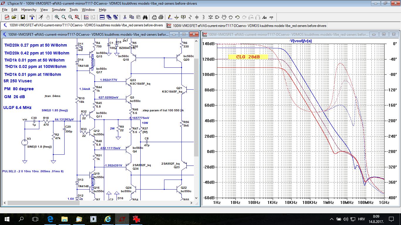

I don't understand why you are against "CFA" used in audio output amplifiers.
From attachment you can see that you are wrong in both of your above statements, relative constant closed loop bandwidth, regardless of the closed loop gain not holds for CLG from 30 to 40 dB, and not possible very low distortion. You would say it's simulated, but even ten times worst still very good result.

Dear Waly, when you don't have technical argument you go on personal attack.
How I can understand this, if not that CFA is no suitable for audio. You did not say output amplifier, but 20..30 dB gain.
"I absolutely agree with MK that the CFA topology is simply moot when it comes to audio, it is just another buzzword. Set aside that only a few years ago, the CFA topology was chastised right here on DIYAudio as having a "horrible screechy sound", the usual high closed loop gain required in audio amplifier (20-30dB) makes any CFA topology advantages blur away, while the high slew rate (as a result of the current on demand property) is simply useless."
I never spoke about magical CFA property, and this is jus hobby for me. If I sell some printed boards it's just to cover some of my hobby expenses, here in Croatia we don't have big salaries or retired income.
BR Damir
way you don't comment simulation I attached in post #23 instead?
