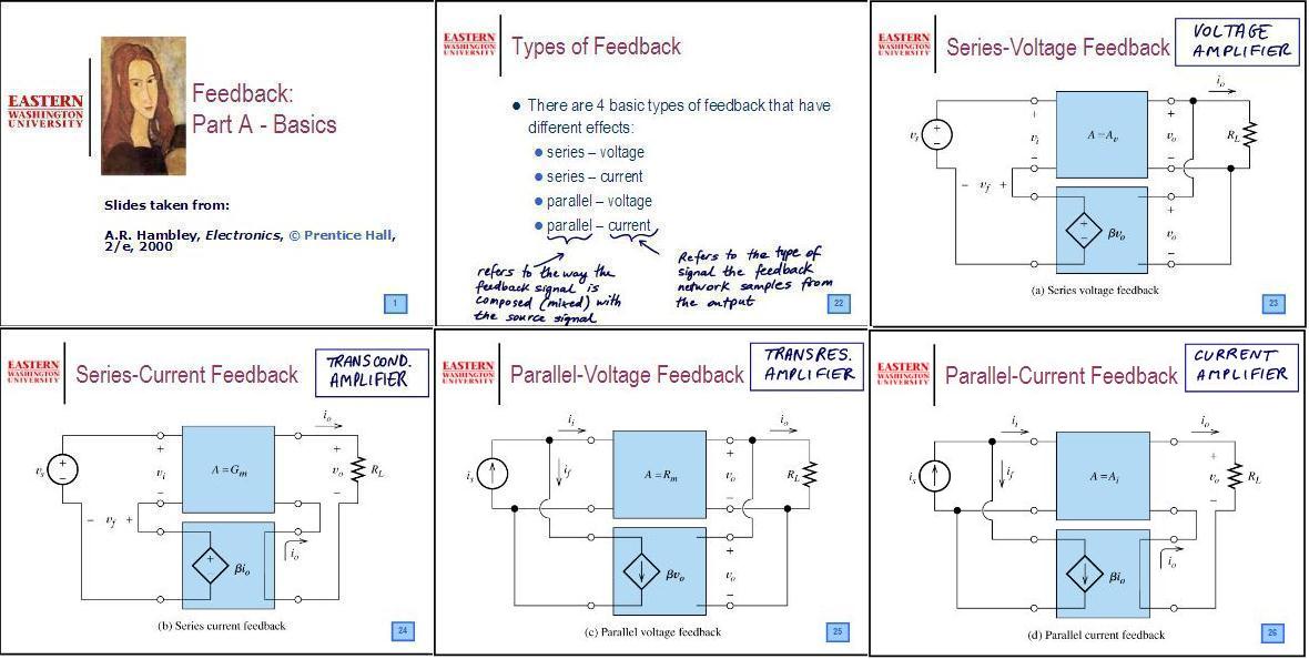

I believe the the difference between VFA and CFA is down to passive or active V to I conversion CFA over a resistor pair VFA over bjt or jfet devices. Circuits like the old (relative) Hiraga Class A fits the CFA. Some may argue tha voltage out also implies voltage feeedback. But I believe we need to accept that CFA is a circuit concept rather than a current to current feedback

The wrongly named CFB is PVF !

No boobs on your picture. It does not count.
