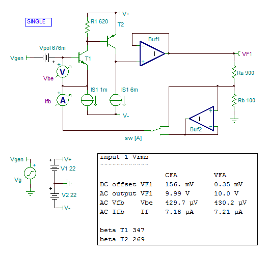

Current Feedback Amplifiers, not only a semantic problem?
The current mirror does not belong to the input stage.
It is only a load for the current output by the input stage in most CF-opamps, but it is absolutely not mandatory.
It is your opinion.
The base is the non-inverting input.
This emitter is the inverting input which receives the feedback signal, not the signal of the source.
Simulation shows that buffering the signal from the feedback network, just like it happens with a long tail pair input stage, makes the circuit an indisputable VFA. You can see that it has very little effects on the current and the voltage involved in the feedback signals around the device in charge of the subtraction process.
To summarize, a VFA tends to look like a buffered CFA, if we admit that these acronyms have any meaning.
631193d1503252019-current-feedback-amplifiers-semantic-amp_nocfa-7-single-png

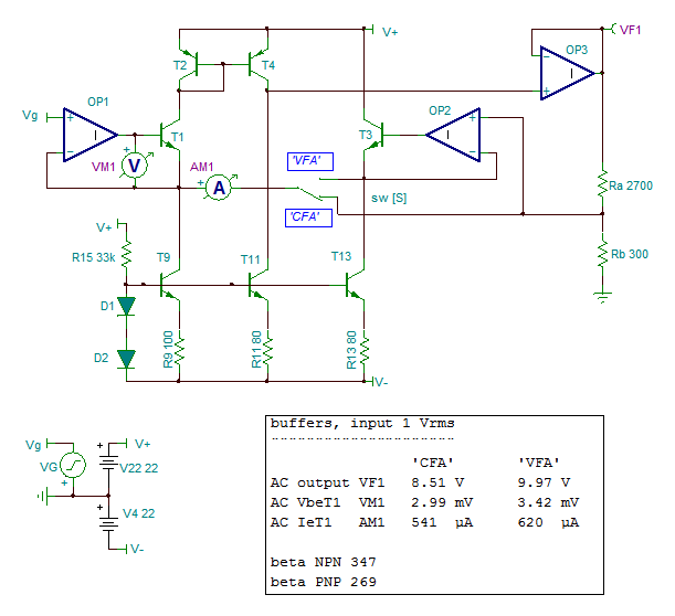

The non-inverting input of a VFA has a high impedance.
The non-inverting input of a CFA has a high impedance.
The inverting input of a VFA has a high impedance.
The inverting input of a CFA has a low impedance so it is often considered as current input rather than a voltage input.
With the adjuvant of some extra circuitry to the concerned devices, these impedances can be made almost infinite for all the non-inverting inputs or almost null for the inverting output of the CFA.
The extra circuit can consist in the introduction of a local negative feedback circuit including the input devices. It is an op-amp on my simulation of today.
Compared with my yesterday schematics, the buffer of the feedback divider in the VFA configuration has now a transistor which makes familiar the look of the whole amplifier as it has a real differential input stage now.
Comments on voltage and current differences between the configurations and their names are wellcome.
attachment.php

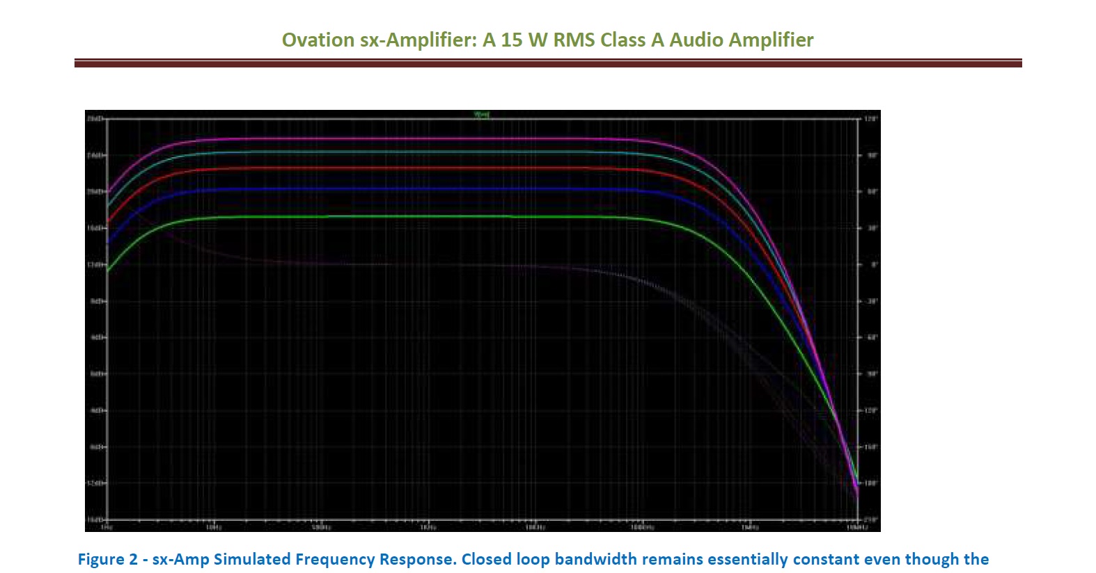

"People that are quoting a chart that is illegible and that do not explicitly show the supporting data."
Which chart?
"Plus that I guess you missed my post here: Current Feedback Amplifiers, not only a semantic problem ? "
Which simulations? Any simulation is exactly that - a simulation - and is designed to explore circuit behaviour. I would think it only becomes 'toxic' when people either don't build the right circuit to prove or disprove their point, or as in the case elsewhere, refuse to accept any point of view that is contrary to theirs. This then is no longer about engineering but about belief systems. Truly pseudo science.
Of course, you could always ask the author of the simulation circuit to share their file with you.
forr,I am still struggling: You modify a circuit in which one of the defining characteristics is a low impedance input current port fed usually by a suitably scaled (low value) resistor.
Have you noticed that there are two configurations on my schematics ?
One of them is the purest CFA you can imagine, as its inverting input has a null impedance, null impedance on which rely the reasonnings of CFA with diamond input stage which have certainly not a null impedance, less than 50 Ohm says Texas Instruments
then claim that the new circuit proves CFA=VFA.
No such claims because they are full circuits, A meaning Amplifiers.
My investigation is only concentrated on the feedback subtraction process, which is similar in both configurations and manages with voltages only (possibly issued from currents across impedances).
It is obviously not clear to every body that I am not treating differences between CFAs and VFAs which are complete circuits.
Got it, so simulations are never wrong, and if you have some simulation results you no longer need a brain to cross check, validate and interpret the results. Your problems with elementary logic transcend the lack of basic EE understanding.
Point in case, the chart in your sx amp description on your web site, which is illegible, and does not have anyway enough data to support your statement. The closed loop bandwidth do vary over that closed loop range (18-26dB), and would be even more to 30dB (not shown) but check the same in the 6-10dB closed loop gain. There, it is indeed invariant. Please plot the 3dB closed loop bandwidth vs. the closed loop gain, and check out how it converges toward the VFA 6dB/octave behavior (or CLG*BW=constant) as the closed loop gain increases.

The BW at 40.7 dB gain is 358 kHz and at 11.6 dB 548 kHz. At 30 dB is 446 kHz.
This amplifier is clearly not constant GBW over the typical audio application gains.
The chart in the write up is perfectly legible - your monitor is the issue, or zoom inf you are using a iPad - the numbers are there.
Please note the chart title: Figure 2 - sx-Amp Simulated Frequency Response. Closed loop bandwidth remains essentially constant even though the closed loop gain is changed from 18 dB to 26 dB, a feature of the CFA topology.
I suppose we could not agree even on the color of the sky. A little free advertising:
