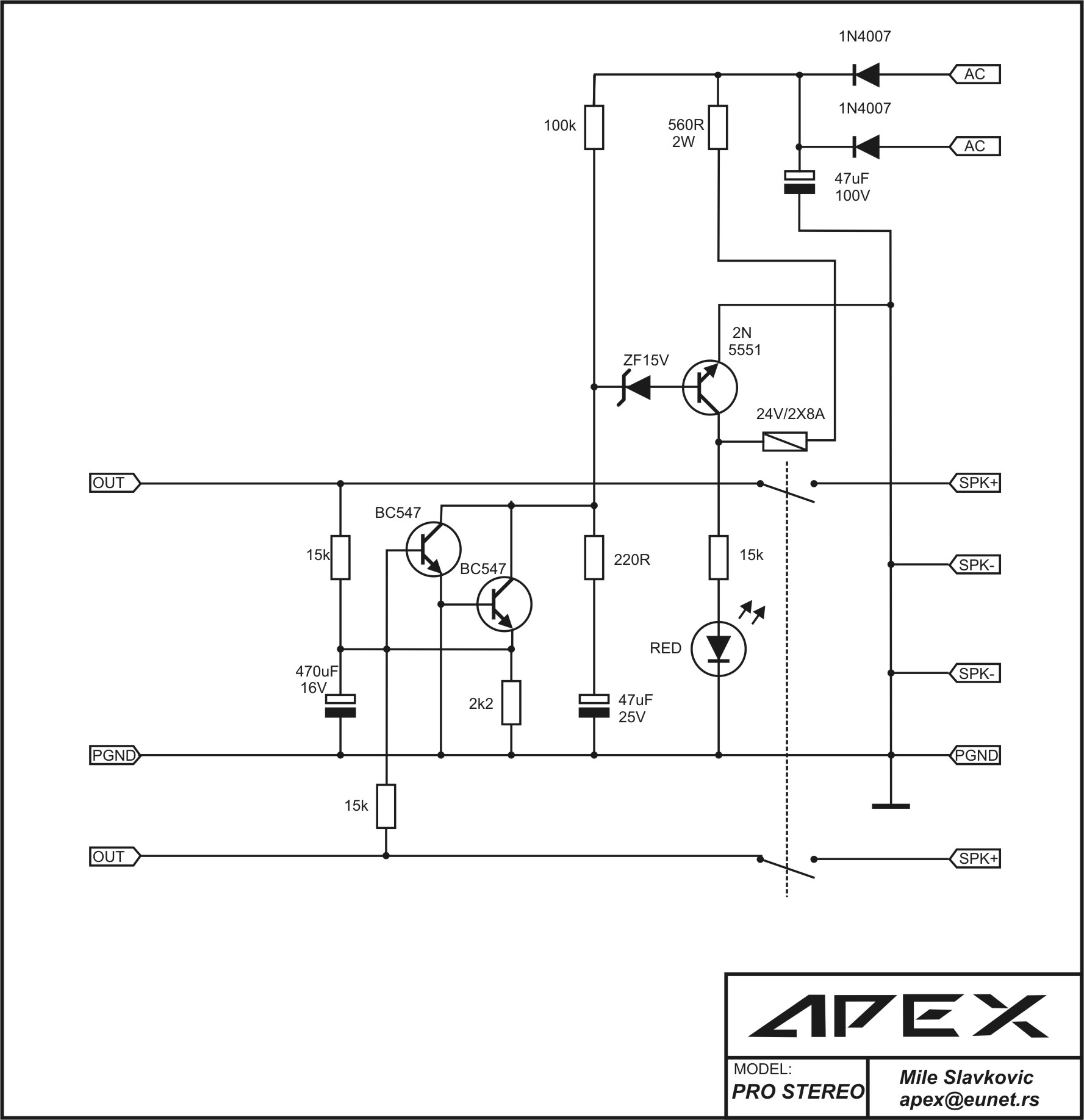

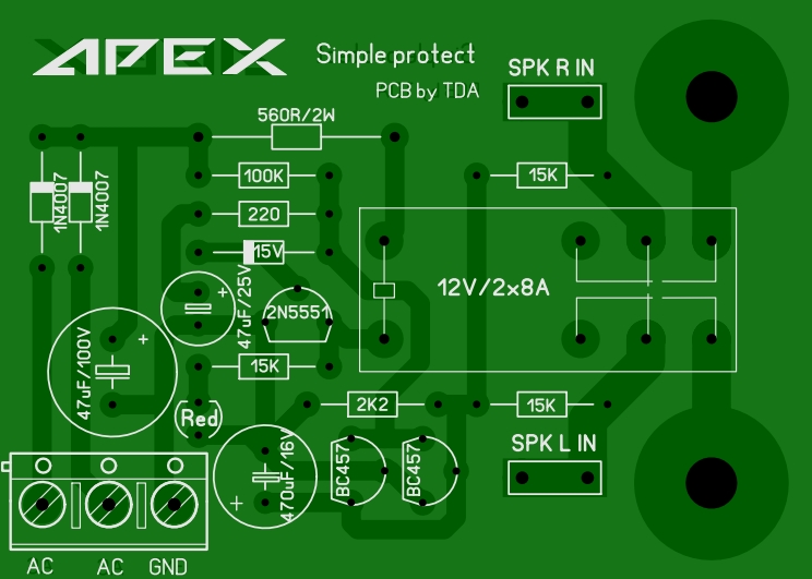

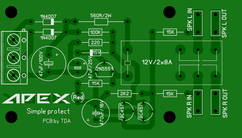

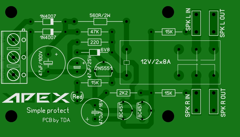

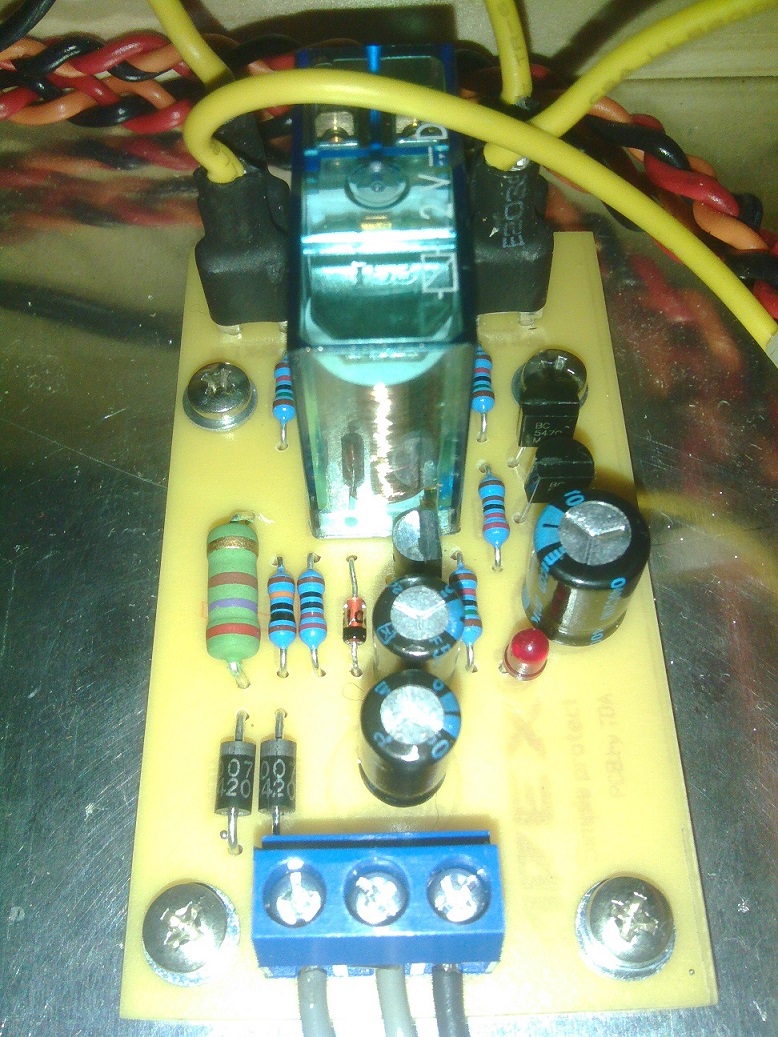

This protect is simple and work nice.

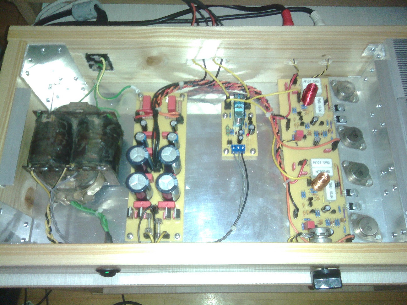

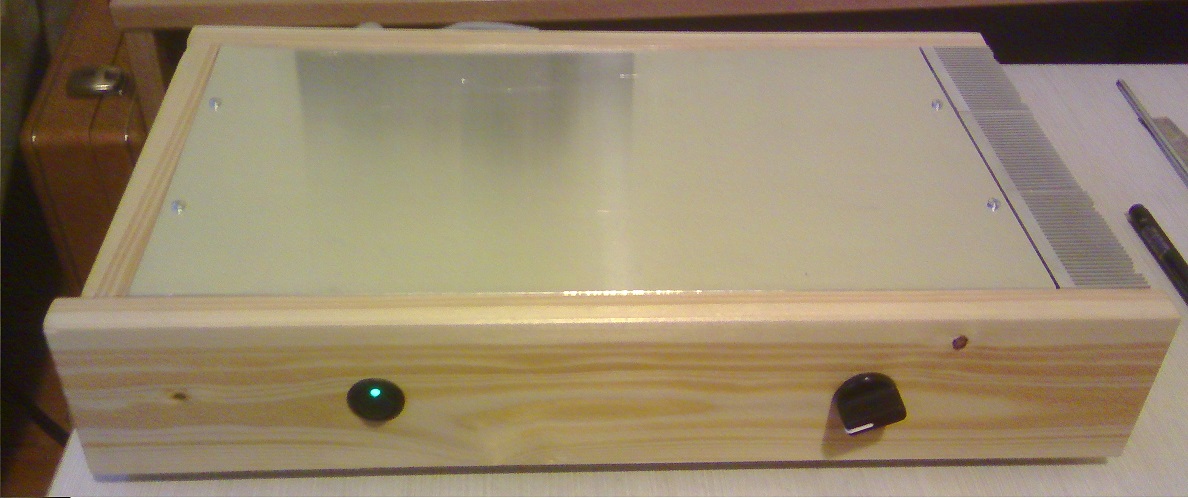

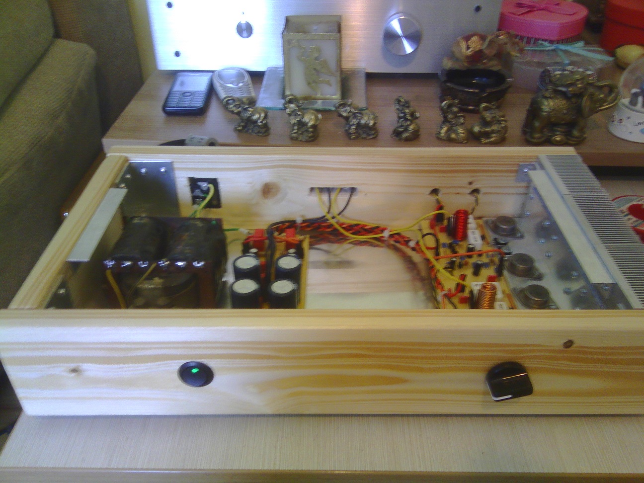

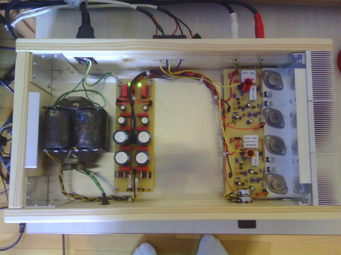

Nice amplifier looks like a piece of furniture,

can i used this protect for B500 amp sir Mile?

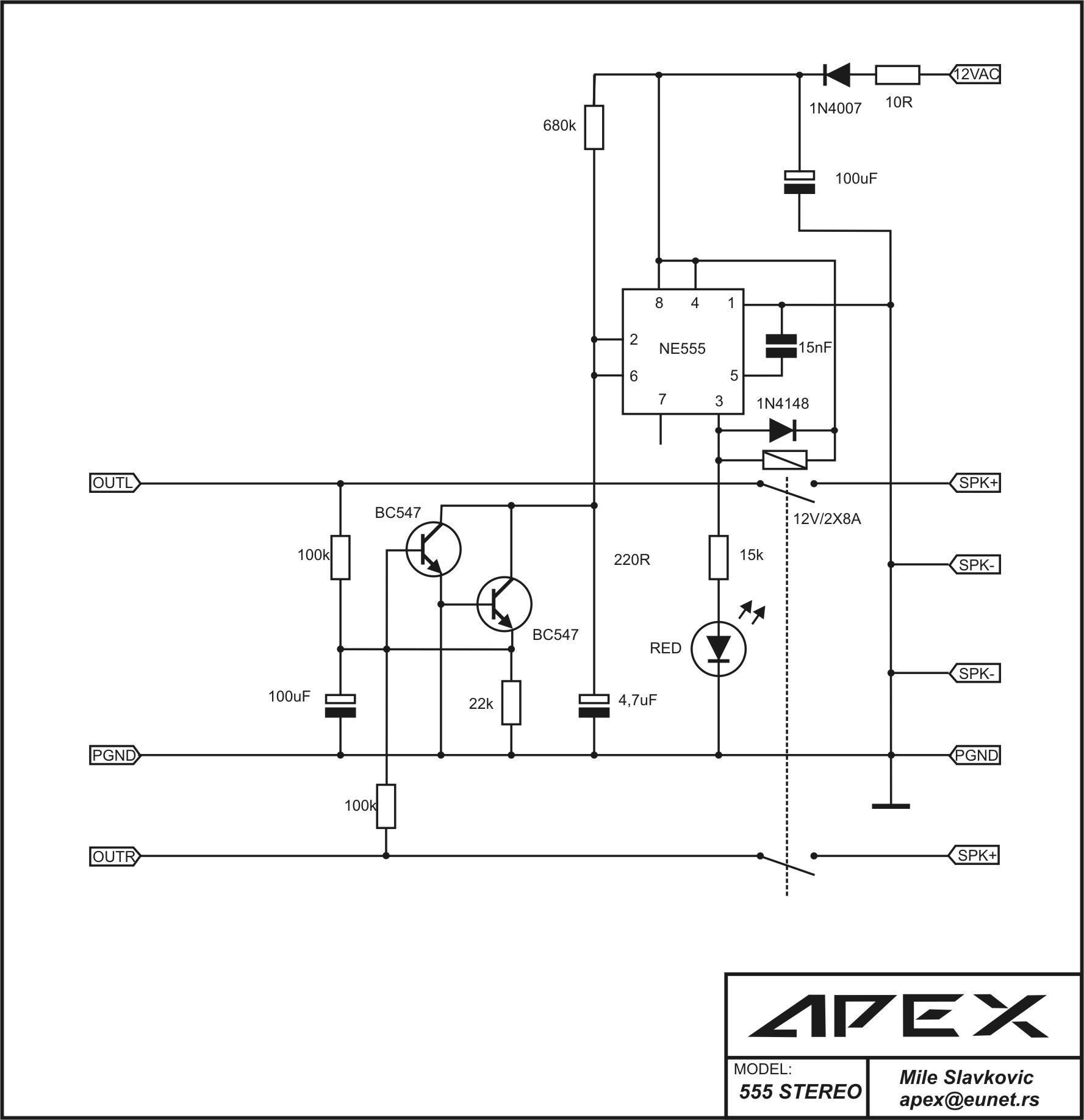

No, use preotect with NE555 it's also simple.
No ''pro'' input?
No PRO no NTC just DC protect.
