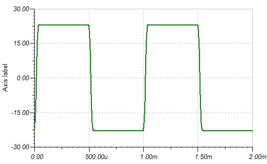

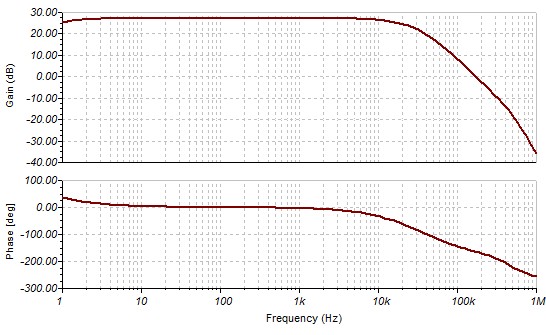

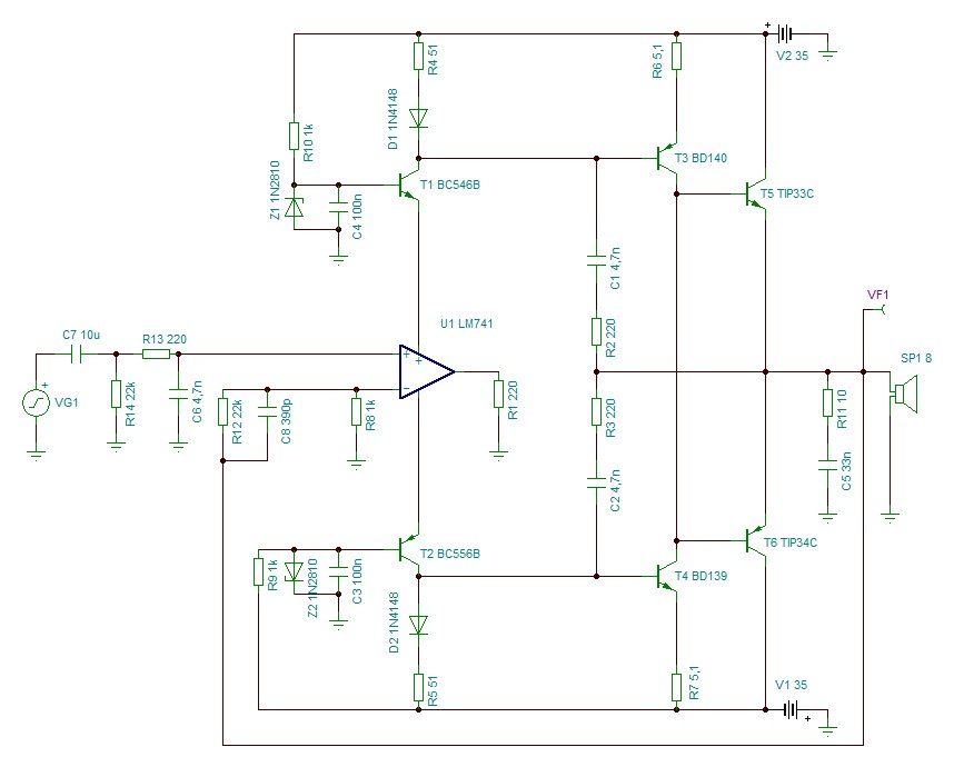

Here is a current dumping OPS I designed. I didnt call it current dumping, I called it Extended Class A. The "dumpers" basically assist the class A portion in driving the load, and EXTEND its class A operating range. Here is a schematic of just the OPS - some of the values arent quite right. More can be found here.
Class A Audio Amplifier | Sparkos Labs.comSparkos Labs.com

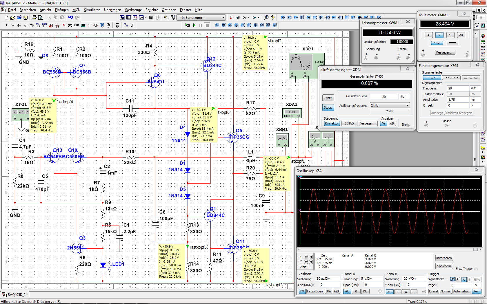

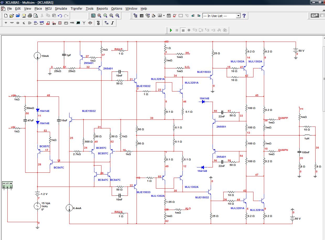

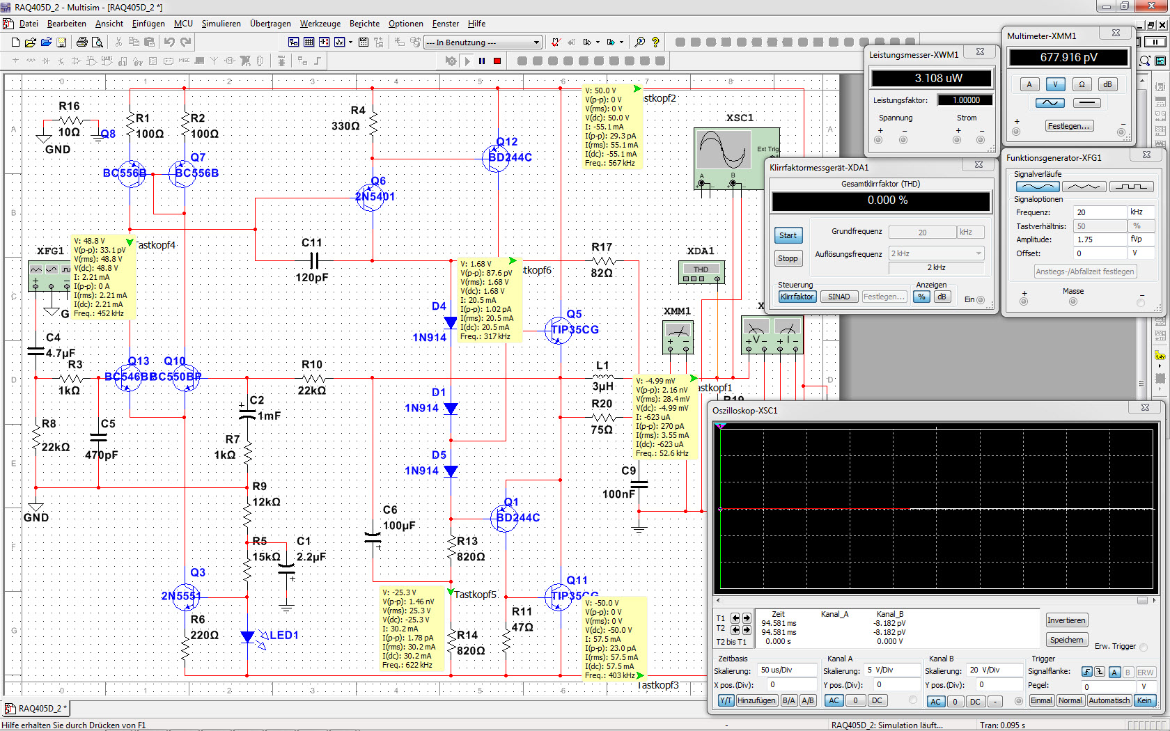

Hello,
while restoring a QUAD405 and searching the I-net for CurrentDumping alternative schematics I've found this proposal. By checking what's behind I put the schmatic into my NI-Multisim and found out that this circuit does simulate properly. For example it is completely overcomensated C8 and C10 are in pararell in the original circuit, which makes no sense at all. Distortion figures above 10kHz are unacceptabel > 0.7%. Did anyone really build this amp successfully?
However, I 'rebuilt' (by simulation) the idea of a discreet current dumping amplifier as a Quad405 alternative without an OP-amp as class-A-front-end by adapting your the basic proposal, a common input circuitry and some other info from the Quad service manual and from here (http://www.desmith.net/NMdS/Electron...es.html#bridge) and got this result. Distortion stays belows 0.01 for all outputs between 100mW and 100W at all frequencies from 20Hz up 20kHz (typical 0.002@1k/100W@8Ohms).
Maybe someone is keen to put it into reality.
Keep on ...
Keep on ...

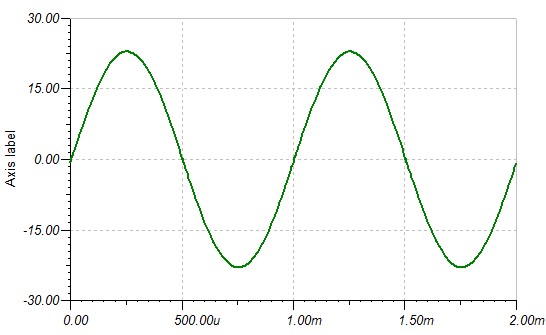

posted a 'bad shot'. Here comes the correction
Idle state:
Idle state:
