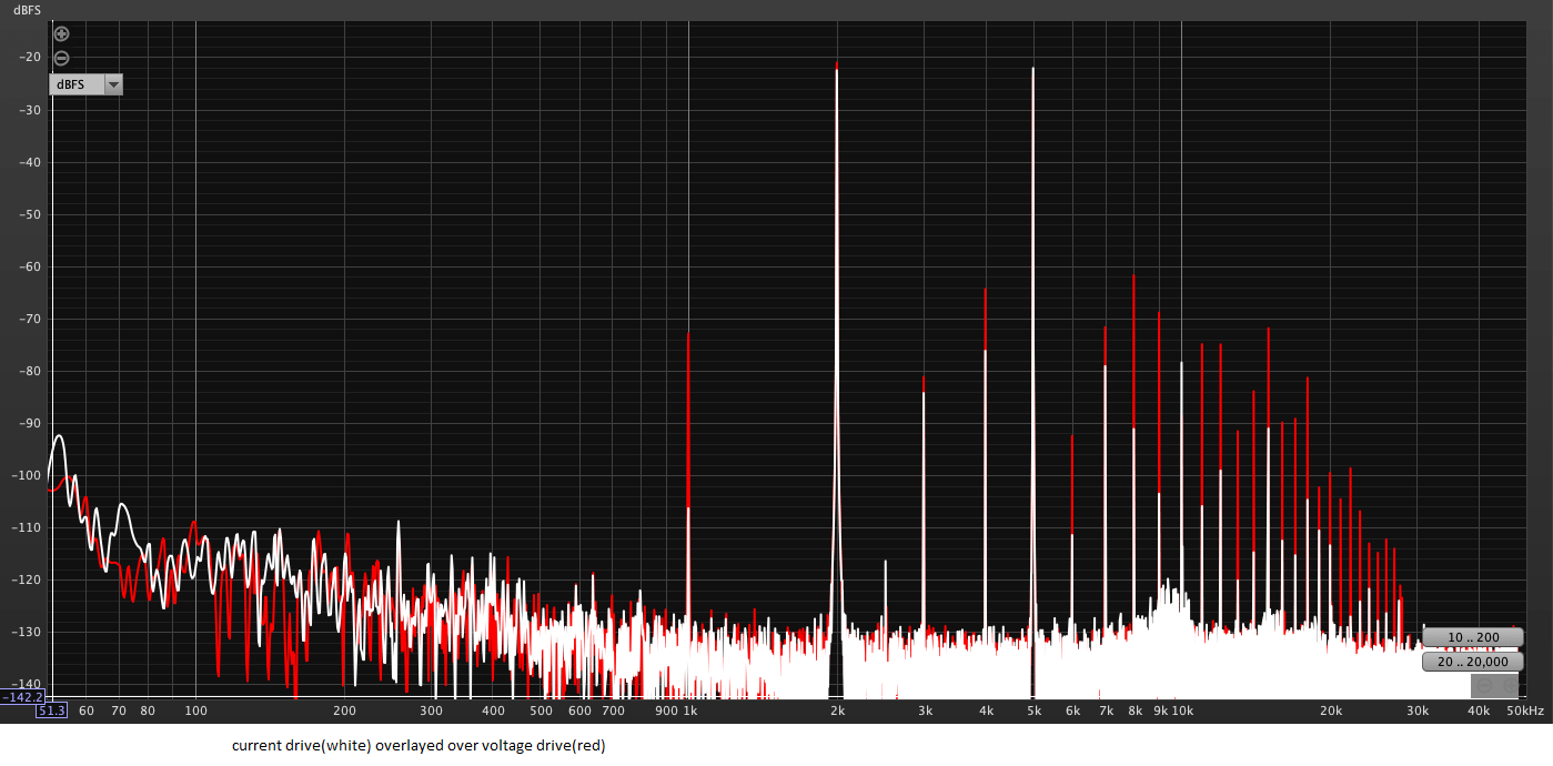

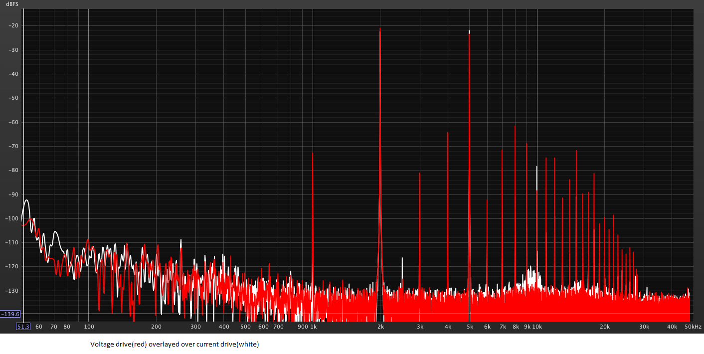

Red is driver output with voltage drive, black with current drive.
@>Baffless< : In an impulse that was not well thought out, I pointed out that condenser microphones always distort with D2.
You have shown a technically very good measurement. For me it's the first time in a forum, done by a forum member, to see a good measurement that was done with an obviously very good current control amplifier. Mills and Hawksford had "trouble" in 1989. In my approach, I measure the distortions in the current to avoid my difficulties with acoustic measurements of the distortion (microphone, measuring room...). Of course I'm interested in a comparison between a current control amplifier and the 20R approach.
Is the relative reduction similar for all harmonics when comparing current control drive with voltage control drive?
But current is not linear to actual SPL. So measuring current doesn’t give you much
Of course not all harmonics are better with current drive, but from what i have measured usually current looks cleaner above resonance. Around 2 times above resonance and current looks better. H2 doesn't seem to benefit usually but H3 a lot better. Higher harmonics also lower with current. Around resonance voltage is better. I have some more measurements, but they are not well documented. A little mess :) which driver exactly, what SPL levels, what amp and so on. Here is 2khz+5khz IMD both graphs the same measurement only diference which is on top
....because the loudspeaker cone and the sound path selected with the microphone position have filter functions?
All harmonics are definitely better with current drive, exactly by the expected amount. My measurement of the Current proves that. You can't refute that with a condenser microphone. It's not your fault, we all have these things, including Esa Meriläinen.
According to my educated guess, this is most likely coming from the microphone, not from your excellent amplifier.
I find my current measurement allows the assumption that current drive also significantly reduces the distortion at resonance? My best guess is, the ripples in the graphs come from my room, which feeds back to the sound transducer via microphonic action of itself?
Good measurement. A deep bow to your flawless presentation.

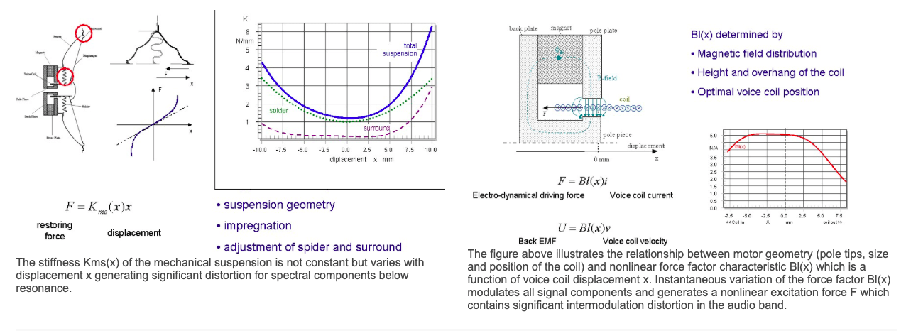

Agree that they are not LTI. Non linear, but time invariant i would say.
LOTS of speakers are NOT Time Invariant. As I said, with Angelo's method, it is now easy to check on this .. and how much. Making a speaker more TI, is one of the secrets of making a small speaker sound 'big'.
BTW, there is no doubt that current drive reduces harmonic distortion, compression bla bla .. in moving coil speakers. https://www.aes.org/e-lib/browse.cfm?elib=6099
But the 'distortions' it reduces are mostly not audible https://www.aes.org/e-lib/browse.cfm?elib=2476 This paper isn't only about Intermodulation. See the appendix for the many 'distortions' that ARE audible
current drive eliminates the hysteresis distortion from the iron around the voice coil. This has infinite memory and is thus very much not time invariant. I presents it self as harmonic distortion for sine wave signals but more complex signals reveal the non linear memory. I find personally and subjectively this type of distortion very destructive.
