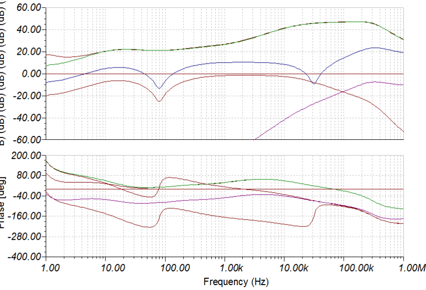

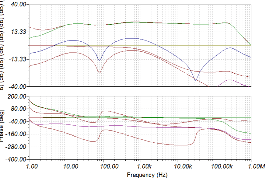

So here's a rough concept I sketched:
There's some low-pass pre-filtering on the left, a long-tailed pair, an open-drain MOSFET and CCS output stage, and a woofer model. The woofer inductance is probably exaggerated because it uses a normal inductor instead of any special semi-inductance, so with the current feedback the gain is also exaggerated.
The feedback system has an 'inverted' notch filter. I wanted a band-pass filter, but needed something that passes DC, so ended up making a "band boost" that mostly has a gain of 1, except for the resonance, where it goes up and is somewhat adjustable. So at ~80 Hz there is more voltage feedback than elsewhere.
From 500 Hz to 20 kHz, the gain increases due to the 0.53mH speaker inductance, but this is flattened out by pre-filtering.
Bypassing the pre-filter:
It's a bit tricky so I'm open to any ideas and suggestions. High frequency noise in particular is higher than I'd like. Increasing the sense resistor (and re-balancing the feedback gains) gives a quick improvement, but the topology might need some work. The 2 feedback paths are basically fighting each other, so some first-order filter slopes might work, and trying to get the high frequencies to bypass the op-amps.
The obvious alternative is to put a notch filter on the input, but then all it does is turn down the excess gain, but not the distortion spike.

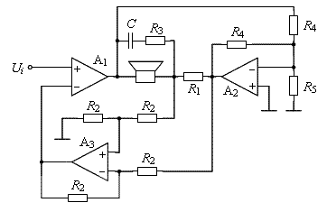

mixed or current or voltage mode is all possible with bridged. Don’t think to complicated. Electronics doesn’t understand what mode it works in. It is a question of feedback. Take bridged voltage amp, put opamp in front of it with your own feedback loop. Mixed or current, or negative impedance or any other feedback configuration and it will follow what you want. It will not be the fastest possible design but this is just for concept understanding that every configuration posible. CharlieLaub is showing bridged design. More or less the same i am talking about
How about drawing some more schematics. This is interesting. With so-called 'current-drive' only one side needs to be high-Z, the other can still be low-Z. Since they are in series, the sum will always be high-Z and hence a current source is not compromised.
But schematically, how would you do it. Are there several ways?
I am willing to learn from others.
If you mean this circuit from post 809:
https://www.diyaudio.com/community/attachments/bridging-1-gif.1158748
This is just a driver with two amps configured in a bridged operation to have the same gain. The same current flows through the driver and the sense resistor. Instead of R1 sensing the potential across the resistor referenced to ground, A3 operates as a differential amplifier. I believe the resistor values should follow these rules:
R2>>R1
R5>>R4
R3 and C are set to ensure stability and limit bandwidth.
R2>>R1
R5>>R4
It looks a bit like a Howland or improved Howland current pump as a basis. There are lots of ways to do it.

sure R2>>R1If you mean this circuit from post 809:
R2>>R1
R5>>R4
not sure why R5 is here
I am sure that A2 will not be unity gain stable!
