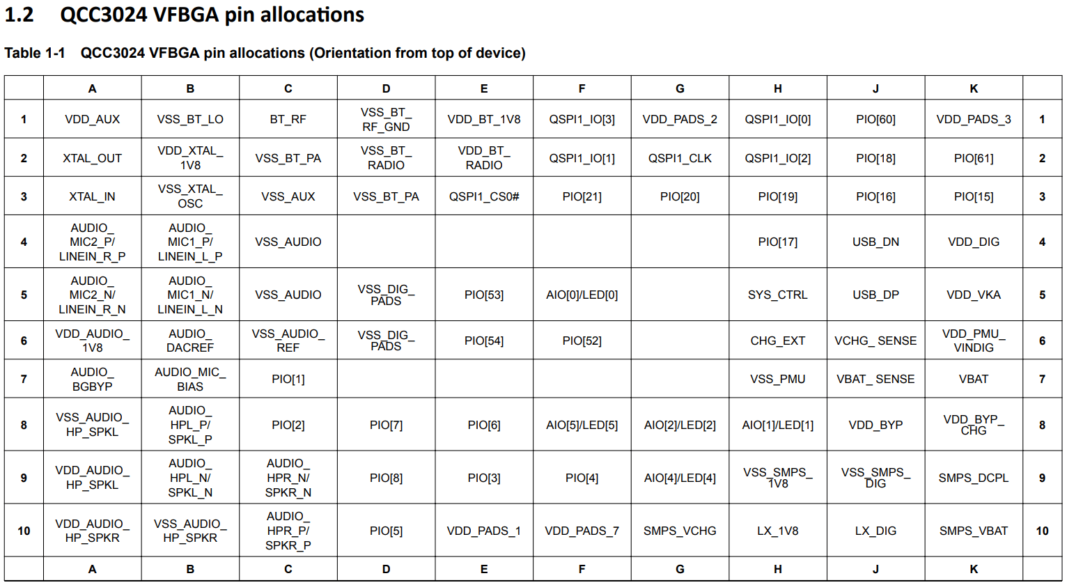

Issues connecting to QCC3008 TWS, Do I need to do some kind of erase and reflash the boards with an alternate .psr?
I have a working .PSR file from an initial test board which sadly stopped working after I unsoldered header pins. I ordered 4 more boards from a different source and I cannot connect to them.
I'm really stuck with these now because I have built 10 custom PCBs for a project and of course now I can't change the Bluetooth module footprint!
I have tried every combination below and received different errors. I'm really stuck on this and appreciate any advice! Thx
SPI_EN Pin:
SPI_EN Pin:
