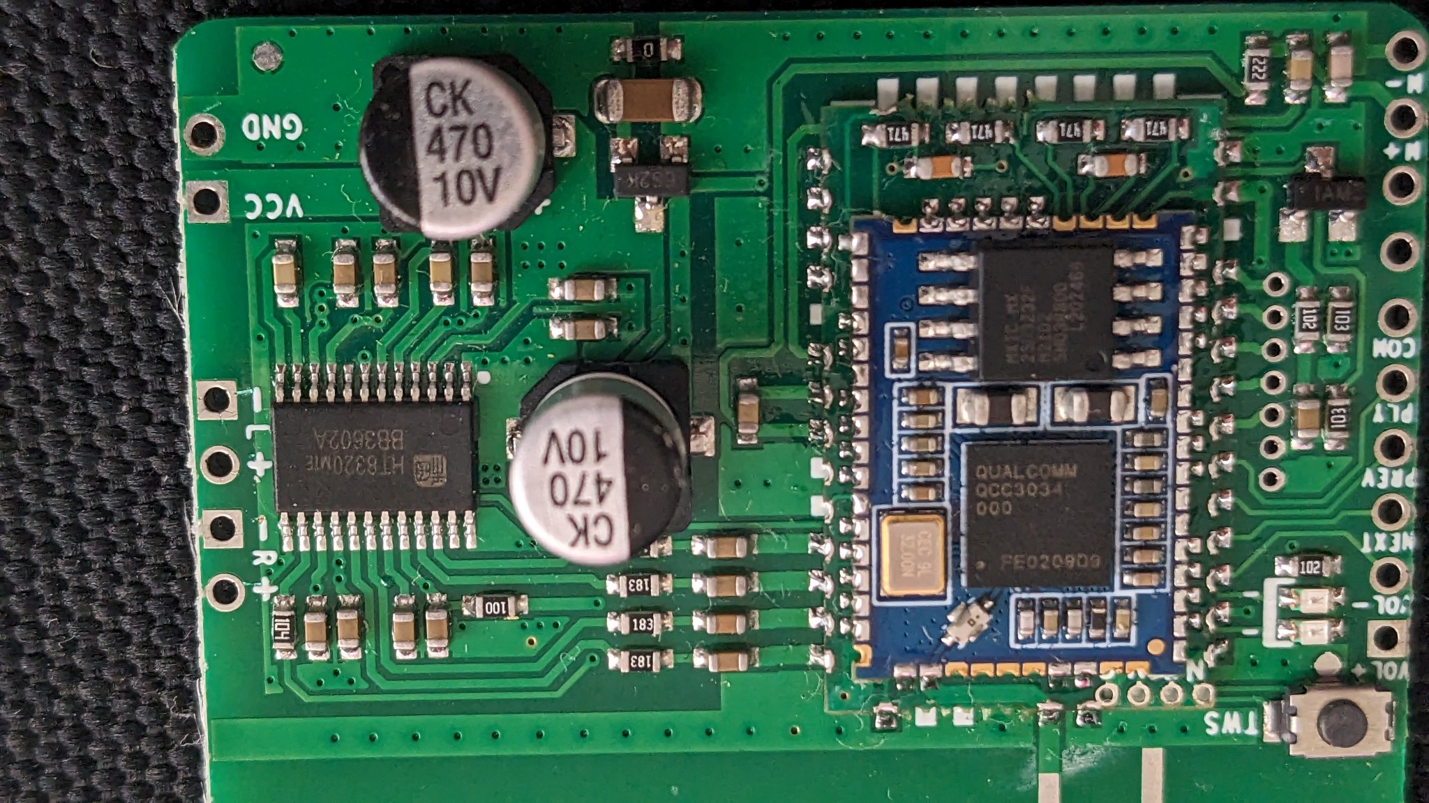

do you reckon i could get this screen working with the QCC3034? i have an application i'm currently looking at where i'm also considering trying to use a ESP32 micro controller in teh build, so not sure if i can send the signal to the ESP32 then display it via the microcontroller/screen
Why don’t you use QCC3034 module to send the signal to LCD? You only buil a new firmware to do that. But if you can make QCC3034 comunicate with ESP32, this LCD still work, and you must understand about address of LCD via I2Cdo you reckon i could get this screen working with the QCC3034? i have an application i'm currently looking at where i'm also considering trying to use a ESP32 micro controller in teh build, so not sure if i can send the signal to the ESP32 then display it via the microcontroller/screen

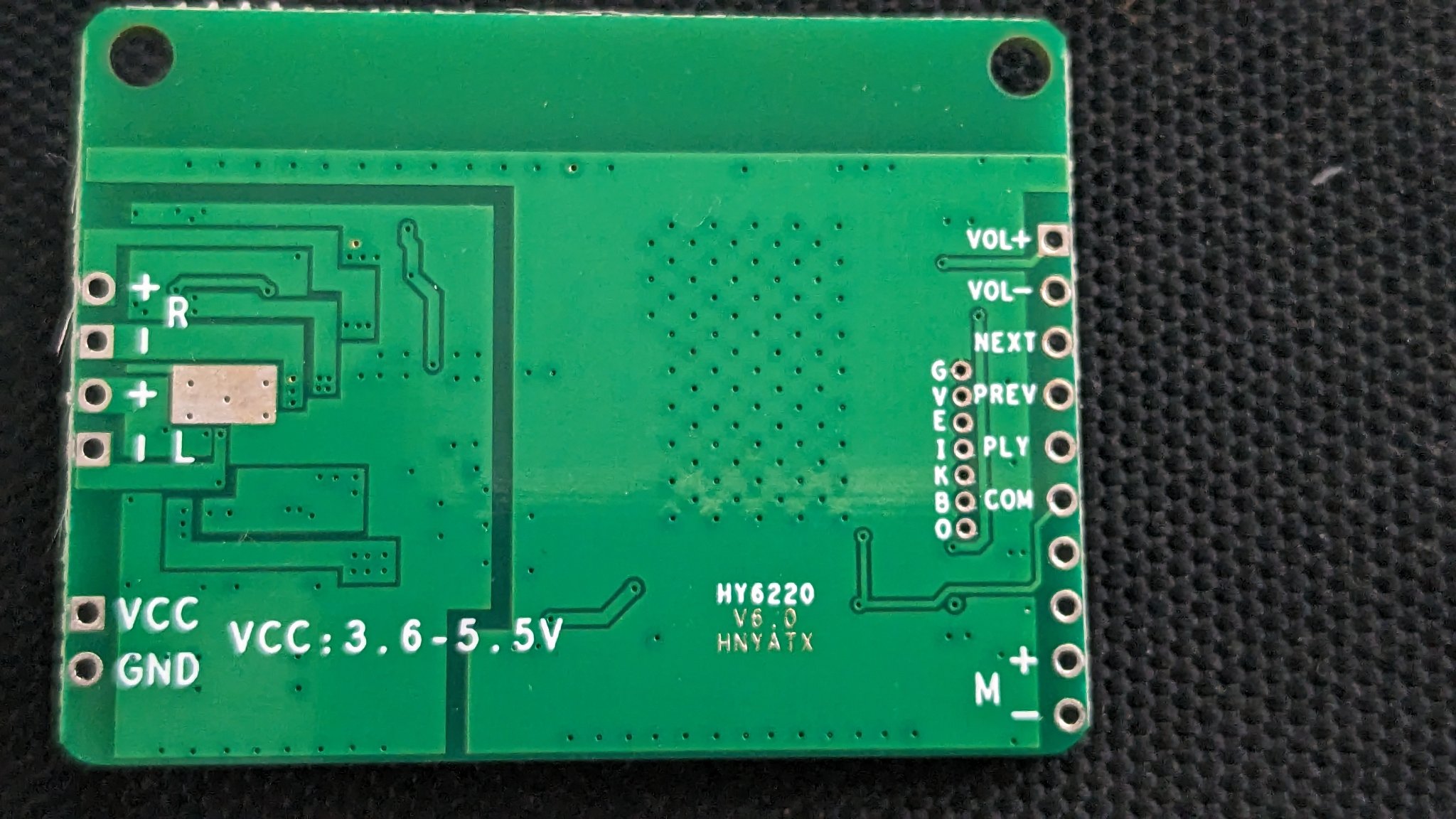

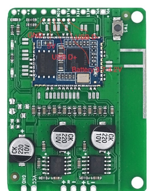

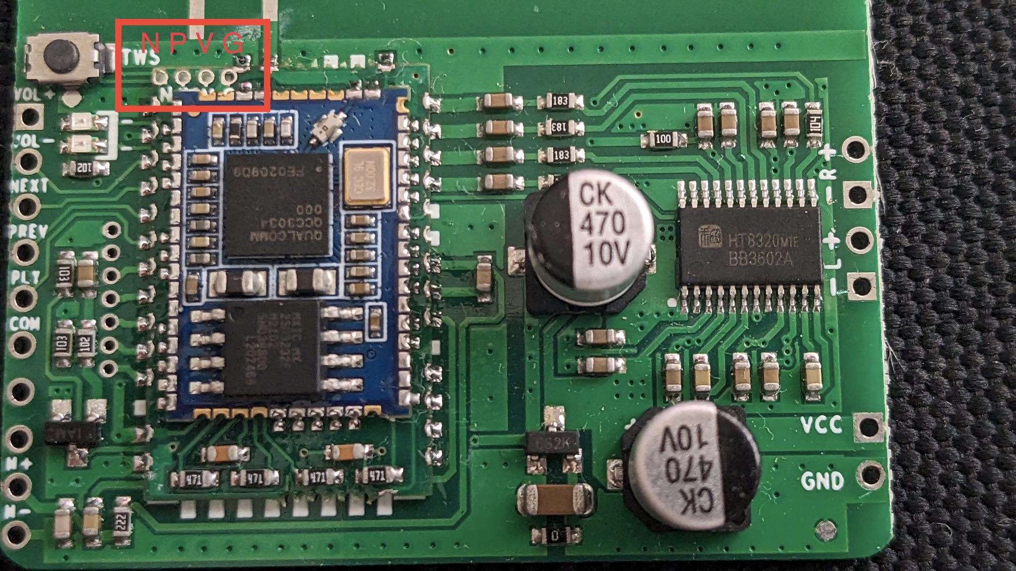

Ok this confuses me, i've never stopped to look before but this "lettering" looks to correspond with the USB-SPI device i have for the QCC3003 chips, but like you mentioned before @phuongpm72 it cannot connect to the computer this way. The last image was the one that you recommened previously as well, but not sure which the data in/out would be now as there is no P/D on this one.
@phuongpm72 thanks i dont know what im doing wrong, i've connected it to my PC, its popped up on the bottom as a "qualcomm USB hub", but even following your "how to back up your firmware" i cannot access it in the NvsApp or even the PSTools.
i can physically see it in my explorer as a blank drive, but the tools dont seem to be able to see it?
