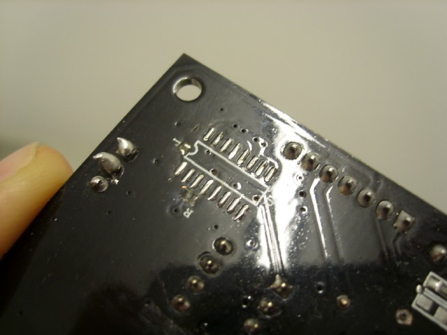

Whilst listening to the DAC last night one of the temporary solder connections attaching the right channel lead to the coupling cap broke away.
I re-soldered the lead and at the same time decided to remove the two blobs of solder from the chip on the base of the board. I fired it up again and only the left channel works. All of the connections seem fine and both channels from my amp operate ok via a DAC MAGIC2 box.
I re-soldered the two blobs next to the chip and now the output is very quiet and extremely distorted.

Well...I have removed quite a number of the components previously added but am no further forward with regards to sound, still very distorted.
When I desoldered the small blobs from the base of the board next to the chip I think I may have damaged the solder pads (Solder is not sticking any more and they are barely visible).
Last night
I have checked all of he solder joints and I cant see bridging. I also checked the Digital voltage from the CS8416 and I am getting a reading of 3.33v on pin 23 and 21. I also have a reading of 13.24v from pins 4 and 8 on the opamp.
After considering my options I decided to remove the chip from the base of the board.
Can anyone advise which pads I need to short for bypass?

YES!
I've just soldered the the link in the past five minutes. The sound is back albeit only the right channel, and its not distorted. It is however sadly lacking in the bass department. Progress!
I have checked the connection between pin one of the opamp to the left output pin and its fine. I attached the meter to the right output pin but could not make a connection with any of the other opamp pins. I do have a connection between the blob on the base of the board and the right output.
I have tested the leads to the rca sockets and they appear fine.
Any suggestions?
Richard
[/IMG]
I meant the left channel is working, not right.
I have put a meter between pin 1 of opamp and L-OUT and its fine. But I don't get a reading between pin 7 on the opamp and R-OUT. If I turn up the volume on the amp and turn the balance control right around I can hear I faint sound (Probably cross-talk)

kanifee said:
dont know how relavent this is or weather it makes a differance but is that a short in the picture marked with the red line?
do you also have an opamp from another device to test in it?
Hi Kanifee
Thanks for the reply.
Its not a short. I have managed to sort the problem.
You can read the story below
