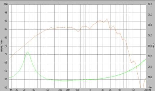

I am playing around with this 8" plus 2" one at the moment:
It is not a million miles from the KEF C30 in fact. The £6.50 Monacor HT22/8 is generally despised here at diyaudio as being too low tech. I think it is a great and interesting tweeter. So does Joachim Gerhard, as it goes, though he found that only 20% of them were within any sort of accurate tolerance, which is too poor for his exacting standards.
The frequency response is fairly wobbly at +/- 2dB within a flattish overall envelope.
Test Lautsprecherchassis Hochtoner - Monacor HT22/8
It is hard to say how much of this response is the measuring microphone and how much is the driver. For sure, it is better than the Visaton TW70, which lacks resolution at the top. I did actually take a TW70 apart after an unfortunate incident of putting a screwdriver through the cone. It has a spider, which surprised me. No ferrofluid. It's actually constructed exactly like a bigger midbass in its own sealed enclosure.

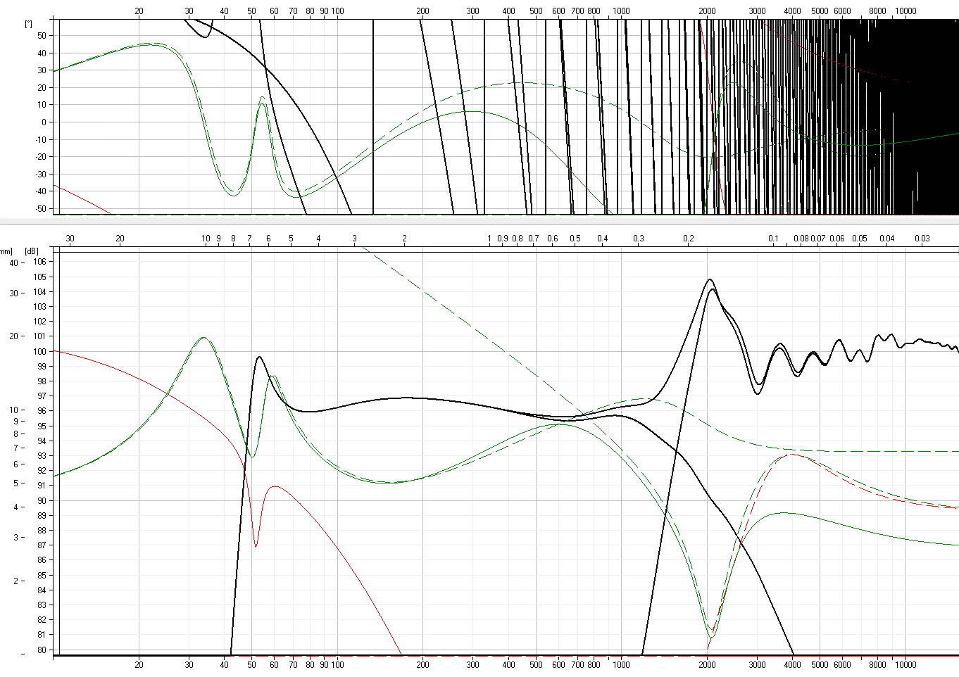

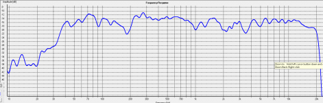

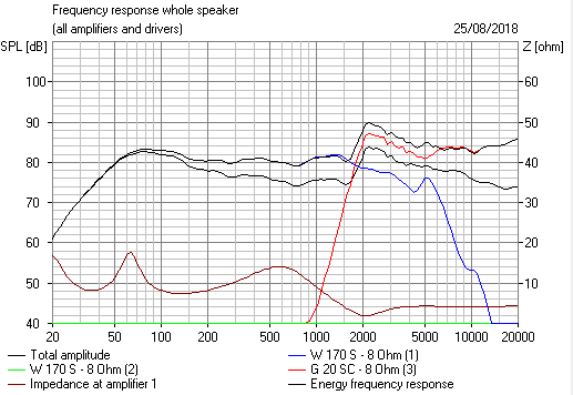

The simulation response can be very different from the real deal:
For this speaker project Usher 8945A +9950-20tweeter soft dome (note: usher speakers are back on sale on partsexpress!!!)
Xo point is 2250hz, in simulator more 1600!
Note the : real response is maybe the last design, but in any case it is very close to the actual XO simulated.
Here is the attachments of the simulated response in the baffle, tweeter is copied from the Scan-Speak and should match the Usher tweeter (1/5 price)
Predicted in simulator:
Real response:
Real response:

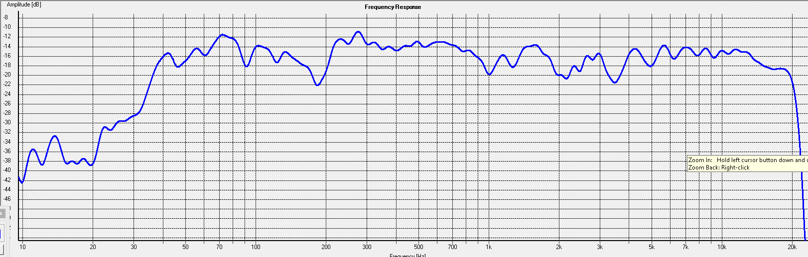

1/12 octave smoothing seems to be industry standard.
As an aside, does anybody share my feeling that SPL trace methods give wildly inaccurate and oversmoothed phase in simulators? Actual measurements for FRD and ZMA as Dayton nobly do seems to work better.

No offence, but this is more a demonstration of flawed modelling and measurement technique rather than room effects. Using the Scanspeak model was misguided - the Usher tweeter while 'visually inspired' by SS tweeters is not the same as any SS tweeter.Xo point is 2250hz, in simulator more 1600!
Predicted in simulator:http://www.diyaudio.com/forums/atta...535159959-crossover-staying-3db-predicted-png
Real response:http://www.diyaudio.com/forums/atta...60253-crossover-staying-3db-real-response-png
With correct technique there is no reason that simulation and measurement can't agree within 1dB or so, e.g: Zaph|Audio - ZRT - Revelator Tower

Perhaps we could crowd-source to raise funds to buy this person a mic....With correct technique there is no reason that simulation and measurement can't agree within 1dB or so, e.g: Zaph|Audio - ZRT - Revelator Tower
Room effects should certainly not substantially change the effective XO frequency.
B.

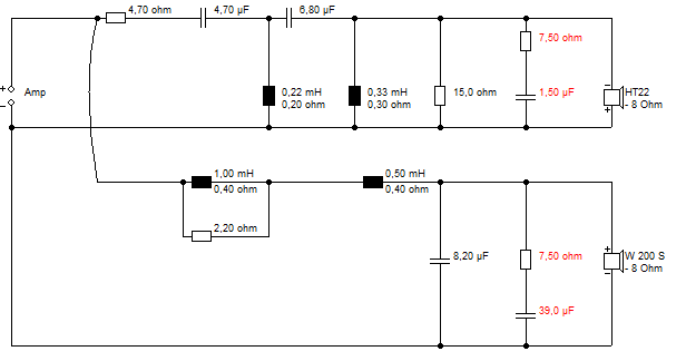

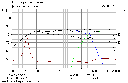

The simulator got it right that the woofer response is within 1 db for most, actual room gives more like +/- 3db.
but no 4 db bump at 50 hz, not measured or observed.
Simulator would suggest a 8ohm instead and a 2.1 Input inductor.
However listening test proved 10ohm 2.4 a lot better for high frequency.
For the tweeter:
The filter with 7.5 ohm actually corrected the dip in the tweeter response, with no filter the impedance is not 2 ohm it is 0 ohm in the simulator.
More filter with more impedance would make the tweeter sound not equal.
The response that you see is close to the final design which I can't pin-point in the 50 simulations I did .
It is from 2 meters off-axis and gives a great sound, sweep tones are quite controlled.
I just say that the actual XO is surprising if you look what I would come with in the simulator to correct the bumps which are not measured in real life.
I admit the tweeter is very badly simulated... lack of data
For the tweeter:
- Crossover: Staying within 3dB
