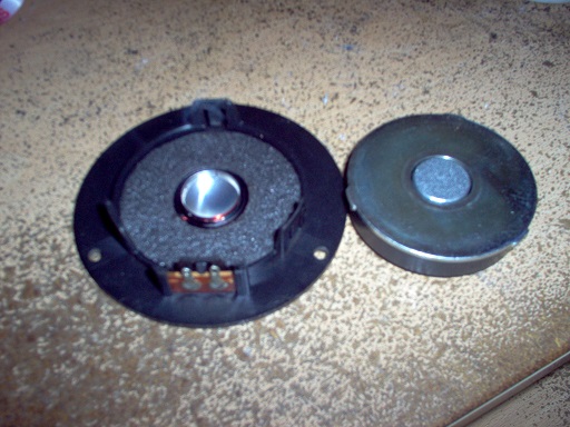

My first issue is the KEF's aren't mine. They belong to my partner. Ok it's all shared property but she had them prior to our relationship and I don't think me replacing bits and pieces would be appreciated.

Sounds like a pillow is over them, well KEF weren't that incompetent. Are the tweeters working?
30 years old with a derivative of the T33 tweeter. Those were ferrofluid IIRC. No.1 suspect. Probably gone solid.

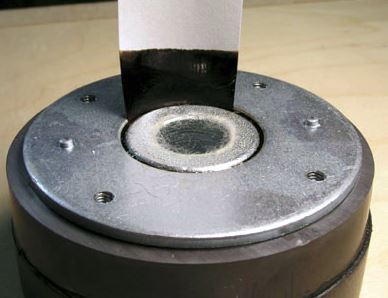

Ah yes good point on the ferrofluid. I think you're on the money there. Both tweeters work but probably have "seized" somewhat as we've both noticed a dulling in response. Is fluid replacement possible or is it simply easier to model a tweeter replacement?
Ferrofluid is very easy to replace if the tweeter comes apart easily. Get the old dried up goo out with a kitchen roll and maybe some aerosol spray like the UK favourite WD40.
I don't know where you can buy it in NZ, but parts Express in the uS and Blue Aran in the UK have it:
Sonitus Audio Ferro Fluid (ferrofluid) for Speakers and Compression Drivers 0.5ml from Sonitus Audio PS4.99 IN STOCK (21 Aug 2018)
That's what I use. About 0.1mL per tweeter. Doesn't matter much if you overdo it. More you use, the smoother the tweeter sounds.
If you take them apart, you'll see the problem. It's meant to be a black oily liquid, but the kerosene dries out leaving a solid gunge of iron oxide particles. Kills the tweeter response.
No reason why you can't run the tweeters without it for a while. They'll just sound brighter.

A little summary on the "How Speakers Work" lines. This might save breaking anything.
Tweeters are usually screwed or clipped together. Occasionally the wiring is awkward and needs unsoldering at the terminals for disassembly. It is important to lift the voicecoil off vertically to avoid bending anything.
Below is one of my SEAS 19TAF/G tweeters. It comes apart easily with three plastic spring clips, which are easily manipulated with a small screwdriver. The magnet is tough as old boots, so shouldn't present a problem for cleaning out the gap. Good ferrofluid looks like a black rubberband sitting in the gap, held by magnetism.

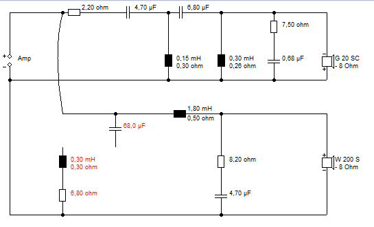

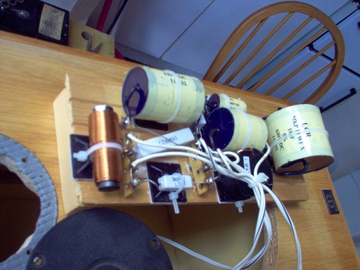

I like to look at the crossover. I worked out the XP2 has this:
A very good and interesting circuit, which KEF used a lot too. It's why the XP2 is rather good.
Capacitor quality has little effect on measured frequency response, or at least, nothing you can't compensate with a little resistance. Where cheap electrolytics are measureably different is on the overall impedance plot of a tweeter circuit, which can change by an ohm or two. I wish I had time to do some thorough measurements, especially with cheap MKP versus expensive ones, because everybody else has come up with zip on this capacitor quality issue. They've been measuring the wrong thing.
