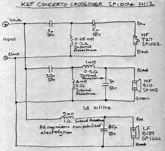

On a different(ish) front, I now have 4 x Kef B139, 4 x Kef B110, 4 x Kef T27 and 2 x Coles 4001G, all of approximately the same age (long story about my accidentally acquiring a 2nd KefKit 3). Ignoring the fact that these are about forty years old, how practical would it be to build a speaker based on the Sunflower Open Baffle design but using 4 x B110 and 2 x T27 as MTM and 2 x B139 as woofers? Or even 4 x B139! Would it be possible to redesign the crossovers to accommodate these drivers?
<snip>

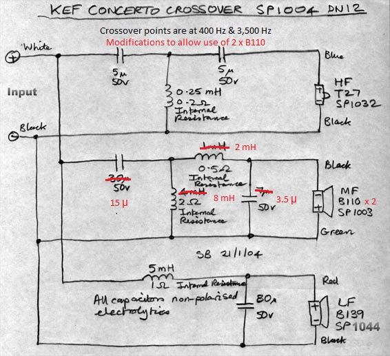

The conversion from WMT to WMMT is actually trivial, surv1v0r.
You take an acceptable crossover, which is the KEF Concerto IIRC here, and wire the mids in series. You then adjust the values of the mid filter to double inductance and resistance, and halve capacitance.
It all works out.

Yep, the midrange will have a bandpass filter. The 30uF cap and 4mH inductor form a second order highpass filter, which then feeds into the 1mH inductor and 7uF cap, which is a 2nd order low-pass. Between them, you get a 12dB/octave electrical rolloff at each end of the midrange's operating band.

I have four probably very dumb questions:
- The three Kef drivers have a nominal impedance of 8 Ohms. However, when measured with a Multimeter they never seem to read 8 Ohms. Should I use the "nominal" or "actual figure in BoxSim?
- The three drivers are (effectively) wired in parallel and yet the effective impedance of the Kef Concerto is 8 Ohms - how so? I realise that the impedance will vary with frequency - is that the explanation?
- How would I go about adjusting the values of the mid filter in the Kef DN12 crossover to double inductance and resistance, and halve capacitance (e.g. to allow the use of 2 x 8 Ohm B110s)?

Nominal impedance of 8 ohms usually means a DC resistance of around 6 ohms on a driver.
The KEF Concerto impedance is around 5 ohms overall. This is common with 3-ways.
The midrange filter conversion ends up as 15uF, 8mH, 2mH and 3.5uF with two B110 in series.

Thanks for that System7.
So, the mid-range DCR moves from 6 Ω to 12 Ω and to cater for this, you halve the value of the capacitors and double the value of the inductors?
Yup, that's it. You can double the coil resistance too, to be precise. 3.3uF should be near enough.
If you do the sums, each driver gets half the voltage. And based on VxV/R, it means they each put out 1/4 the power. So you half the acoustic power in the midrange. But because there are two drivers, the SPL gains 3dB. The mystery power loss and impedance rise is compensated by the cylindrical nature of the dispersion in the far field.
