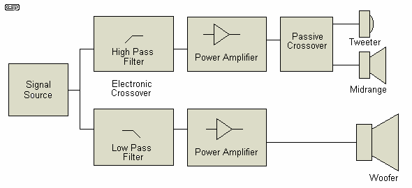

Looking at this Bi-Amp block diagram taken from the WestHost.com article linked by PeteMcKI imagine that you would still need some sort of level control following each of the amplifiers?

Re the westhost block diagram: The levels for the individual power amps will be set in the active crossover as part of the design process. Once set, they can be left alone. Overall system volume control will take part in the preamp as usual.
I think the confusion arises because the diagram is assuming source = preamp. (Or a source which has its own volume control, like an iPad or computer.) The diagram also shows a passive crossover between the mid and tweeter. So the diagram is showing a compromise system instead of a fully active system. A fully active three-way would have an active crossover feeding three power amplifiers.
