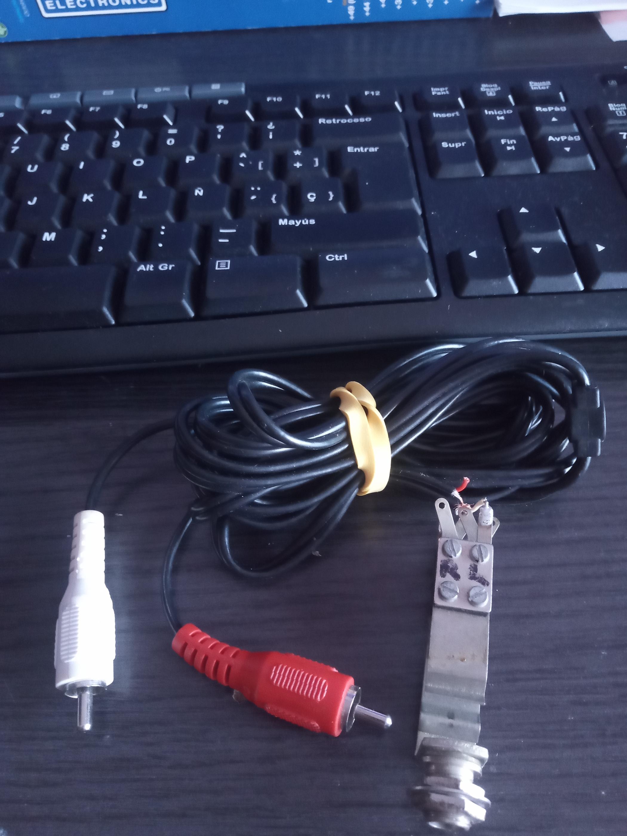

No need to cut the cable of your phones, simply an aerial headphone jack and the cable. Something like the attached pic but without RCAs.

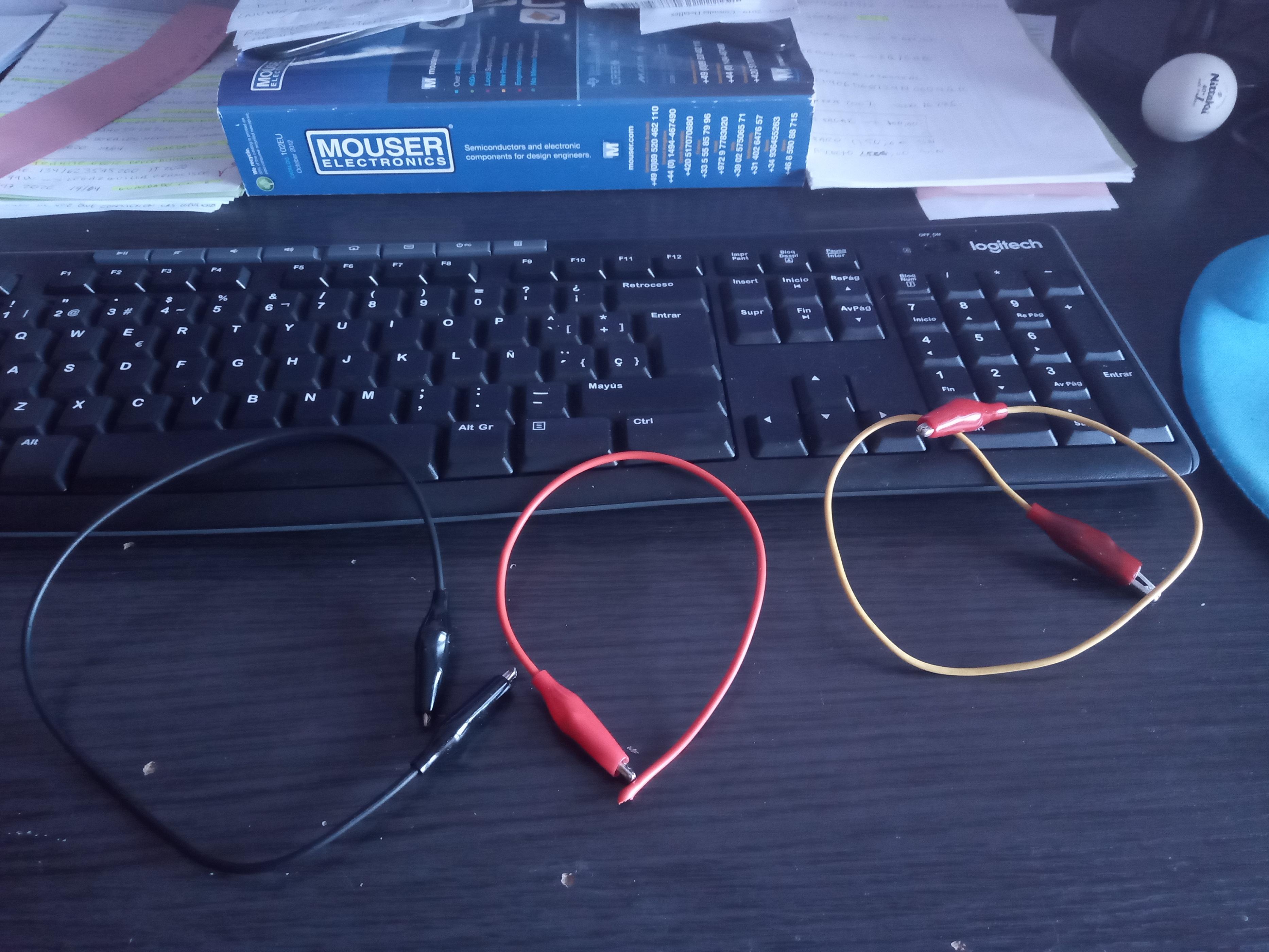

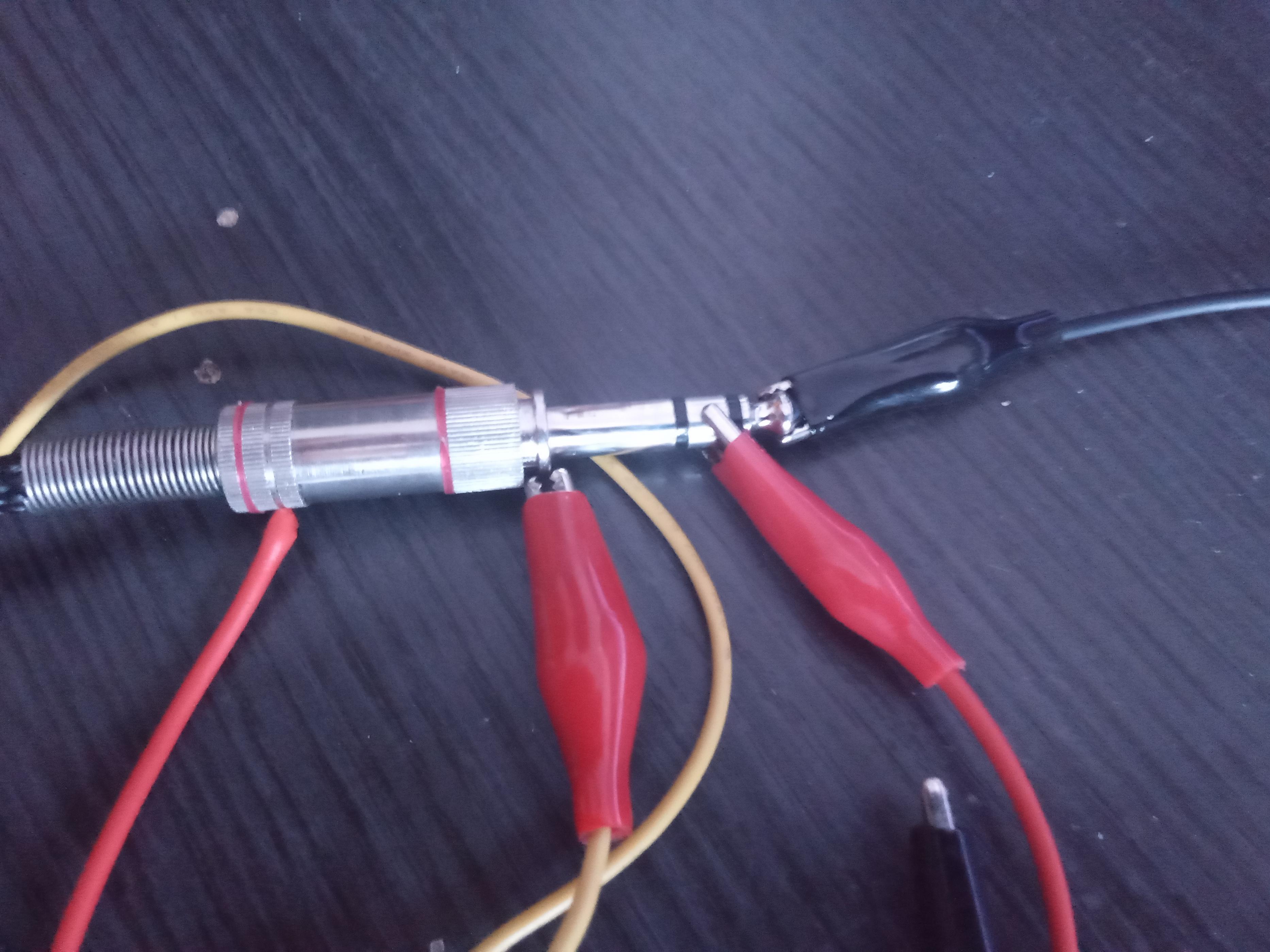

Do you have alligator clips? If yes connect one side to the headphones plug & the other side to the Chronus output. You need only three.
