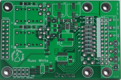

Cronus is a module designed for providing clocks to and reclocking output from digital sources. Cronus forms the backbone for audio sources built around 2 other module types - Hermes and Rhea.
Cronus was a long time coming - because we worked hard to make the results not just good - but superb. We could have released earlier - but we wanted to get in all of the things we desired after two prototypes.
Special thanks to Miero for his beta testing.
Extra special thanks to Brian for being patient with my long design process - and for putting together awesome beta and production kits.
Cronus provides the following:
  • An ultra low noise low impedance 3.3V power supply for clocks and reclocking section.
  • A clock selection multiplexer to switch between 44.1 and 48Khz time bases.
  • A selectable/bypassable ultra low phase noise clock divider to supply 1:2 or 1:4 clocks to a source.
  • A synchronous reclocker that re-clocks the audio from the source back to the master clock. This brings all signals back into alignment with the actual master clock regardless of source jitter - thus your final signal is as good as the clock you supply - which is to say - excellent!
  • Pads for pluggable clock sockets based on standard DIP(8 and 14) clock - See Rhea thread for more details.
  • An interface for connection to our isolation modules for various sources - See Hermes threads for more details. Hermes isolates your DAC completely from your source.
  • Interfaces for connecting to B3/B3SE and any other PCM/DSD DAC.
  • SMA and uFL connectors for external clock signals (both in or out)
  • uFL connectors for PCM/DSD output.
Some useful things to keep in mind:
The re-clocking section makes use of a Potato semi FlipFlop. When using a FF in this way the frequency of the clock input supplied to the FF must be at least 2 x any signal. For this reason ~22-24Mhz family clocks can be used for PCM signals up to 192Khz - for up to 384Khz you must double that. The device is capable of up to 768Khz PCM.
The module is designed for around ~5VDC input - but it is fine to go higher (absolute max is 16VDC) depending on the load you are putting on the VREG (adm7150) please refer to the datasheet about limits. The max current is listed at 800ma. The current consumption will vary depending on loads and audio frequencies. In testing using Crystek clocks (50Mhz family) I am drawing well under 150ma at 384khz. Keep in mind also that Hermes modules are designed to be powered on the clean side by the Cronus power supply.
The clocks are isolated from each-other and the rest of the circuit by utilizing L/C filtering with ferrites.
The Cronus is designed to work with Sources that provide a clock selection signal (CS) and can accept an external audio master clock - it is currently tested with two Hermes modules. Hermes-BBB for the BeagleBone black (using Botic distro), and the Hermes-Amanero for the Amanero USB module. There will be a thread for each. Both are tested and work up to 384Khz.
I will fill in more details to this post as necessary.
A manual is under way for each module - but I hope you basically know what you need right now. 🙂
The Hermes and Rhea threads will fill in a lot more detail.

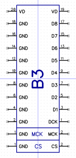

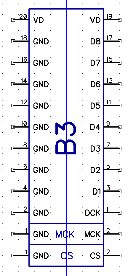

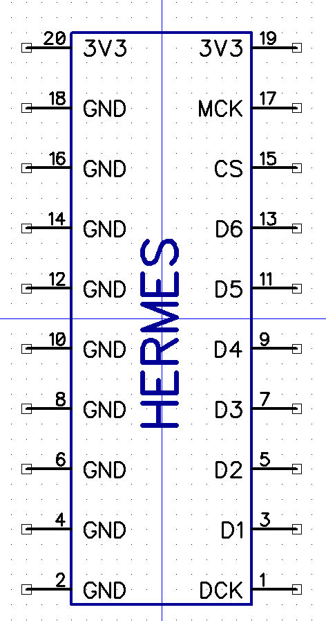

I have also attached the pinouts of the .1" headers on the output side of the cronus and the Hermes header.
Note: If you use the terminal blocks - it is recommended to mount them on the bottom side so they don't interfere with uFL connectors etc.
