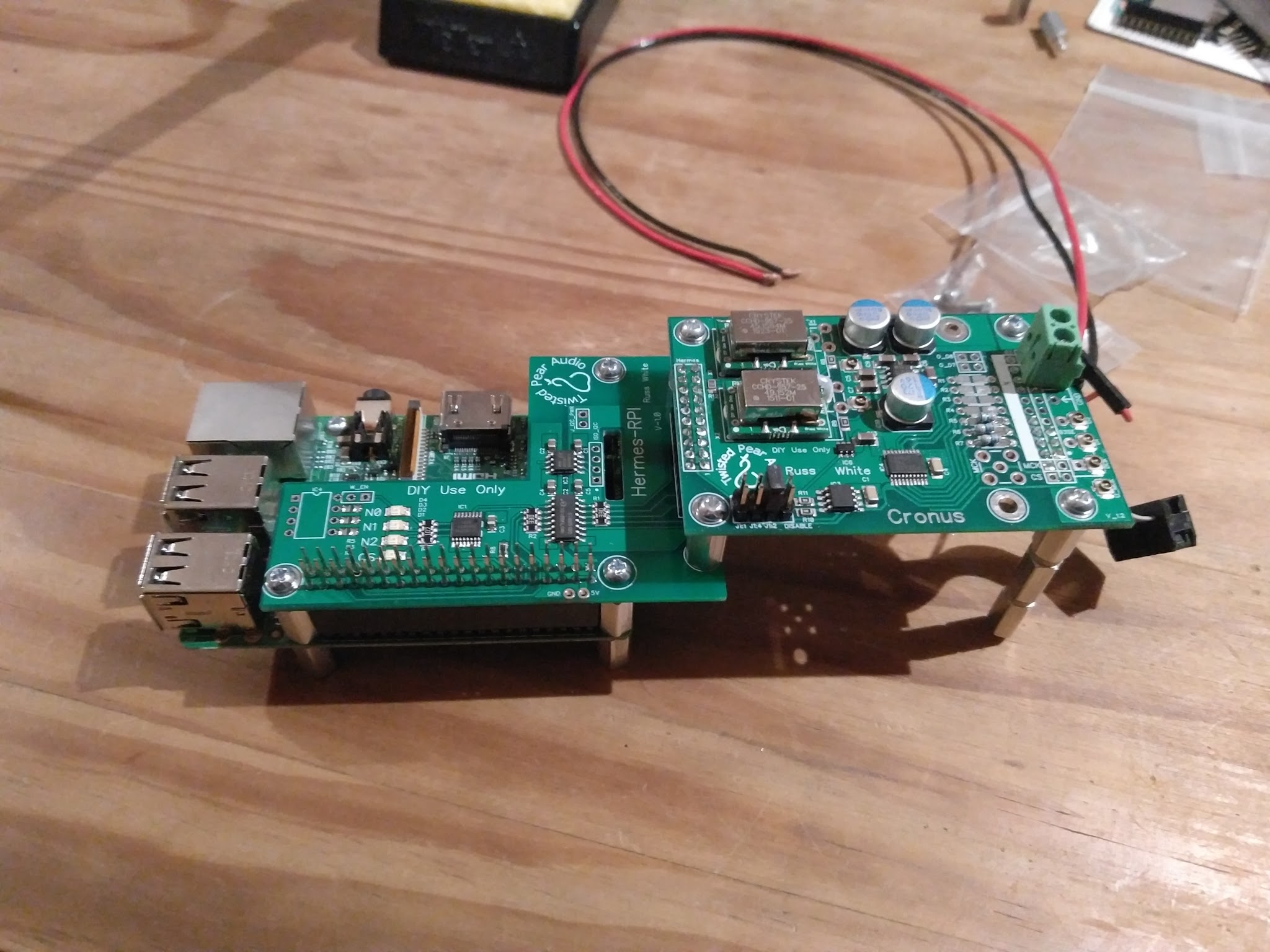

Just to keep RPi lovers posted, I just tested the Hermes-RPi card today.
Tried it with a patched Libreelec distribution.
Perfect on all sample rates
44.1 - 48 - 88.2 - 96 - 176.8 - 192 - 352.8 - 384 are all ok.
Gapless between tracks having the same sample rate.
I love it...
Well, it's time to patch the official kernel...
It may take a week or two before submiting to github.
(Remember, Cronus - it's a matter of time)
Good job Russ & Brian!
I'm happy :p
(About the picture, yes, cronus should have been under the hermes. But I already had soldered it that way...)

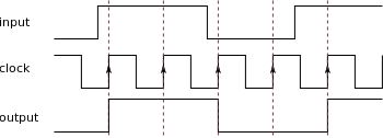

Hello guys,
Could you please explain me why the re-clocking must be done with a frequency at least twice higher that the one feed to the BBB?
What is the advantage to use 1:2 divider instead of 1:1 ?
Thank you !
The reclocking is done on each rising egde from the master clock (when going from 0 to 1)
So you need 2 rising edges to map the 0 and 1 of the fastest bitclock.
(Or 4 on this exemple)

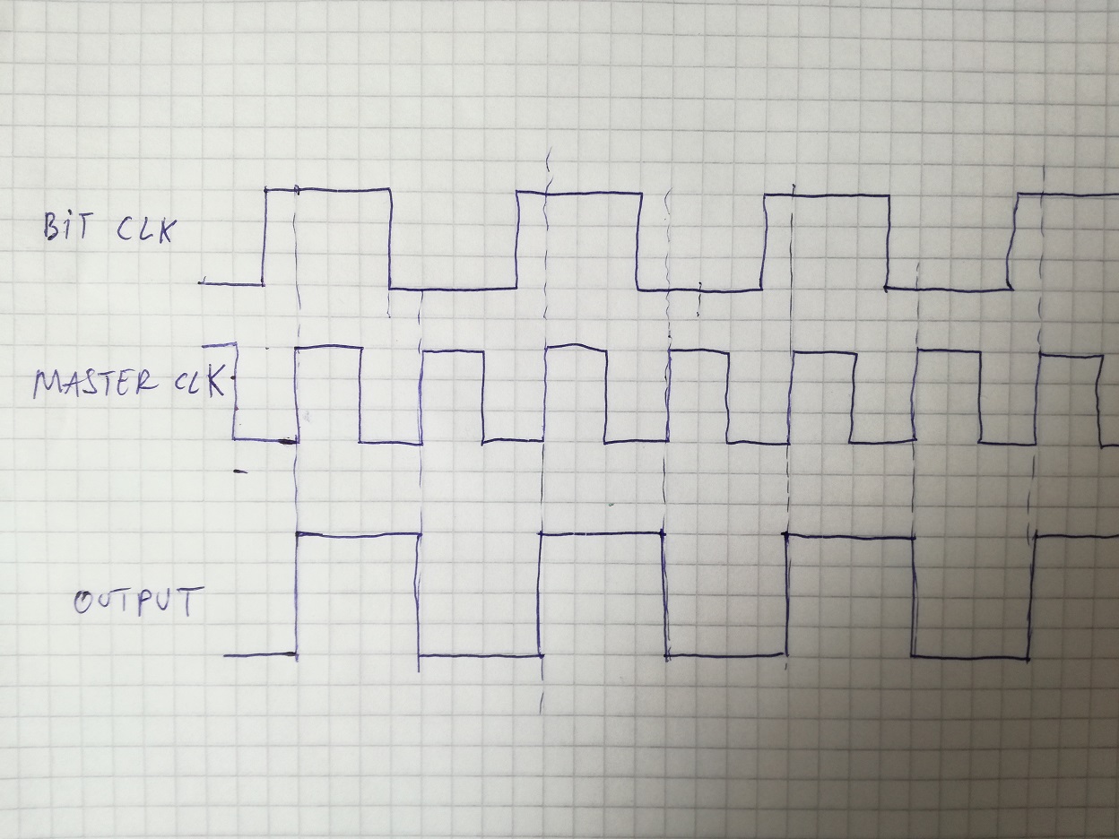

So let me know if I understand right: because the bit clock is delayed compared to the master clock (it will travel through the BBB in my case and then to the Cronus) the flip flop will miss the rising edge of the first high master clock and only be trigger on the next high master clock - from here it appears the half period delay that miero talked about?
If this is right then using a 2X master clock freq the signals will still be delayed compared to the original one but if they all pass through the flip flop they all be sinq and the audio quality will not be damage at all from the delay?
I drew how the signals would be if the master clock is twice the fastest bit clock, the result is similar with the one from grael with four times fastest, so it will be no advantange to use 4x over 2x?
Thank you !

Yes - the whole purpose of the FF is to finally (at the output of the cronus) time align all of the signals to the master clock. That is the actual master clock - not a divided clock.
The source it self may be synced to an isolated version of the master clock (which will not be exactly in phase) either 1:1 or divided 1:2 or 1:4.
The net result is - all combined phase errors (source + isolation) are ultimately eliminated by the FF. When time aligning a signal to a master clock using a FF the maximum input rate of the signal can only be half the rate of the master clock. This is a rule for all FFs - it is not a case that is special to the Cronus.
Cheers!
