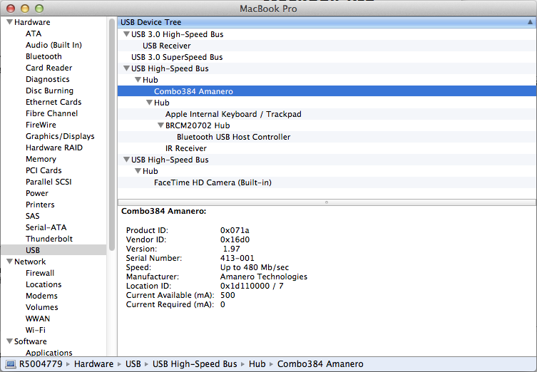

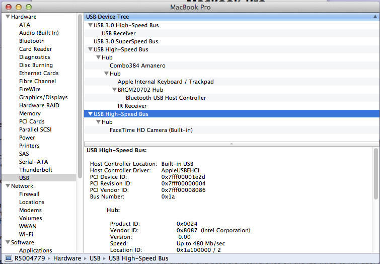

Regarding the basics: When it is silent does the USB bus see the Amanero? Click on the upper-left apple -> about this mac -> system report -> USB hardware. Of course you want it on a bus without other hardware. In system preferences -> sound, the USB output is chosen and not muted? Output volume via the keyboard is all the way up? Applications -> Utilities -> Audio MIDI setup is 2 channel & nothing wrong with other settings?
At first my Mac would not detect the Amanero. I had to go into the Settings to switch the output to it. !

@francolargo: yes, I checked my Mac and it recognizes the "Combo 384 Amanero" and shows it's version 1.97 among other things. USB output is chosen and Audio MIDI shows Combo 384 Amanero is 2CH 32 bits and the clock source is Combo 384 Amanero.
