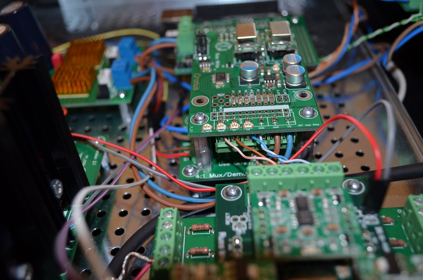

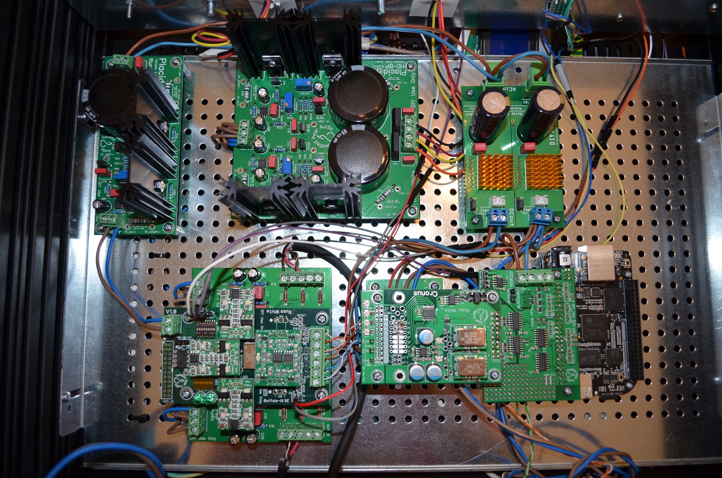

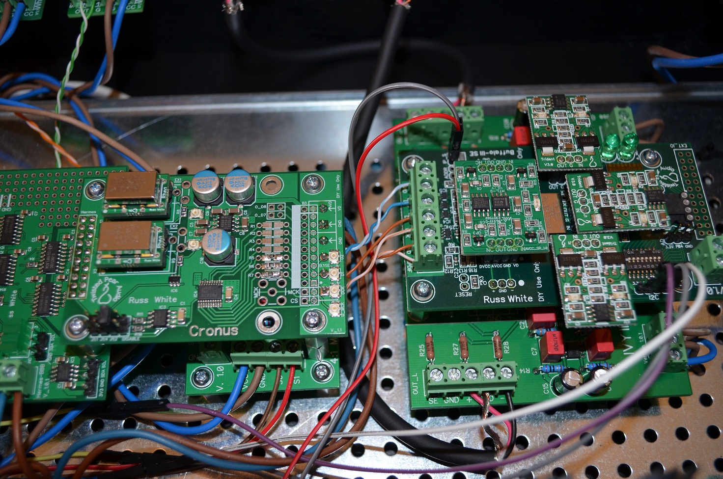

I'd love to see some close-up pictures of BIIISE coupled to Cronus from different angles. Can anyone do it, please?
Here are some pictures of my B3SE setup with Hermes/Cronus.
