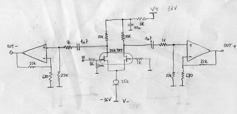

I suppose it really wouldn't cost too much to just breadboard Figure 51 and see how it works. But, I don't know what type of input transformer to get - 1:1, etc

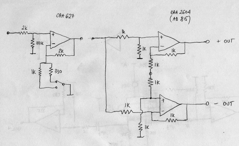

carlmart said:Why not first try the one in figure 52?
Doh!
Thanks for pointing out the obvious, Carlos. I honestly jumped past that schematic, entirely. The reason why is that the datasheet says: "the noise gain of the two op amps in this configuration will always be different by one, so the bandwidths will not match." And I lacked the experience to know if that was a major or minor problem.
Of course, now that you've pointed me in the right direction, I'll start with that basic 2-chip circuit, listen to it, get a feel for it's character and establish a baseline performance, then move to the other designs if necessary.

darkmoebius said:
The next big qustion is where to buy 4 of these chips?
You need only two of those chips, as the AD815 is dual. Try asking for some samples from BB/TI.
