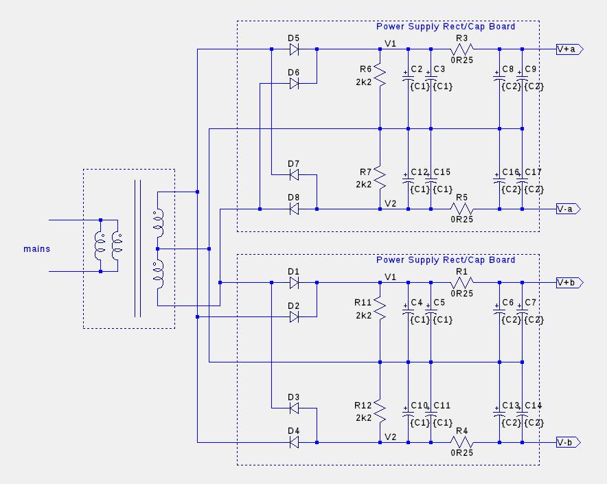

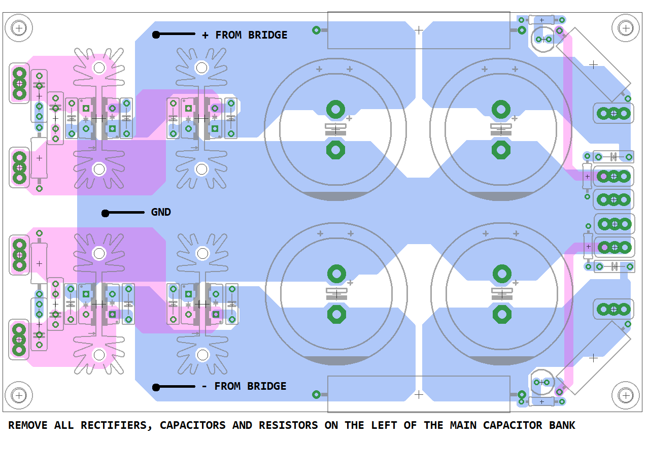

The problem is, ea PSU has two sets of Ac input with two complete full wave bridge recrifiers.
Solder them to the marked points after scratching the mask or solder on pads sharing the same traces. Also remove everything from the left of the cap bank.

You are saying to use an external single full wave bridge? Sort of defeats the purpose of the nice on board rectifiers
Quite right.
...but then I guess you are saying that this topology will allow dual PSU's from a single trafo and not have ground loop hum?

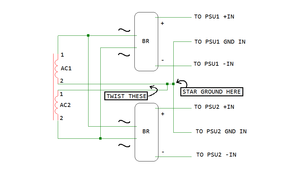

I faced the same issue a couple years ago and this solution has been working for me since. A thick wire from the center tap connected to a solid star ground made at least 6" far from transformer. Both PSU's ground input (shown in my last attachment) taken from star ground. Amp GND taken from star. Speaker return directly to capacitor bank GND (not to star).
For center tapped transformer its easy to implement. For a dual secondary transformer AC1's second wire and AC2's first wire (anti-phase) is soldered to make the center tap. To find the anti-phase wires, join any two wires from the two secondaries and measure AC at the open wires. If 2X secondary voltage is shown then its right and the joint can be used as a center tap, if very low or no AC voltage is shown then its wrong; just open the joint and replace any one of the two wires with the other wire of its respective secondary.
Other than in a full dual mono setup, a loop is bound to occur as long as the RCA grounds get in touch at the source. And in that case it is best to keep the loop far from transformer so that the hum is as low as possible (that's why the star better be far). A loop breaker in its default application is used to break the loop created by the mains earth. For loops created inside the cabinet exclusively in the ground node by using a shared transformer our usual breakers will not be of much help, and IME input ground lift networks have routinely failed to lower hum in this case.
The main difference between the original design and my proposal as in reply to manniraj's post is that in the original design the ground reference is created after rectification by stacking rectifier outputs and I proposed to have it before. Hence the center tap and the off-board bridge modules, because, the same can not be implemented with the on board rectifiers.

It's as I posted earlier in the two attached pics. The "TO PSU1/2 GND IN" outputs from the first picture connects to the trace marked "GND" in the second picture. Precautions are are as posted in my last post. A thick wire from the center tap connected to a solid star ground made at least 6" far from transformer. Both PSU's ground input taken from star ground. Amp GND taken from star (not from PSU). Speaker return directly to PSU capacitor bank GND output (not to star). I hope it works for you too.

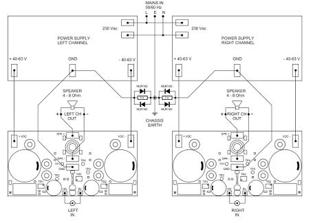

Planning to implement following way to solve the home ground issue, hopefully it should solve

You don't need a star ground in a full dual mono setup. The two channels' grounds should not be allowed to come into direct contact except at the far end of the RCA input connectors.
Are you using loop breakers to connect the PSU grounds to chassis? You need two of them.
https://encrypted-tbn3.gstatic.com/...2pBGfUKZ0eoID6i_MGi6pNHX6VZCXrZdwS9BlMYZYnRDA
As stated above I will be using the 2 loop breaker and have to check
When checked earlier with others, they suggested to use star grounding and spent so much time in solving the issue.

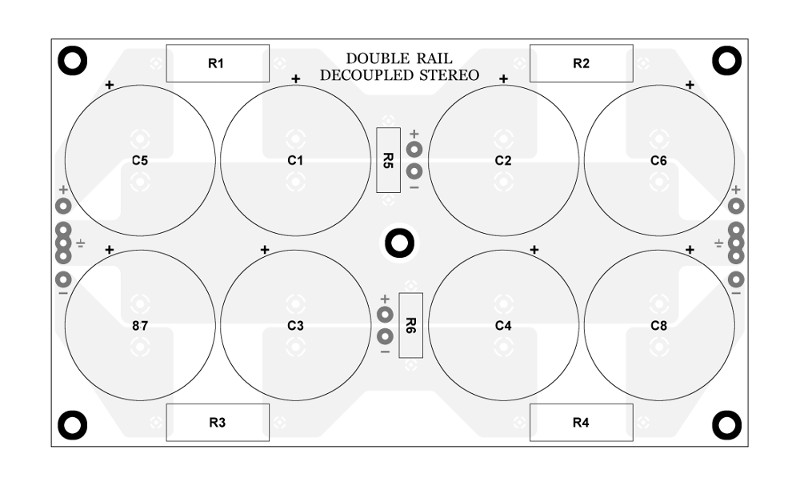

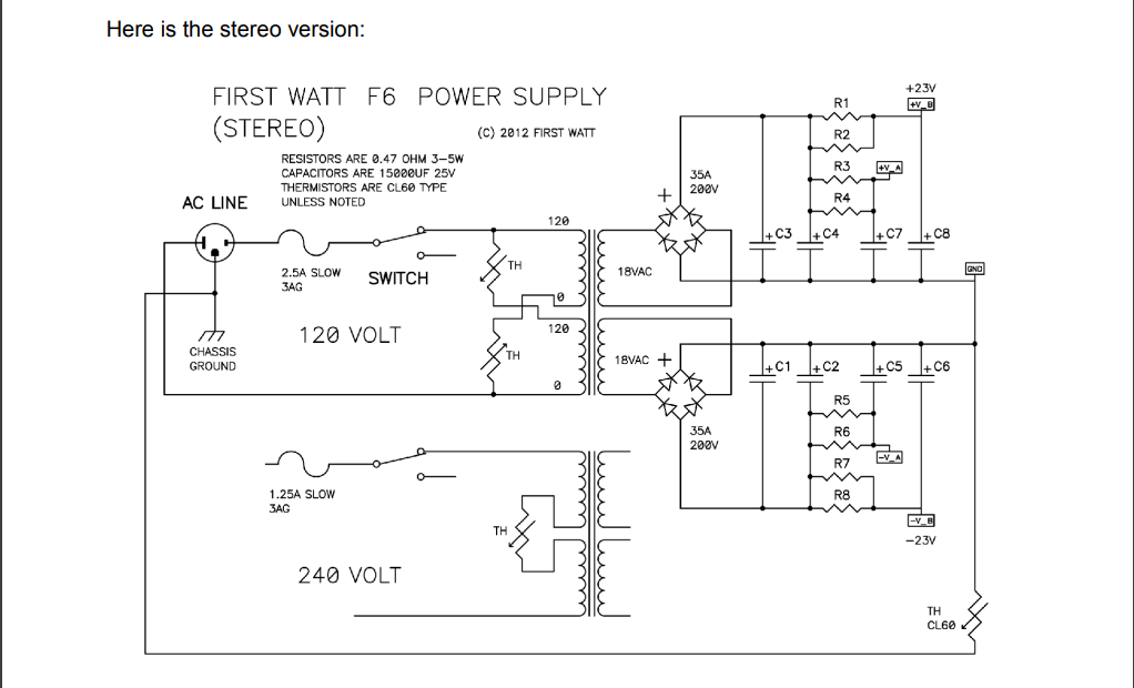

I'm planning a dual-rail PSU with CRC filtering, with the RC decoupled for left and right channels.
Please see attached schematic and board.
I was fairly confident in this design until reading this thread. :eek:
Does it look reasonable?

Founder of XSA-Labs
Joined 2012
attachment.php
That's the standard FW PSU. It's not dual mono. It's shared positive and negative rails from one dual rail PSU. Even though dual cap banks are used, the upper four is for +24v and the lower four is for -24v rail. It does use an independent 15mF cap for each amp as the final smoothing cap though for better stereo separation.

Interesting. I thought I had seen all the Firstwatt PSU designs, but that one's a little different (and pretty much exactly the same as what I've drawn). It should work, then. :D
Jeff.
[Edit: Cross-posted before that last message. I think that second schematic is the one people were having trouble with regarding hum and/or buzzing, no?]
