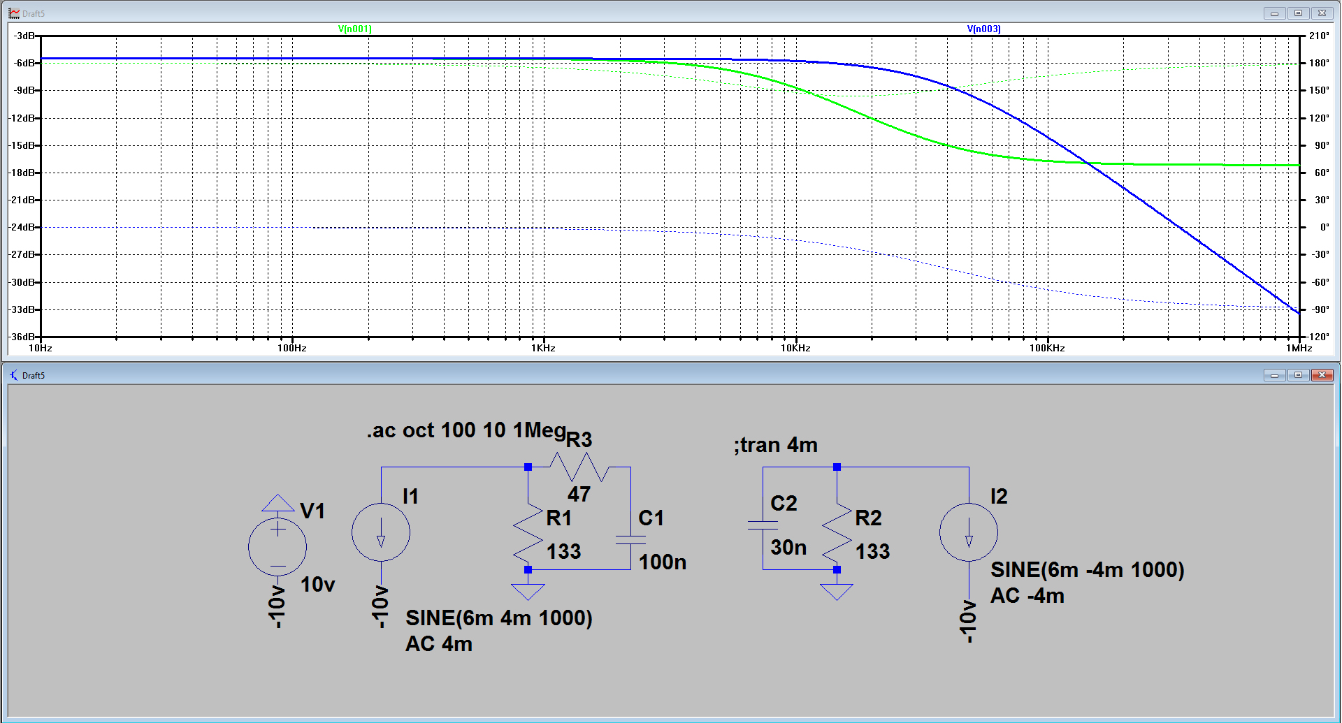

You placed a 10nf cap on the output and reported it had no effect.
Are you sure it was placed correctly, I find it a bit hard to believe that it had no effect at all.
But to convince you, I simulated a 30nF cap on the output of your DAC and also a 47Ohm with 100nF, assuming that your output resistance is 133Ohm.
The big difference is that the single cap keeps on attenuating wit 6dB/oct and that the RC combination stops at 100kHz. So having an extra resistor in line is not a good idea.
The 30nF that I used attenuates only 0.5 dB at 20kHz, while 47Ohm / 100nF attenuates 5,5dB at 20Khz, way too much.
So when using a filter, the maximum you should use are two 30nF from each output to Gnd or a single 60nF between the two outputs.
I had it soldered directly to the output of the DAC board; so yes, I think it was placed correctly. It did not have any effect on the distortion effect. I have tested this only at 400 Hz, and I haven't checked for changes in the frequency response roll off towards the treble or similar things, as I didn't think of this as a "final solution", but rather as a test for finding the source of the problem.
The output resistance is 2 x 34 Ohm from pos/neg outputs to GND (see my first post).
Why would the simulated RC filter stop at some point?

When you have a 34 Ohm output, that probably means that you have 4 Dac's in parallel, I can't find this information in your first post.
But it actually means that you should have used at least 4 times the amount of 10nF (polystyrene) caps , and not a the output going to the TVC, but as close as possible to the various PCM1794 DAC's, because that's where the spikes are generated.
I do not know the layout of your PCB, but try to go as close as practically possible to Iout A+ (A pos) and Iout A- (A neg) as possible with a 10nF caps, the other side connected to ground.
Going to ground is better because, although the audio signals are of opposite polarity, we don't know whether the spikes coming from the outputs are in phase or out of phase.
Placing a cap too far away, leads to a complete failure to suppress spikes.

Parenthetical -- L2 and L4 on the LB80ABDT (low dropout 8V regulators) essentially render the regulatory scheme less than useful. The designer put a complex impedance on the output. Remember that the output capacitor on a low-dropout regulator is in the control loop!
C_out should be a minimum of 2uF as ST recommends, and placed as close as possible to the regulator.
btw, what are the rail voltage on the filter opamp?
