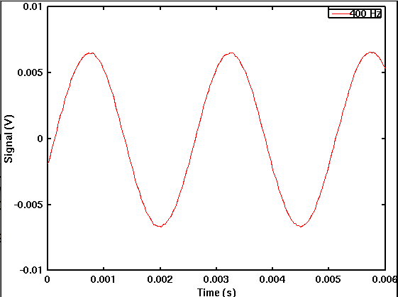

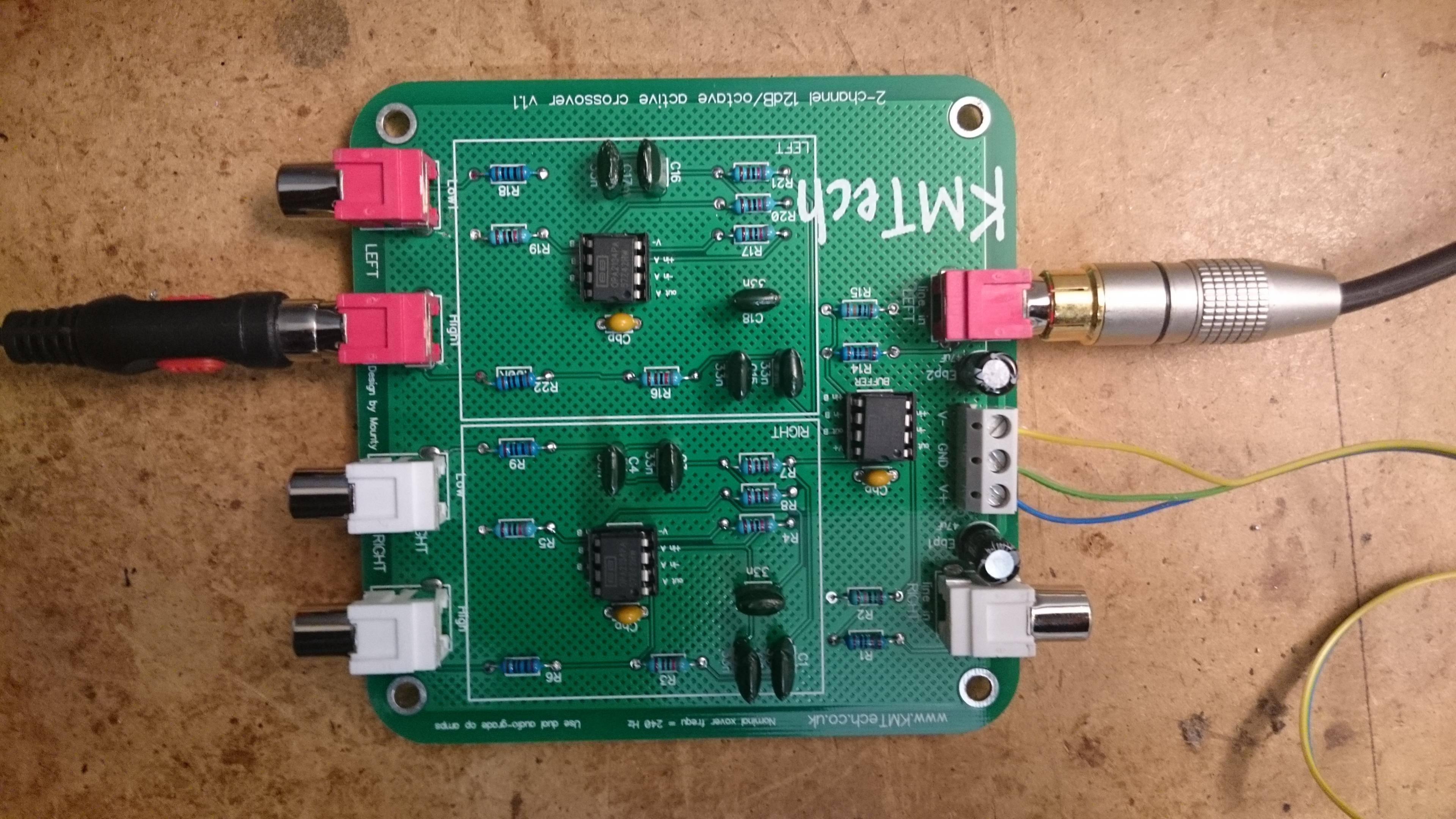

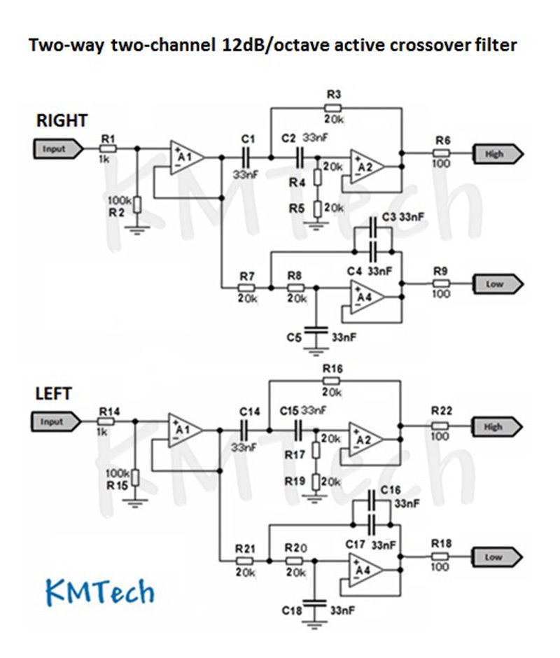

While I was off to get my hip dent lifted (or something like that) I got a delivery of a KMTech filter board. This filter board works with a bunch of OPA2134 FET input opamps (schematic and photo attached, note that the 20k resistors shown in the schematic are 6k2 on my board). I hooked up the KMTech filter instead of the existing ABACUS filter and got the attached signal at the output. Looks good to me! And I am happy to know it is possible to make the whole setup work with the TVC the way I intended at the beginning.
Just to see if the FET input makes all the difference, I installed NE5532s instead of the OPA2134s on the KMTech board. This gave a tiny hint of small pips in the output sine signal, but nowhere as bad as with the ABACUS board. So while the OPA2134 do make a difference, there are other things that are not right with the ABACUS. Apart from the OPA2134, the more obvious differences of the KMTech are smaller capacitor values and larger resistor values in the filter network; and the board itself is different, of course.

I did that. I used a 10k potentiometer to get to the same signal voltage as with my TVC tests, just so the data are comparable. The pips were gone.

So the observation is that the signal at the filter output is distorted with the TVC at the filter input, but is not distorted with the potentiometer in place of the TVC. This tells me that the filter interacts with the TVC in some way, and this upsets the opamp somehow. The key will be to remove the interaction between the TVC and the filter.

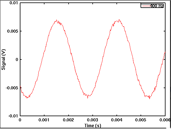

Aaargh, this got lost in my to do list. Just installed a T pad with 2 x 100 Ohms series and 3kOhm to GND (had these laying around on the workbench). The result is attached. Looking good! Still a bit shaky at the min/max, but maybe that's just noise.
Now what does all this mean? I am still tempted to think that the problem is not on the DAC side of the TVC, but rather on the filter side. What do you guys think?
The T-pad you used will not attenuate the signal very much, but it will isolate the filter from any extremes of impedance presented by the transformer. We still don't know whether the main problem is some sort of HF energy from the DAC, or instability in the filter prompted by a termination impedance it doesn't like. This latest result points towards the latter, but on its own is not conclusive.
