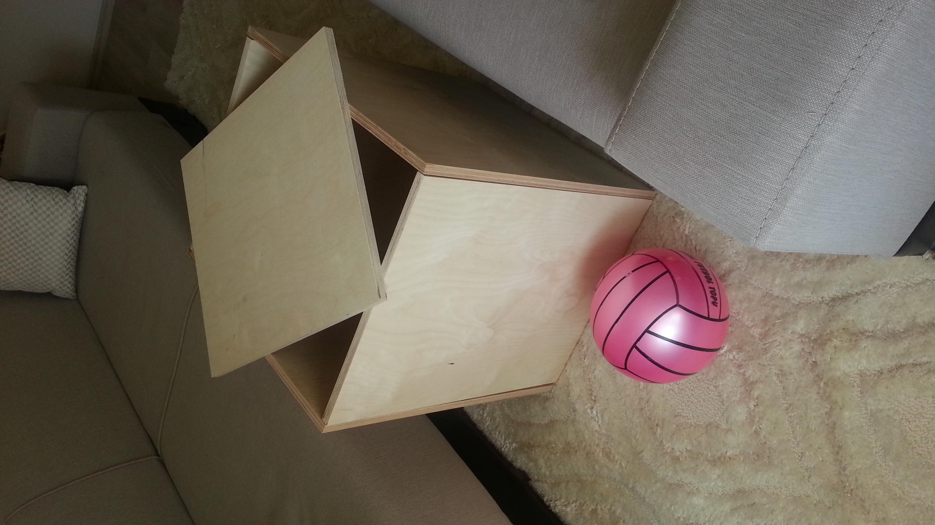

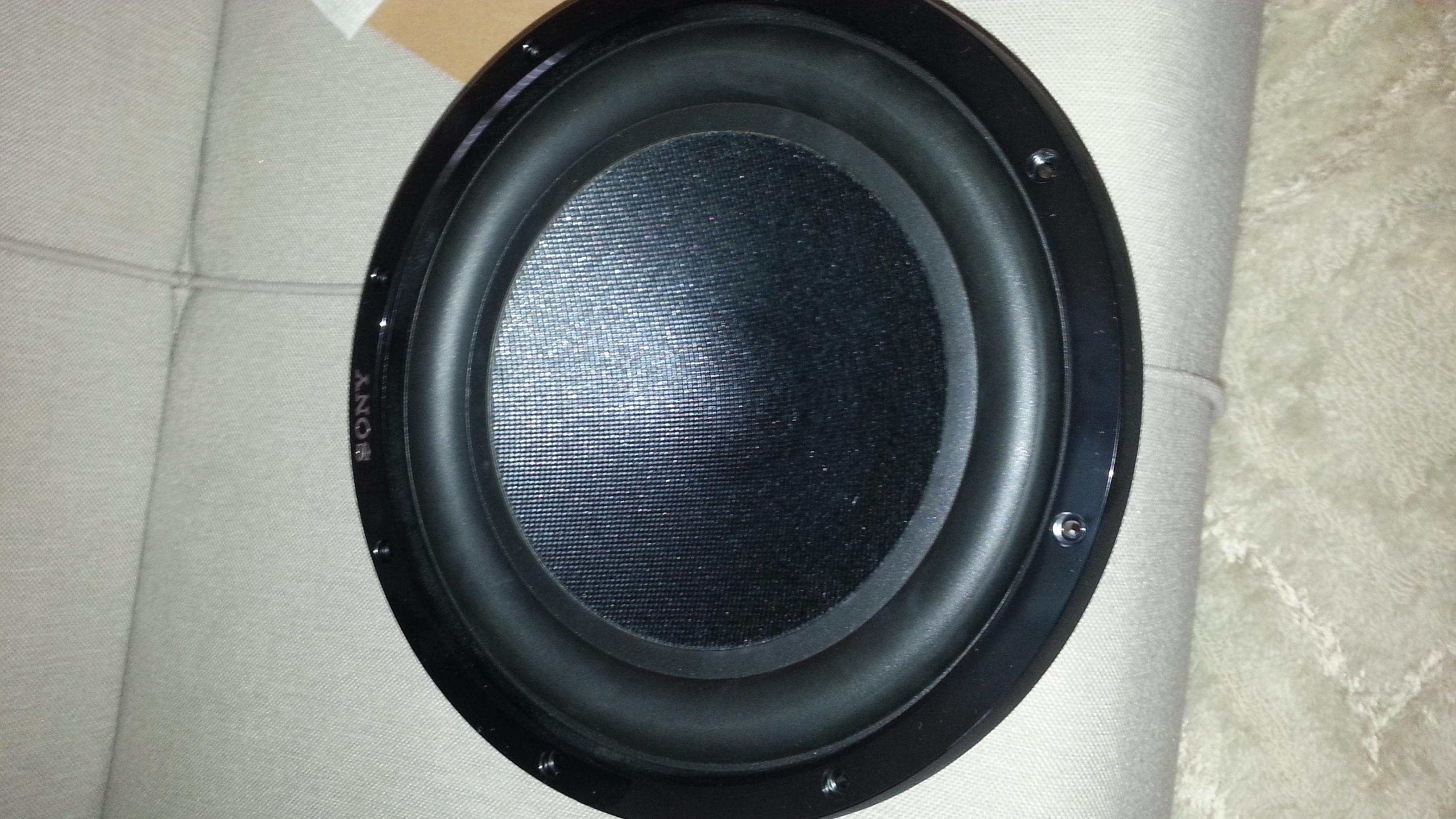

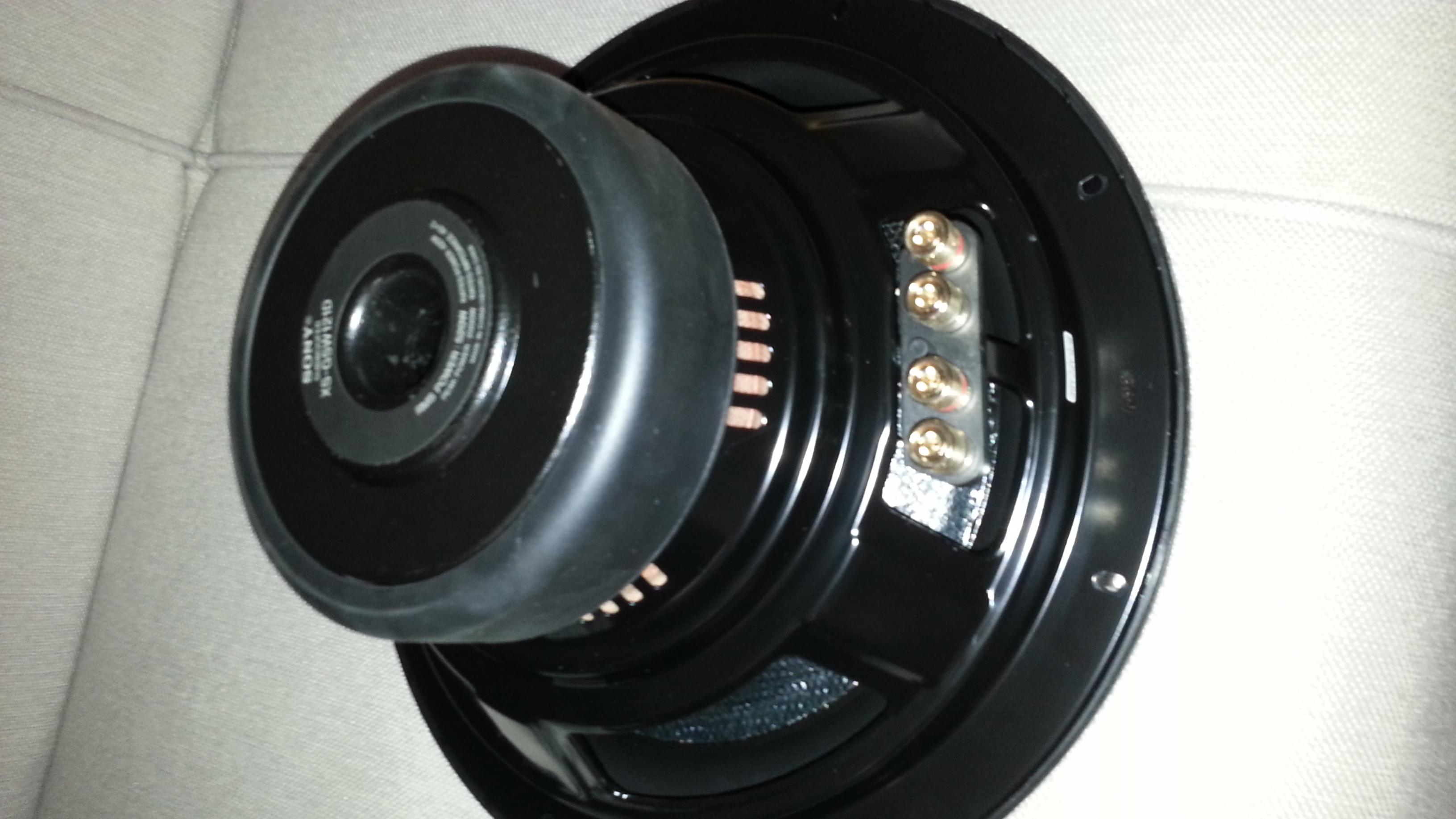

Sony XS gsw21d subwoofer sealed box bracing
Hi.I am building a subwoofer hor my home.Dimensions 56x53x52cm
Internal volume about 100lt
Birch plywood
But i forgot to cut internal brace from Bauhaus carpenter
I will cut another piece of 52x53cm of plywood or MDF
I read bracing holes shapes are important for air flow.(My box will be sealed though)
Should i cut 4 square or circle or elyptical pieces from big sheet? Thanks
Here pictures

Might as well add my late 2-cents too.
Thread has a lot of wise woodworking guidance but seems to be short on mechanical engineering posts. So here are my intuitions.
The enemy is large expanses of unbraced wall. Even quite thick materials will "drum head" if the expanse is large enough in a sub.
Adding smart structural bracing is far superior to increasing wall thickness. What you want is bracing across the box to an opposite side. The simple cross-forces involved in that kind of tensile strength hardly justify fussing with dado and fancy routing, so long as you aren't splitting the "end grain" or obvious defective work like that. Needless to say, compressive forces in bracing to opposite sides is a non-issue.
Even just an old broom handle, dowel rod, or length of electrical conduit pipe stuck across the middle and held in place with a lump of epoxy works nicely if the work is done properly.
Don't forget to make the front panel strong too. Has that big hole for driver, eh.
Taking a quarter-inch from the wall thickness will lower the box resonance for the same outside envelope.
Finally, we all believe great stiffness is important. But I'd be glad to read a link to any research on just how stiff it needs to be.... anyway, I actually think leaky sealed boxes are a good idea or maybe well stuffed open-back boxes. Try that in your sim program.

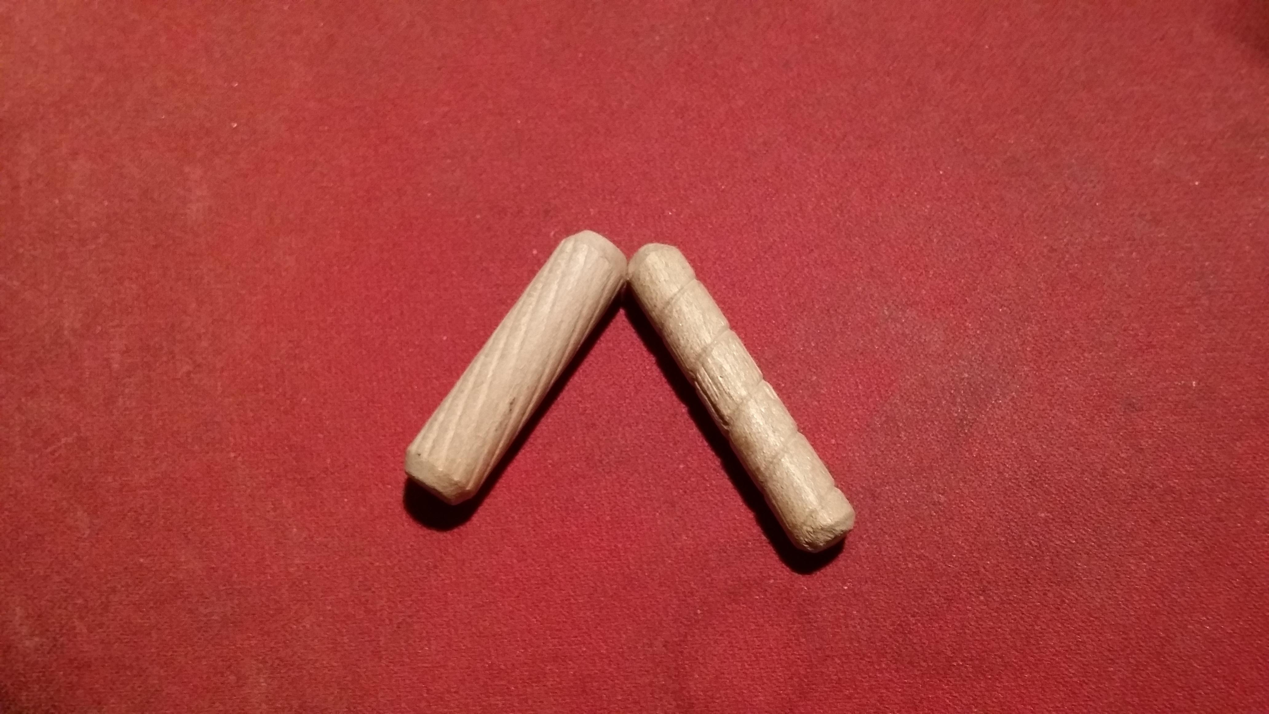

If you're having a bad time with screws try using these wood pin type things. Drill out matching holes on both pieces of wood and put glue in the holes before inserting these.
Use titebond wood glue or PL construction adhesive.
